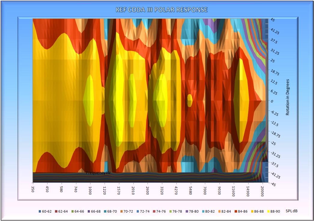

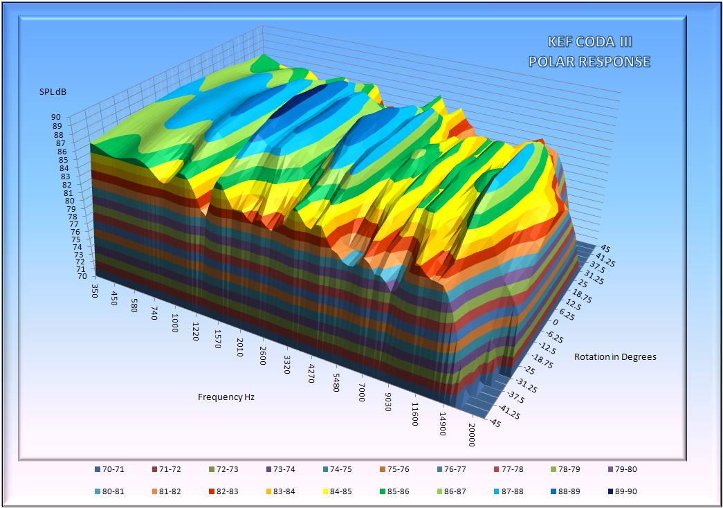

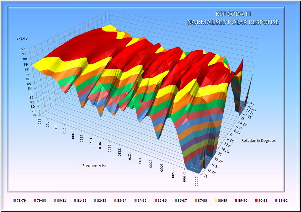

Inspired by Earl's graphics I decided to see if those of us who don't have access to expensive softare could format up data in excel to present polar responses in a more meaningful way.
Below are my current graphs. I will not pretend it is easy to creat these but it is possible.
So what does the graph tell us, well probably that the CODA III was not KEF's finest hour; but hopefully you can see how the polar response vairies accross the band. (I used the CODA III as I happend to have the measurements available as I working on an old pair and it is old enough that no one is likely to complain about me displaying it )
Andrew
Andrew
