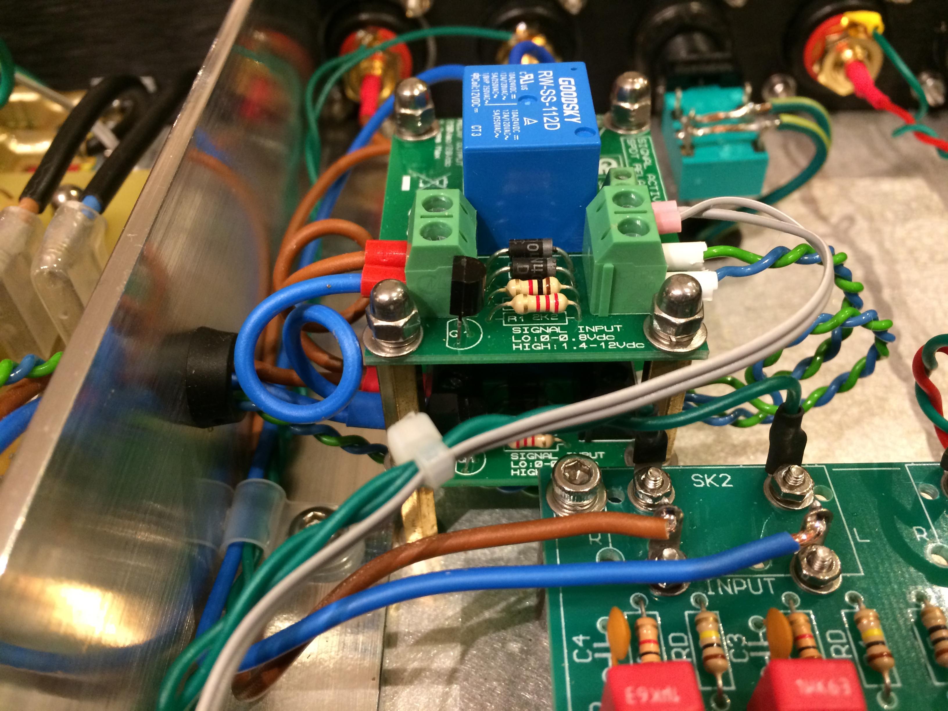

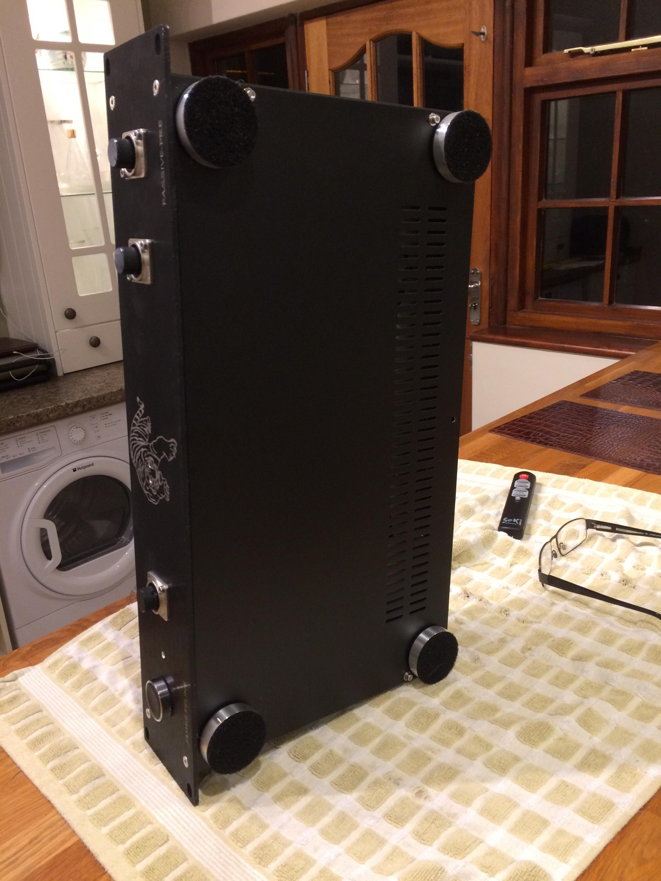

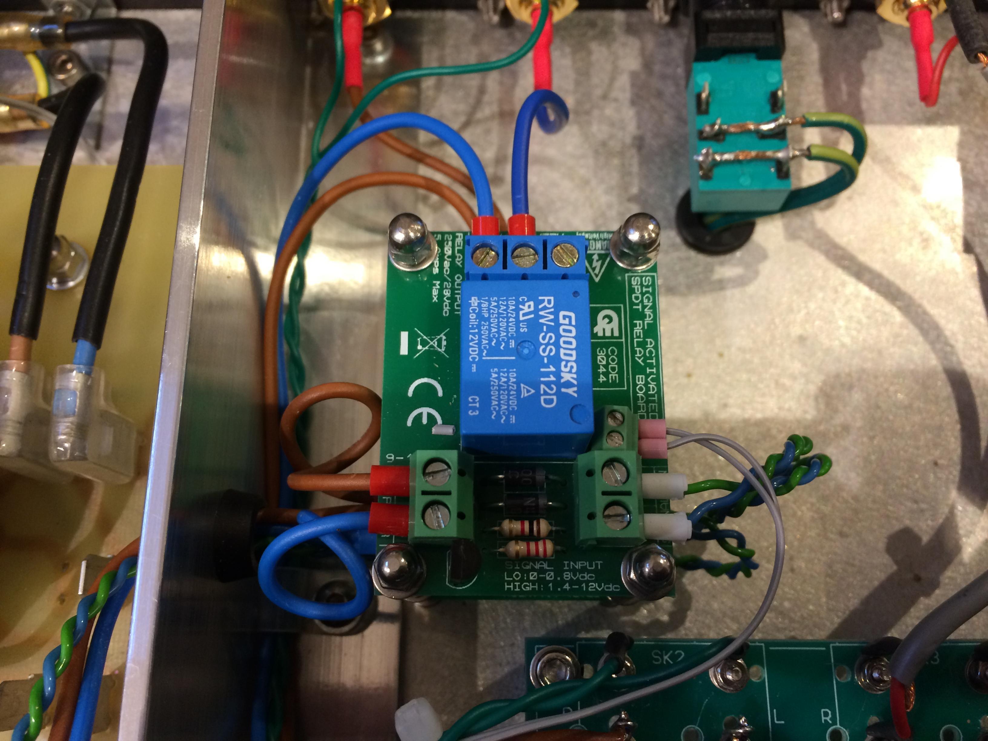

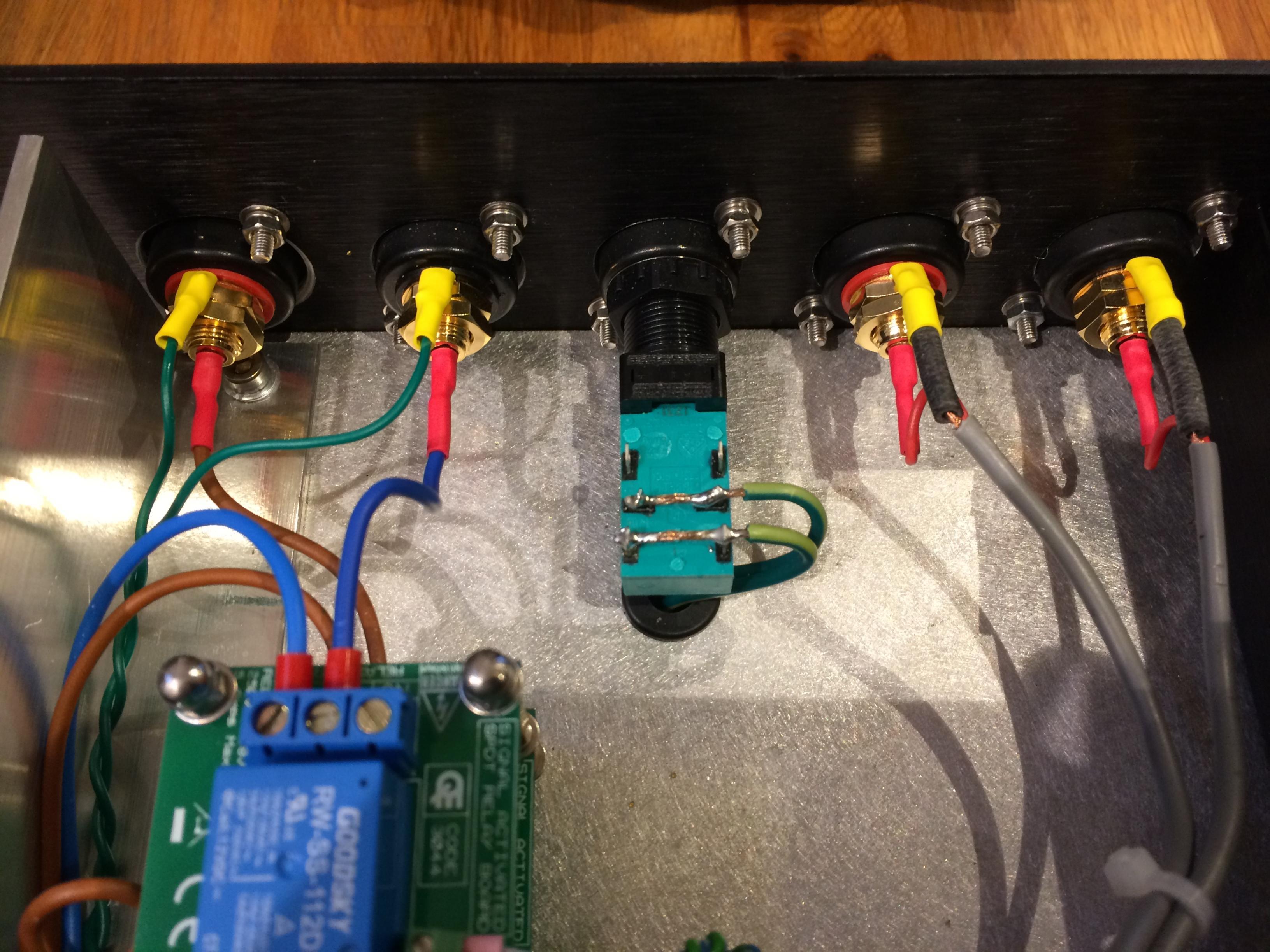

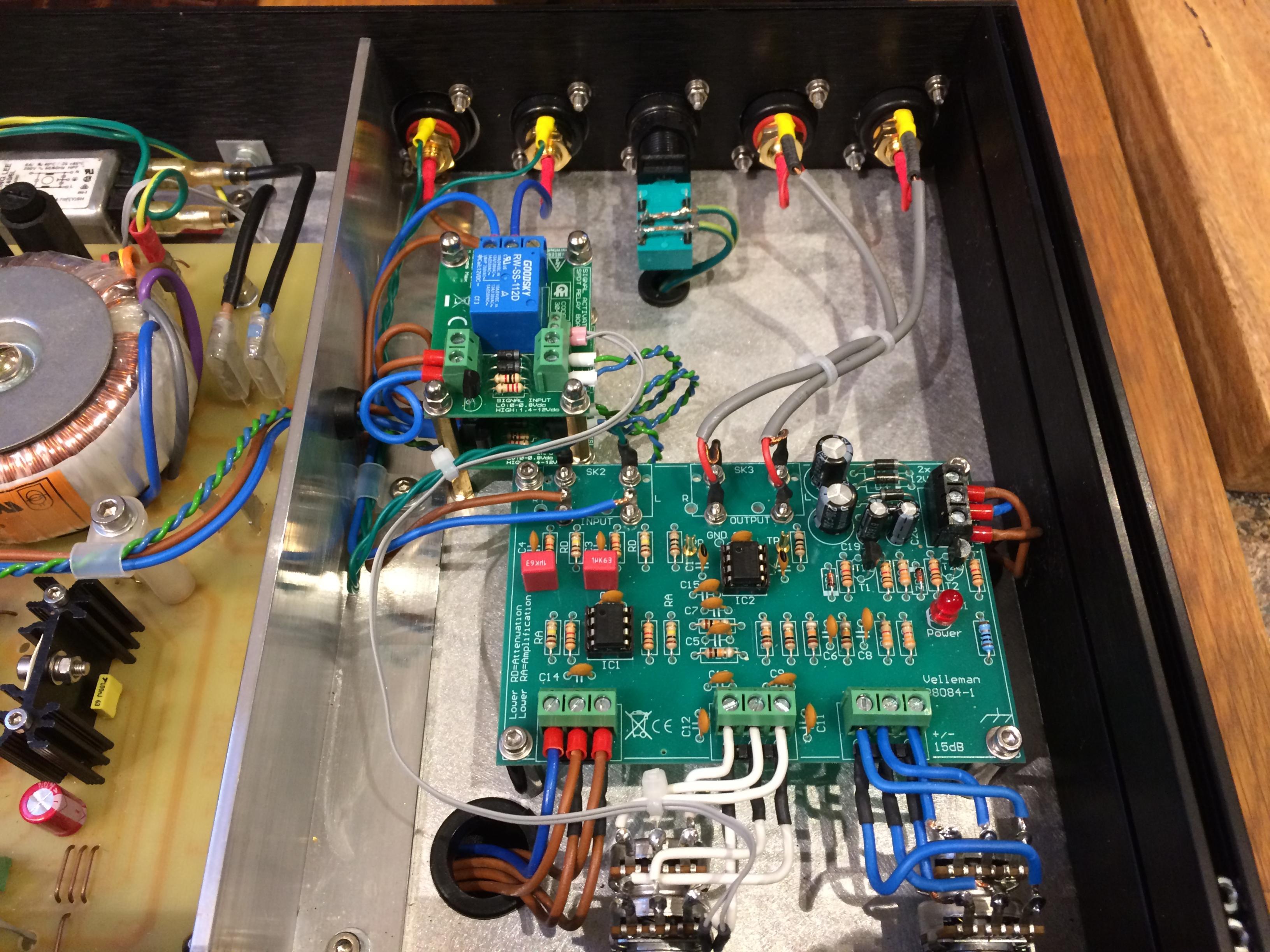

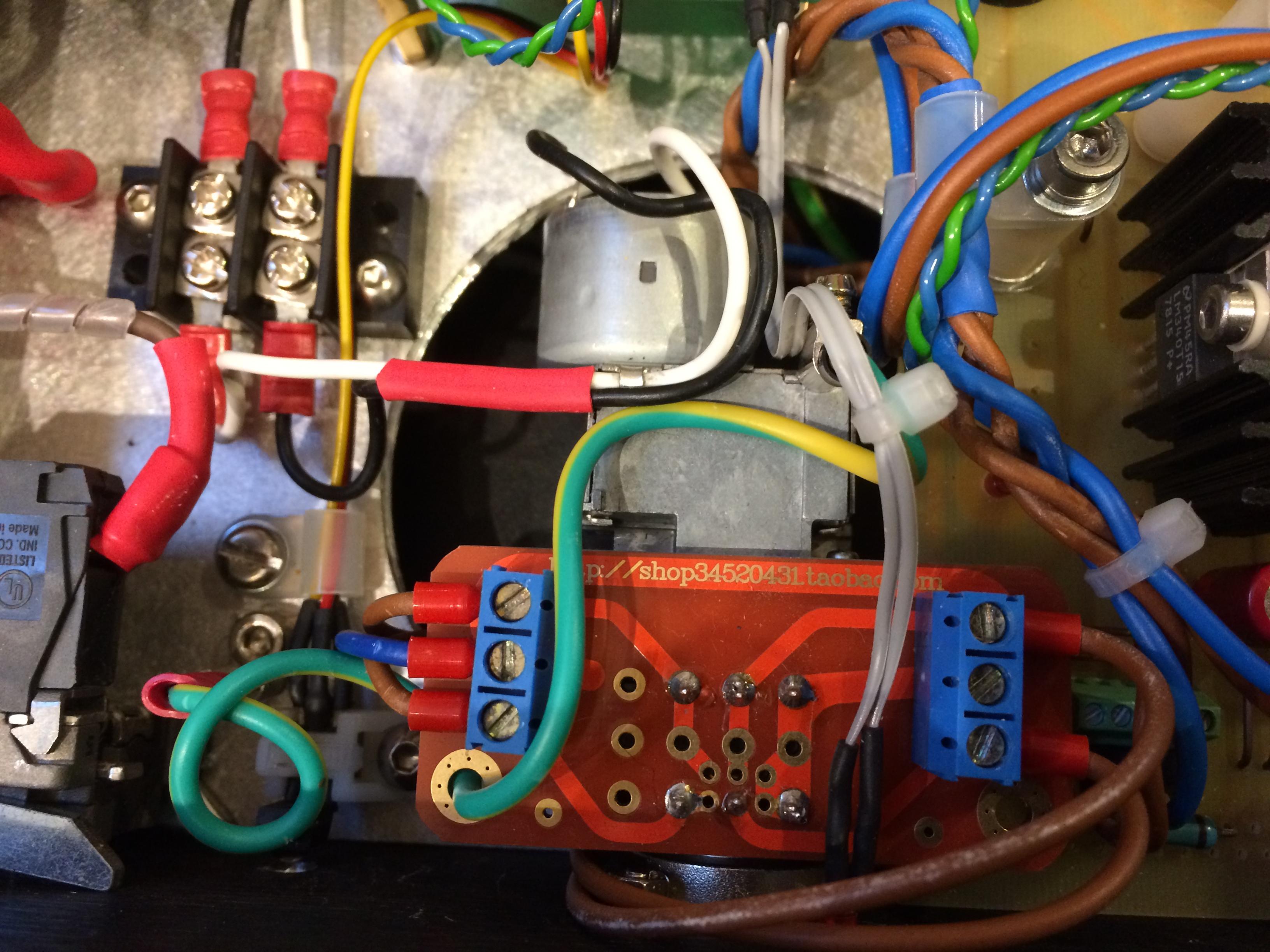

more final pics .. some thoughts & changes

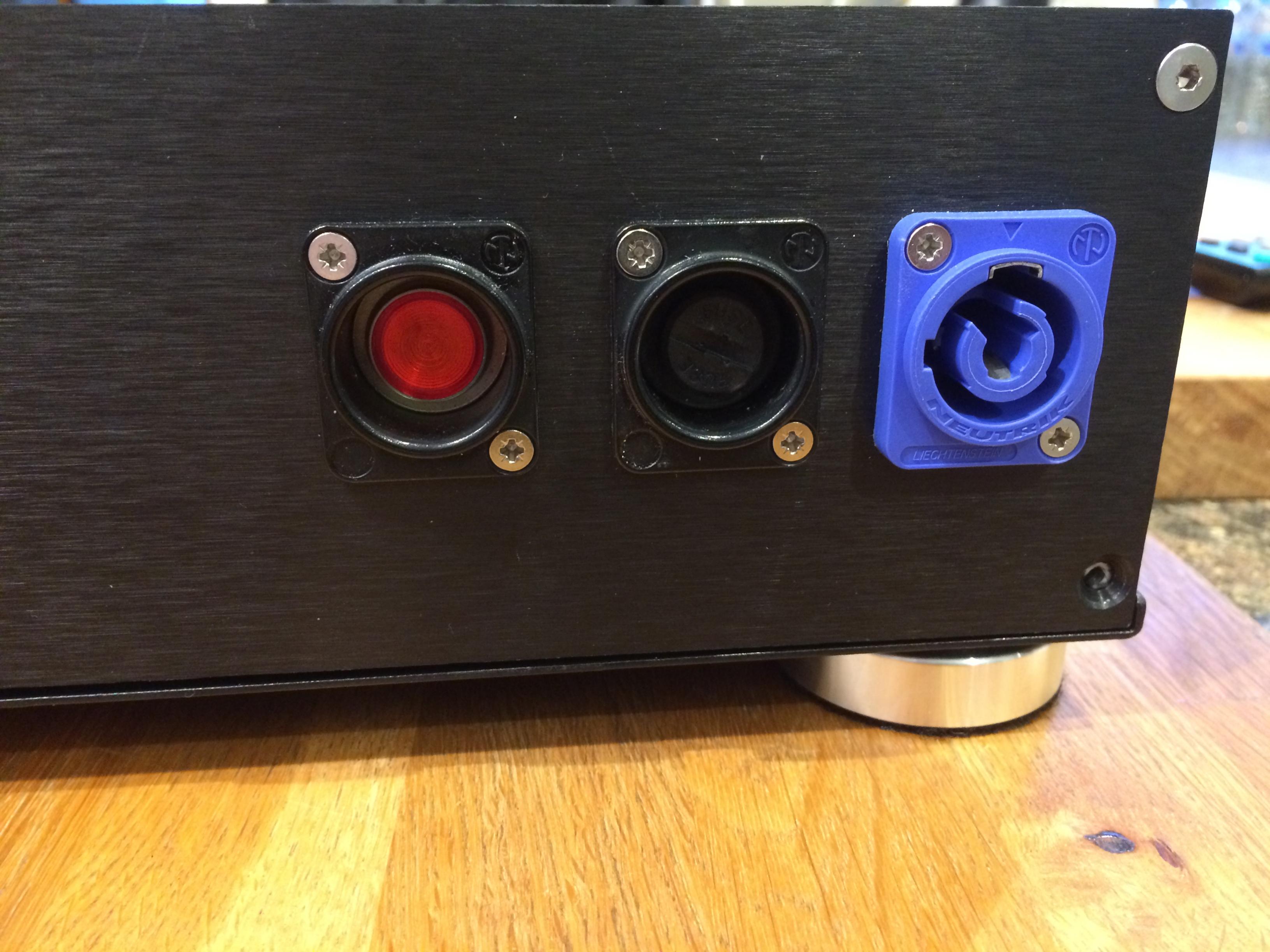

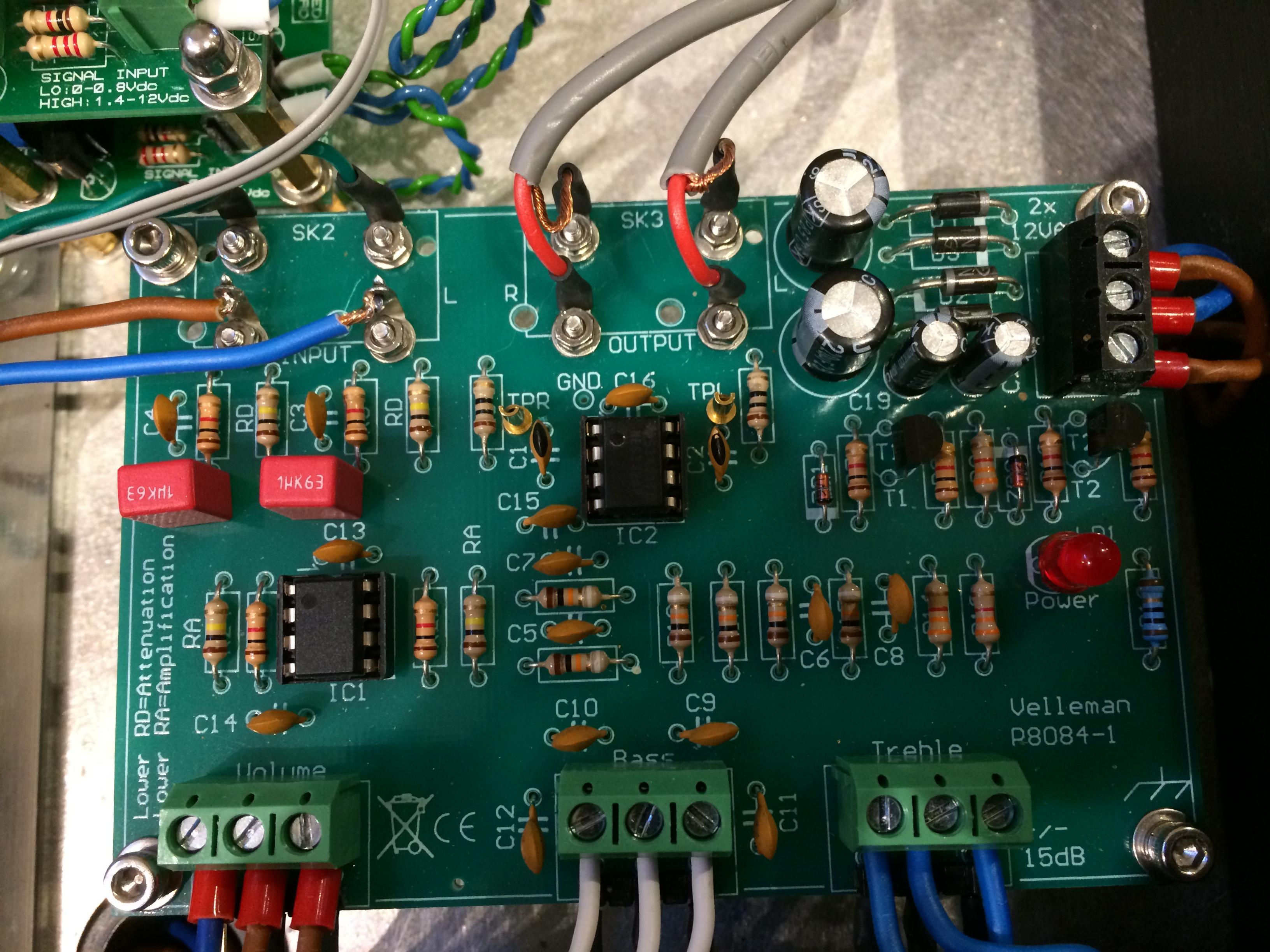

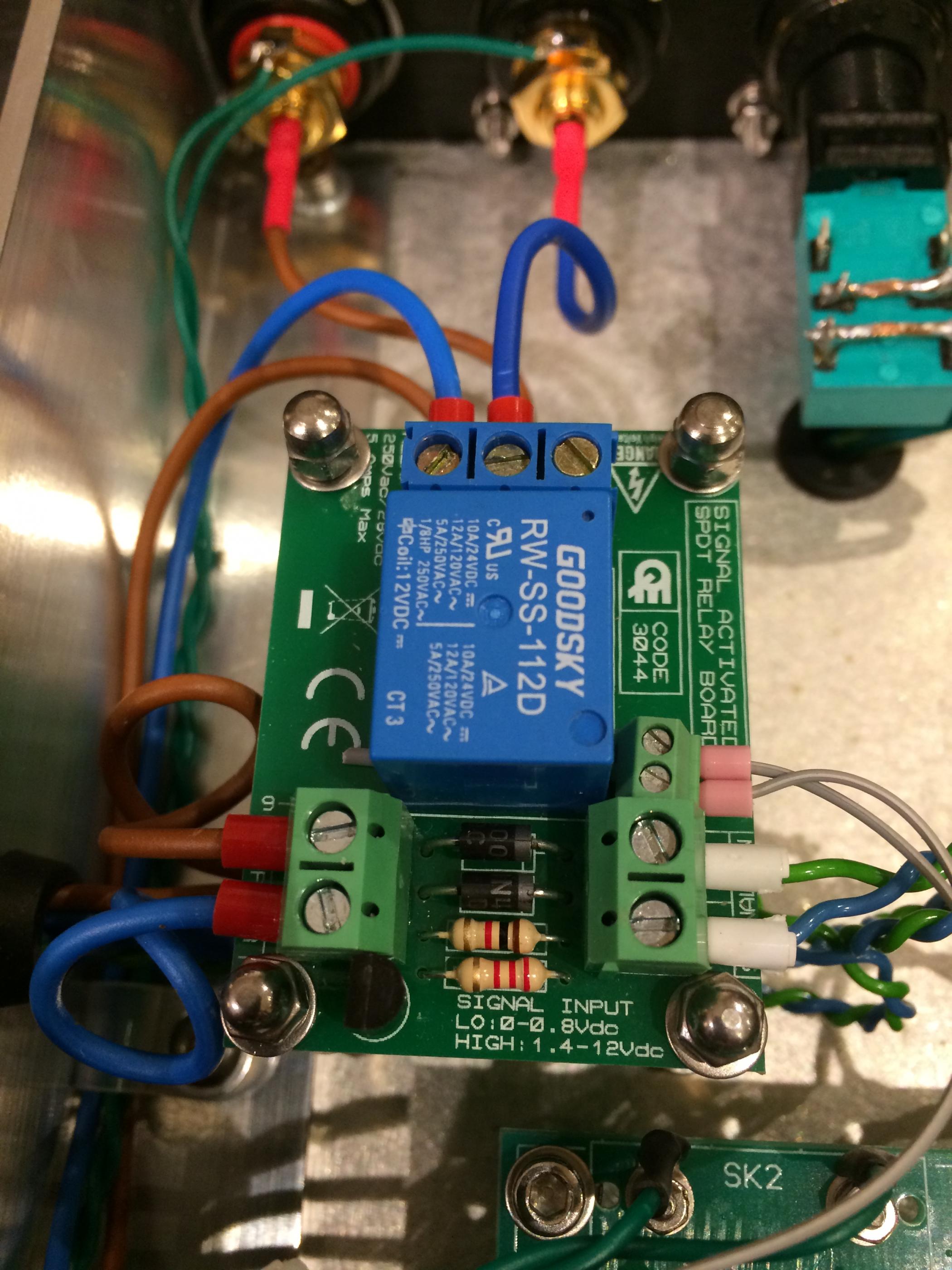

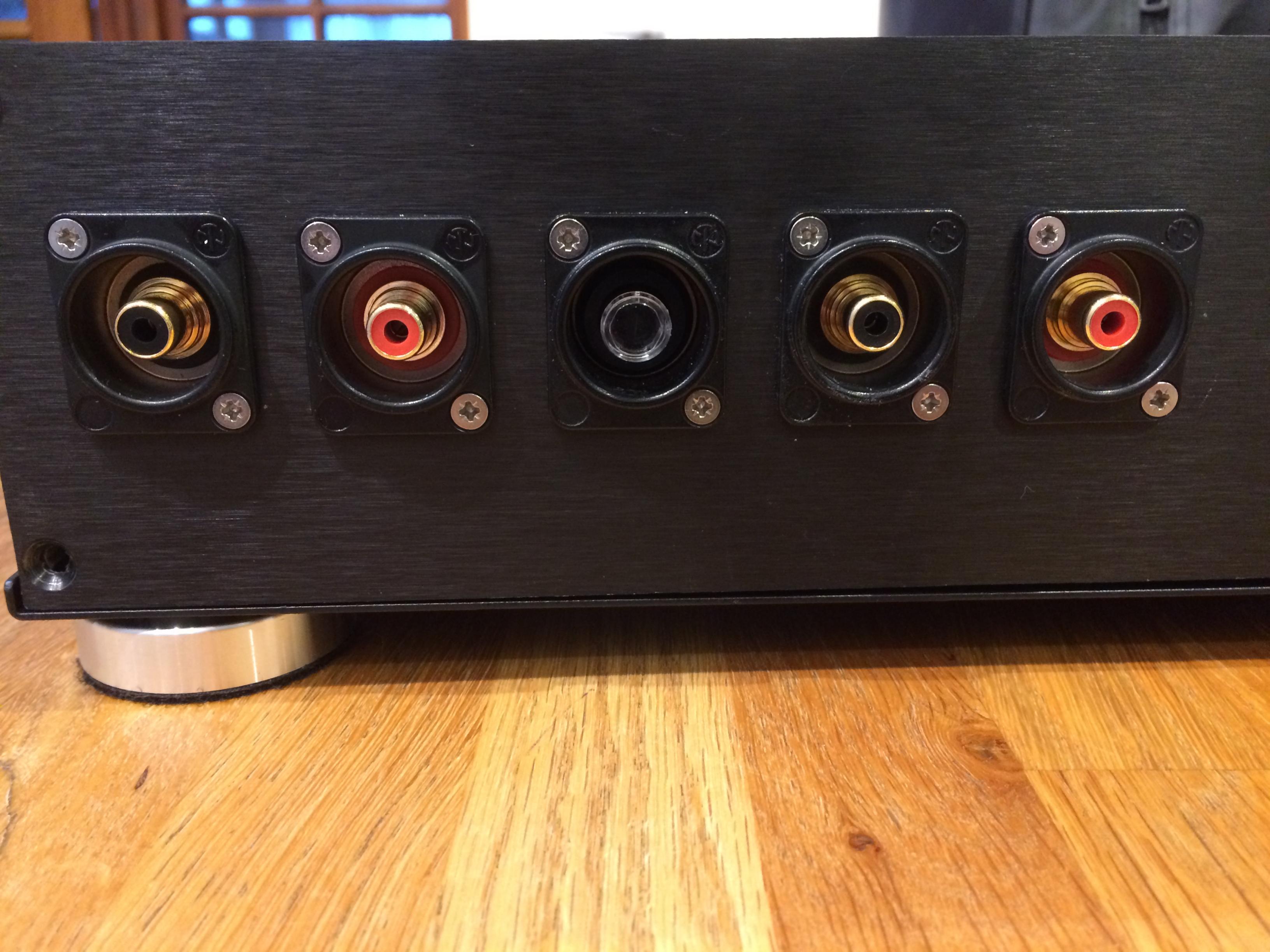

1. I have changed the output wiring to screened cables
2. have attached a few pics of the rear .. to include power connections
3. Not happy with the pot cable connections next time will use screen cable to reduce noise
4. Will make a seperate power supply for the remote volume control to reduce interference
any way folks until the next preamp amp build that's it ...
very best regards

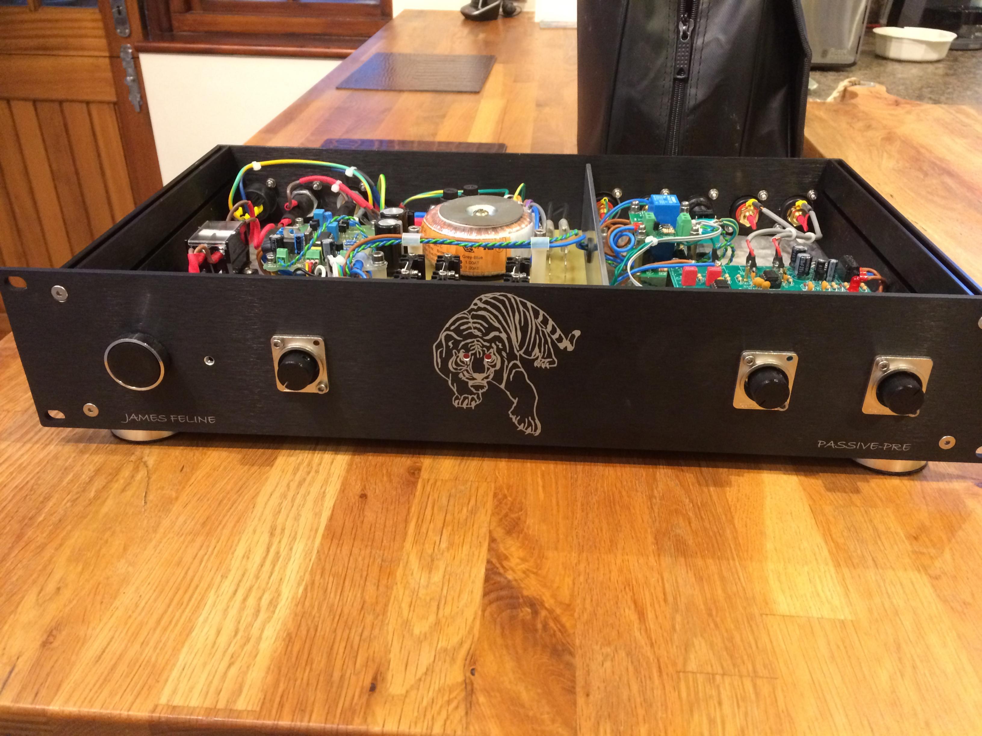

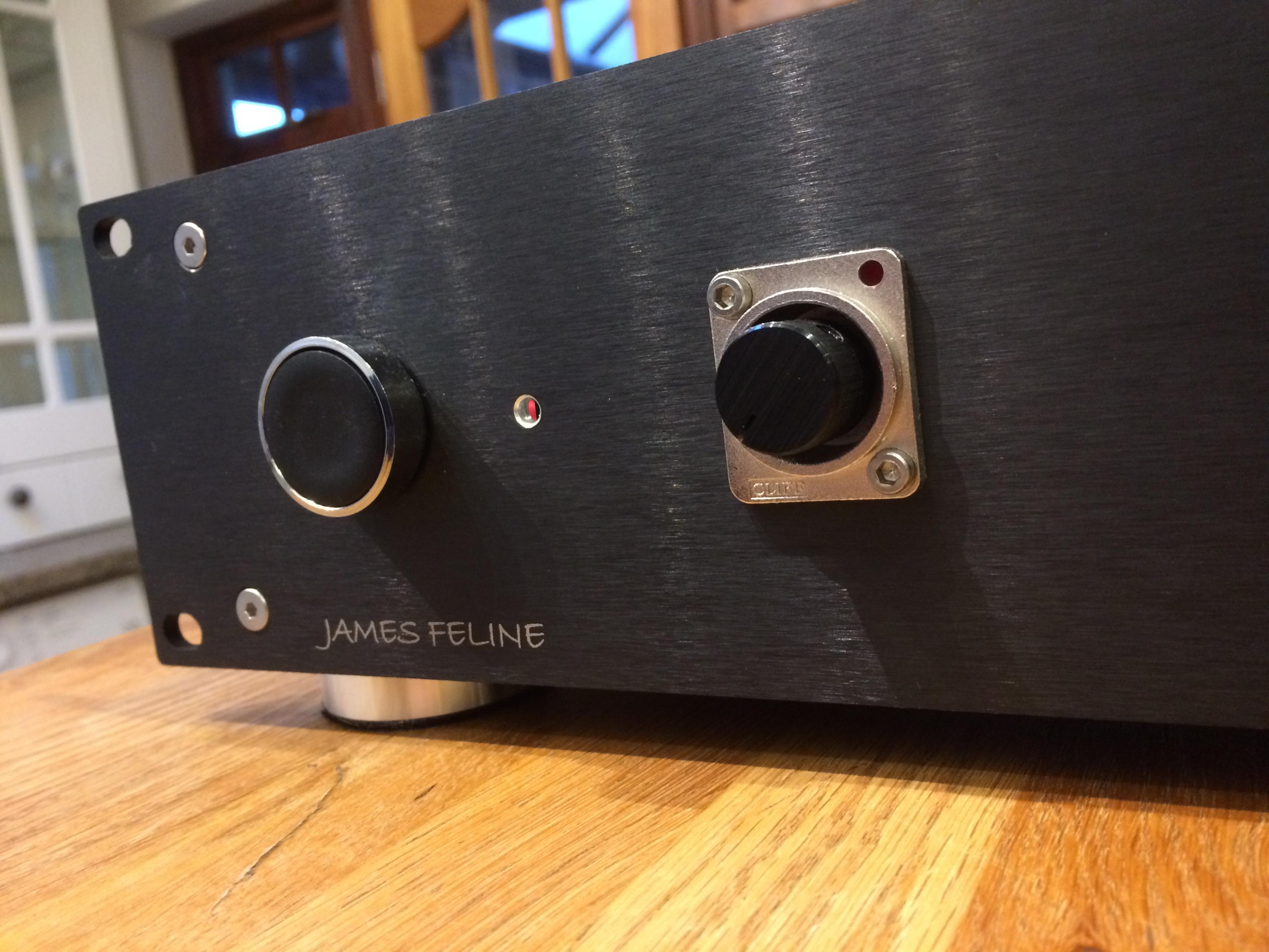

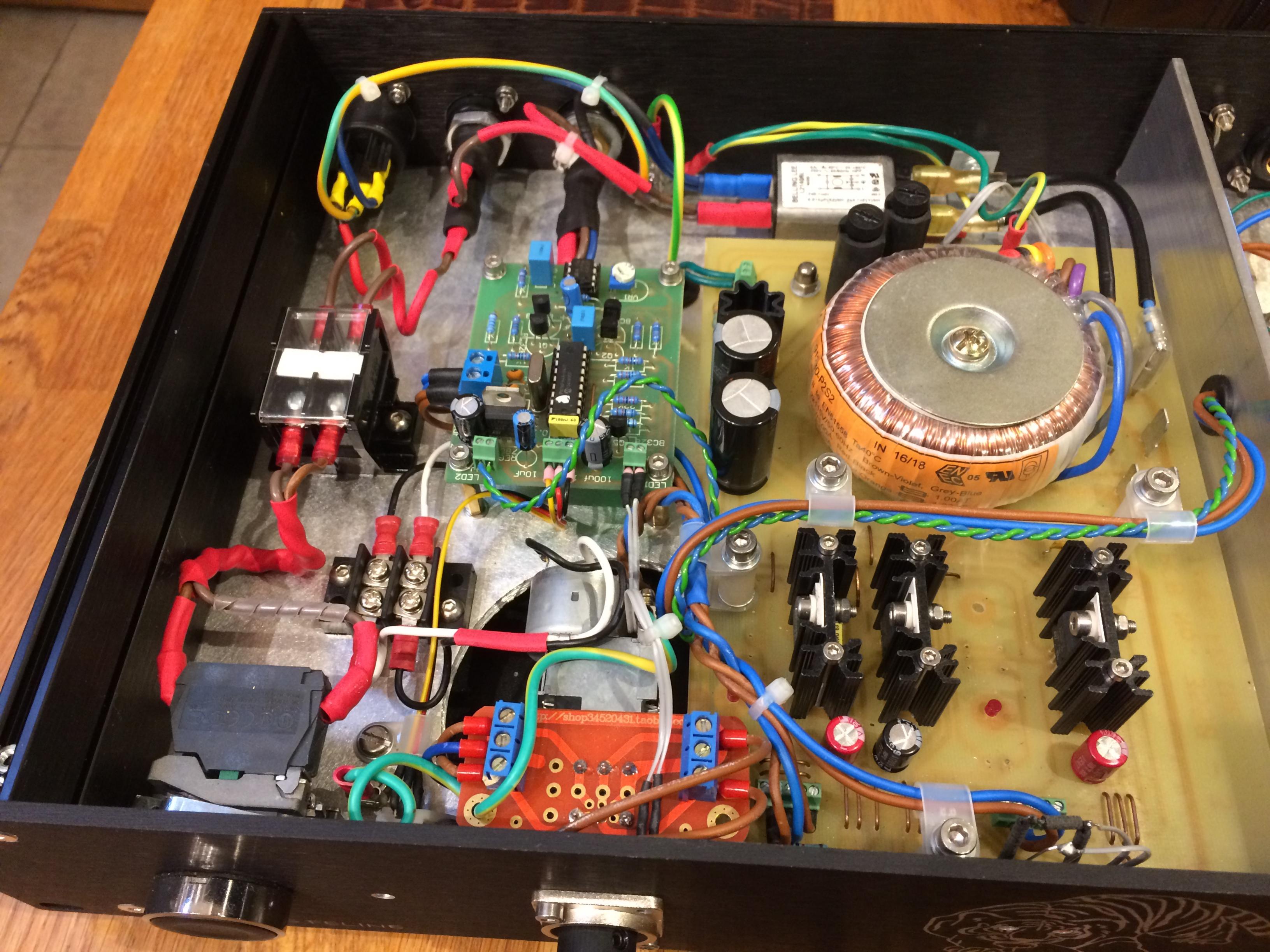

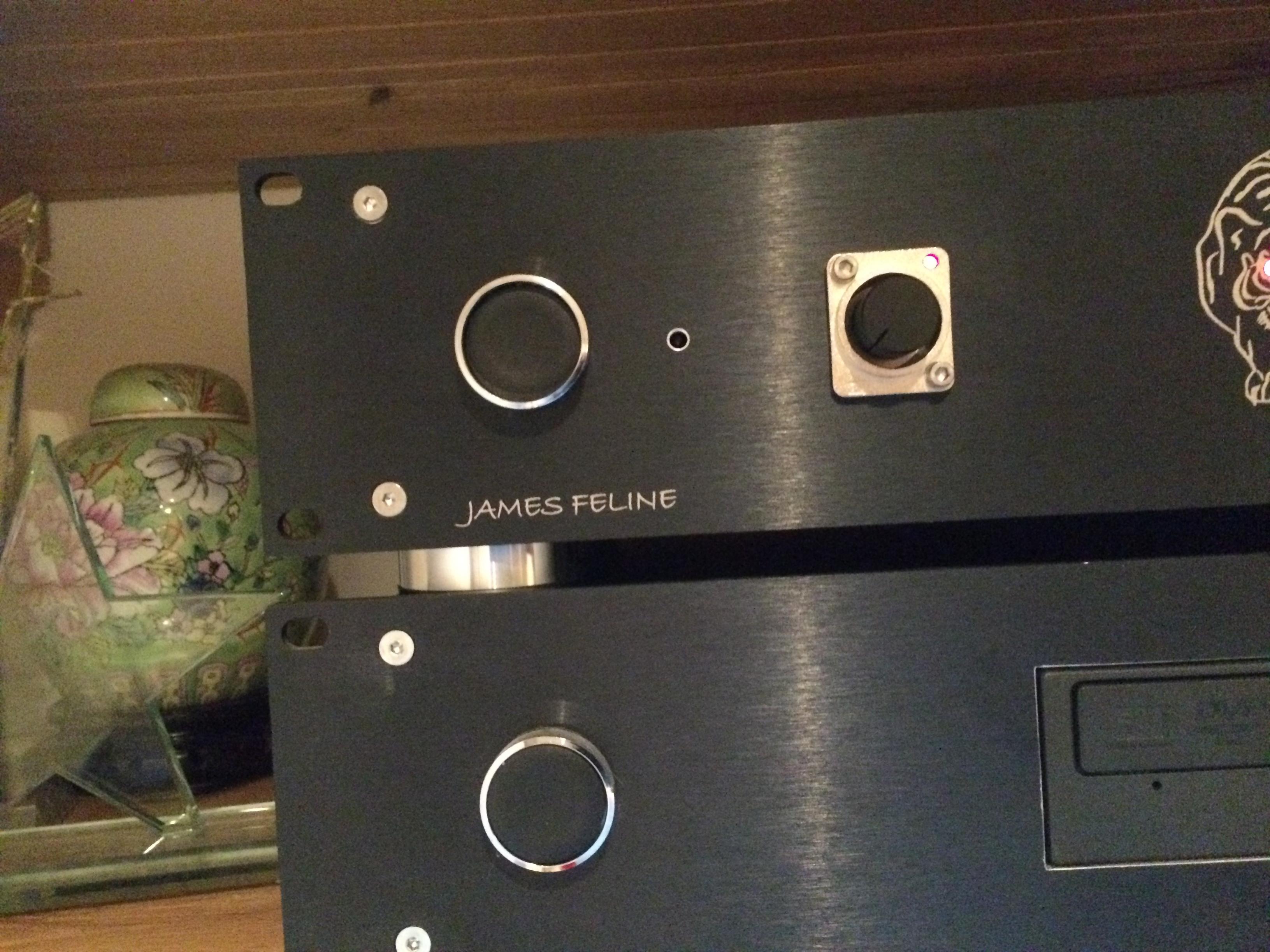

OK .. a small update on this preamp I think for the cost of the basic unit provides good value for money. So I have decided to upgrade the 1st unit I made some 20 years ago can you believe this ..
In this build upgraded power supplies and control potentiometers for bass treble and volume etc
- New Velleman Preamp with tone controls
