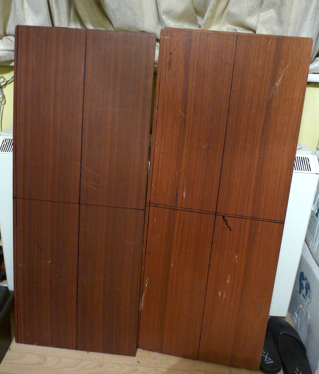

Anyways, on to progress - I work slow and am easily distracted. I disassembled an old chest of drawers which yielded a nice thick top panel for the baffle, and plenty of 10mm (reenforced by batons all over it, drawer slides) ply for sides and bracing. Super handy. I'm up nice and early today so it might be the day to start slapping 'em together.

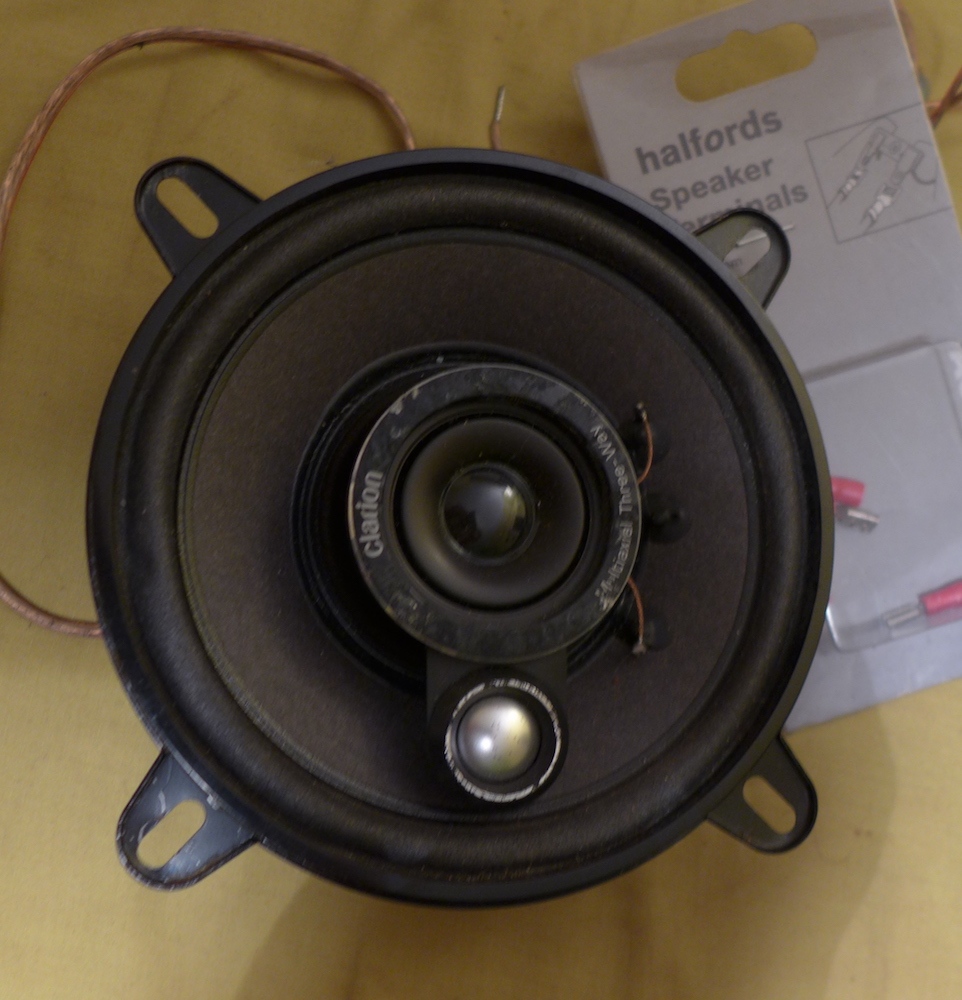

One daft question... I have some old 5.5" inch drivers which could, if sufficiently attacked with appropriate tools, act as passive radiators. Is this a stupid idea? I suspect so but it's worth asking.

Passive radiators are much more complicated than just including some random, unpowered drivers in a box. I wouldn't go there if I were you!
A PR is a vent substitute often used when the box is small and the tuning low, so a vent becomes impractically large. First off your driver is not suited to a vented box so any vented box is not a good idea (an aperiodic vent should be considered a pressure valve, not a tuned vent). A PR also complicates things by adding another resonance to the system (so not like a normal vent in that respect). A PR also tends to want to be a size larger than the driver in the box.

...A PR also complicates things by adding another resonance to the system...
Yeah, sod that, I'm keeping it simple and my expectations realistic.

Pic below. It's what I got, so It's what I'm making! Should end up about 13/14 litres. Meh, who cares, this is just the beginning of my journey from farmer-who-likes-audio to the next Grand master FitzWilliam Finkle-McGraw in the world of DIY audio. The nice fat 1" front baffle piece is being saved for when I make something a little more hi-fi an less car-drivers indoors in a box.

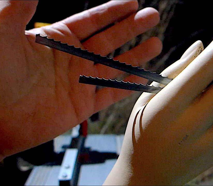

Progress stopped because of broken bandsaw blade (pic)🙁. And it's 23:30 here, windy as all hell, and not conducive to a nice relaxed sawing up of baffles and side/back panels.

Progress stopped because of broken bandsaw blade .
Wow that's dangerous.
But I guess that why we wear PPE.
On the subject of subwoofers... I'd love something to augment my XXLS400 and provide the window rattling 15-25hz range. Big, vented, possibly doubling as a table. Pipe dreams.
It was pretty mellow really, it just stopped moving. the bandsaw is completely enclosed save for the actual cutting bit, so no worries at all there. Zero fear, zero drama.
It's a cheap second hand bandsaw I got from a shop nearby that is filled with tools of all kind. Pick something up, ask the guy what it'd cost, and then get an answer. I believe it cost me £30. I got a perfectly good pillar drill there too, same price. I really should go back there sometime, see if there's a router an the right bits in the pile of tools.
