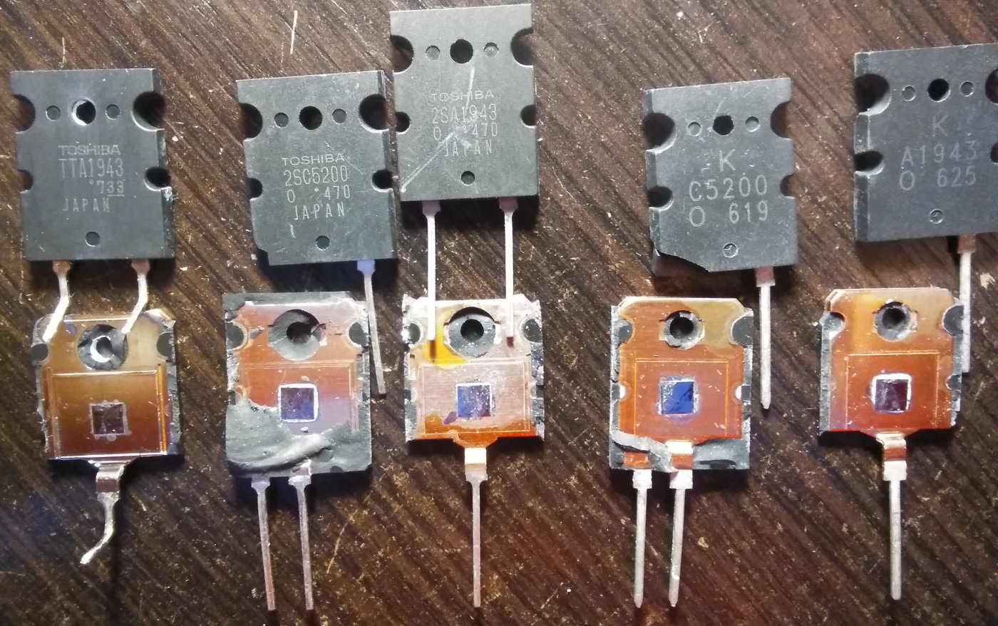

Hammer to fall... Comparison between Toshiba and KEC. (Found in another forum)
So what conclusions were drawn?
Looks like there's less clearance between the collector and the bolt hole on the KEC parts. Hard to say if it's an issue without measuring the thickness of the plastic too.
The conclusion is obvious - it is constructed properly. Different size bolt holes in the leadframe would only be an issue if it claimed to be a Toshiba part. It’s made of copper so it has the proper thermal properties. The die is big enough, which makes 150W short term dissipation possible. And the encapsulation properly adheres to the die - since it shears off in the same way that all “good” ones do. No white goop. So it will withstand moisture to the same extent as originals.

The hammer unfortunately won’t tell you anything about the fT or second breakdown capability. But it does tell you whether it’s worth further investigation. I did order two tubes of each.

Well if you think they are constructed properly, good luck to you. The chips are not even straight or centered in one instance. And as I said before, there isn't the same clearance between the collector and the screw as the Toshiba parts. My conclusion, Toshiba parts are superior to KEC in this instance. Details matter.
