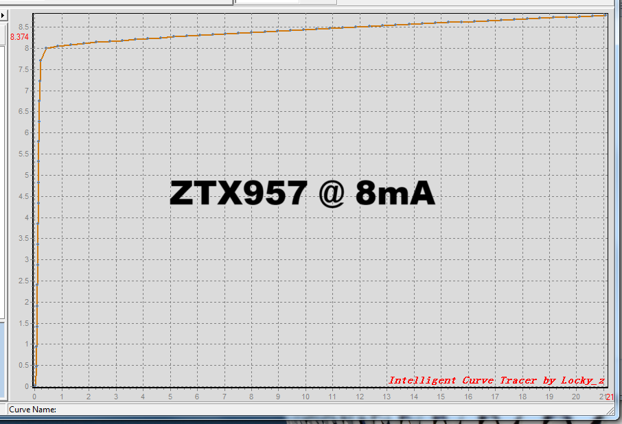

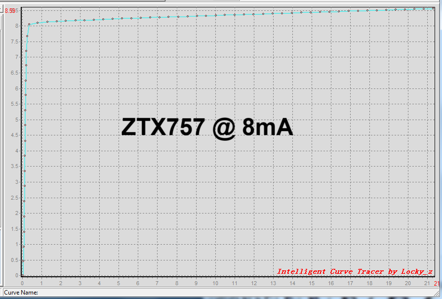

Anyone know of a good source for matched, small-signal PNP transistors? ADI seems to have discontinued all their offerings. I tried twice to get some from Linear Integrated Systems, but found them to have terrible output resistance, around 10K Ohms, making them unsuitable for what I was trying to use them for, current mirror loading of a balanced stage.

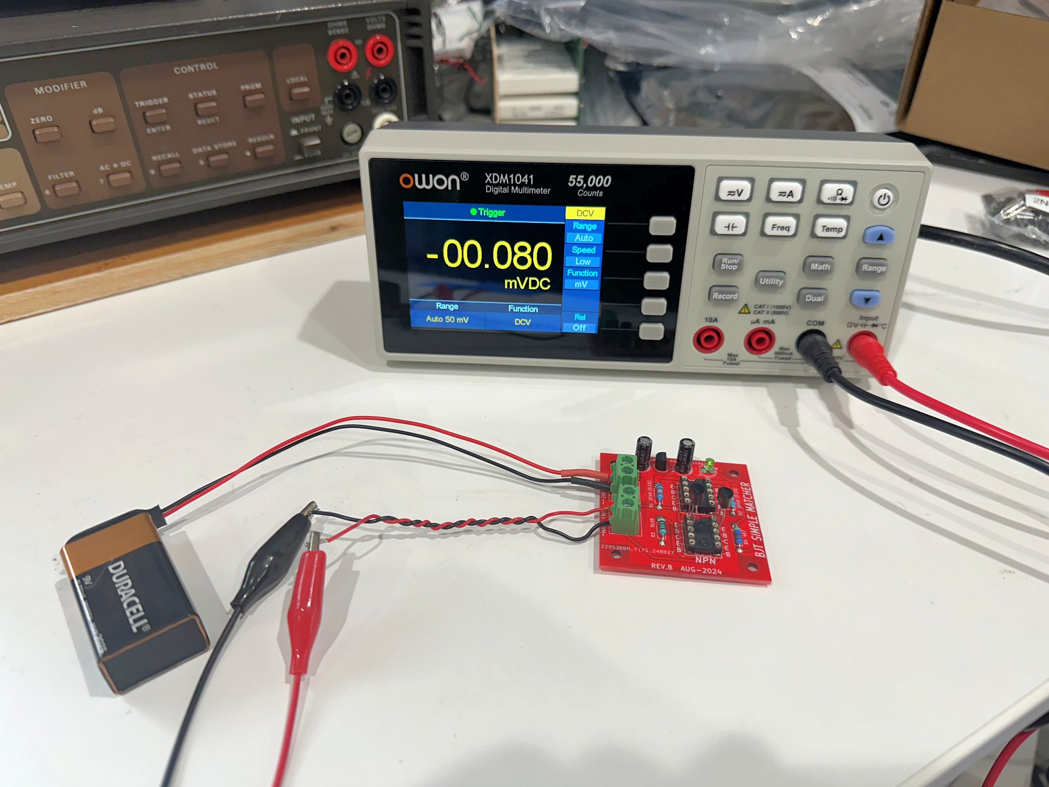

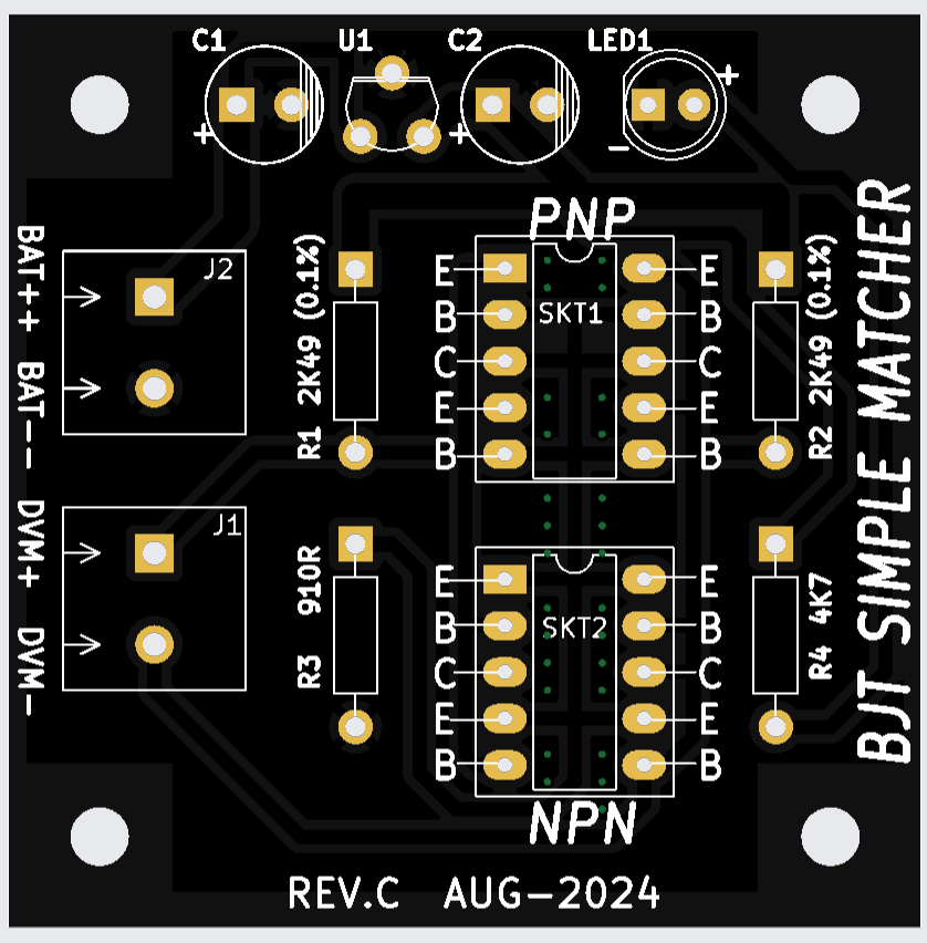

One way to get matched pairs is to DIY (link to recent Forum thread). In my experience, you get 5-6 matched pairs per hour of work.
You might consider the Diodes Inc / Zetex part numbers ZTX757 and ZTX957 , PNP bipolar transistors. The '757 have higher measured output resistance but lower measured beta (90 amps per amp). The '957 have not quite as high measured output resistance, but higher measured beta (180 amps per amp)

DIY transistor matching is only performed by people who are both highly motivated and desperate. If a usable dual transistor is available which approximately meets the requirements, most people will pay the (high) price and delight in the fact that they need not measure anything; the manufacturer has already done that. Using validated test fixtures, calibrated test equipment, and verified test procedures carried out by professionals.
Only when a dual is not available, or when it's likely that DIY matched individual parts will outperform the available duals, will builders bother with DIY matching. When you do this, the burden of measuring and guaranteeing performance specifications, falls upon you the builder. "Sure, I matched for parameter X, but how good a match did I happen to also get on parameter Y?" -- nobody else can satisfy your curiosity, you can only measure it yourself.
Read through the Burning Amp "BJT Simple Matcher" presentation .pdf, it's only ~ 15 slides, and ponder whether you are motivated enough and desperate enough to try it yourself.
