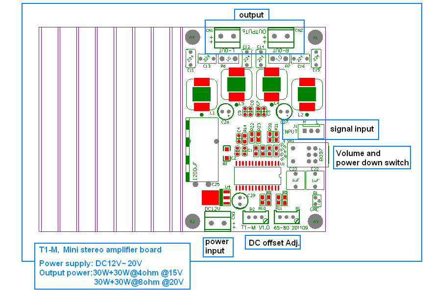

mini class-T
This is 30W+30W amp using TC2000+STA50x, I think it will be a little better than TA2024 or TA2020. What's your opinion?🙂
It's stereo and the size is 65*80mm for PCB and 112*80mm for the module(with heat-sink).
Go for more power Man !! Regarding T1/T2 I would suggest to design only a DC version. It's a nice idea to offer AC + DC version on one board but would it not be cheaper and better only to integrate the DC input ??
The same thing for T4.
Just my opinion
Just my opinion
Yes, there are two directions. T3 will have more than 300Watt outputs😉

The point of this low power board would be to run it off low voltage PSU, 12V is easily accesible many places (cars etc). It will be similar to ta2020, but with tc2000 and (in our opinion) better sound than ta2020, and cheaper than full power tk2050.
Note: T1 is only DC.
It doesn't really do much harm to include a rectifier on the boards, it doesn't add that much cost.
