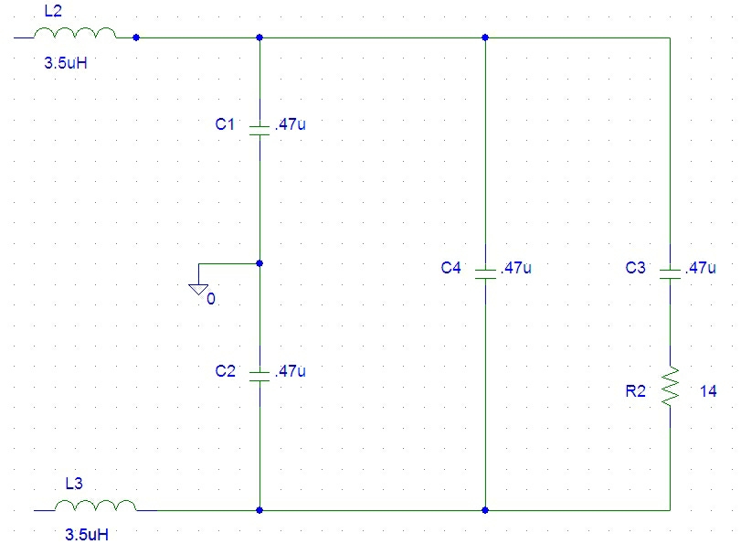

If the big coils are replaced with 4.7uH coils, what caps need to be changed and to what value? 😛
.47uf
I use .47uf with the 4.7uH coils and I also like to add a zobel with .47uf and 14R.Thanks. Two more questions:
Does the T3 invert phase at the output?
There are 4 capacitors after each pair of inductors. Should all 4 be .47uF?
I installed the Wurth 4.7uH coils in my T1 to good advantage sonically, but left the original cap.s alone.
I don't want to leave the job half done. What (if any) are the pitfalls to running
with the original cap.s?
.22
It looks like the original caps are .22uf in the T1 according to the schematic so you are listening to even less filter than I am. I haven't ever played with an amp using only one output chip for two channels (not paralleled) so I am not sure why they used half value there compared to the other amps. I have also never compared how much audibility between different types of caps of the same value there is in this application. In signal coupling the input there is a big difference with installing the Dayton foils. At speaker level on the output, maybe not so much. You can parallel another .22uf under each of the original caps, C22, 23, and 26 to hear how it will sound but sometimes when bypassing one cap with another at ratios of less than 1:10 you can get a result that starts to sound like you are listening to two different caps. C4 is .1uf? Just leave it unless you want to try an upgrade. If you really want to dial it in you can also try tuning the resistance in the Zobel to something higher than 10R. I tuned this by ear by installing 10 1/4 watt, 100R resistors paralleled together and clipping off one at a time until I just started to hear some glare to determine the best value to replace with a 5 watt resistor. Around 13-14R.

A zobel will help control the out of band peak that results from my "improper" 4.7uH/ .47uf filter. Too high a resistance, too little function, slight glare. Too low a resistance, slight loading of the amps and slightly more filtered sound on top.Hi Scott,

All four
I looked at my circuit again and was reminded that I am using .47uf Dayton foil caps at all four positions in the filter.
This is done to achieve maximum linearity with the expected load. A non paralleled TP2050 can not drive 4 ohm loads very well, hence the filter is optimised for 8 ohm loads with the .22 caps.
The paralleled version is well capable of driving 4 ohm loads and it is expected to drive such loads (subwoofers, car audio etc...)
If you want more sweetness then I strongly suggest you get a non paralleled TK2050 amp for once and discover the difference!
Your output filter changes are mere EQ-ing of the audio band, an effect not very desired in an amplifier, hence the attempts of the designers to optimise the filter to the load to achieve maximum linearity.
You can just as well buy a nice equalizer to get the same effects...
How was this done then? With through hole resistors I suspect? So you had a nice high inductance resistor there and then 'tuned' it to the ear by lowering the 'resistance'?
Ok...so much for science....😕
