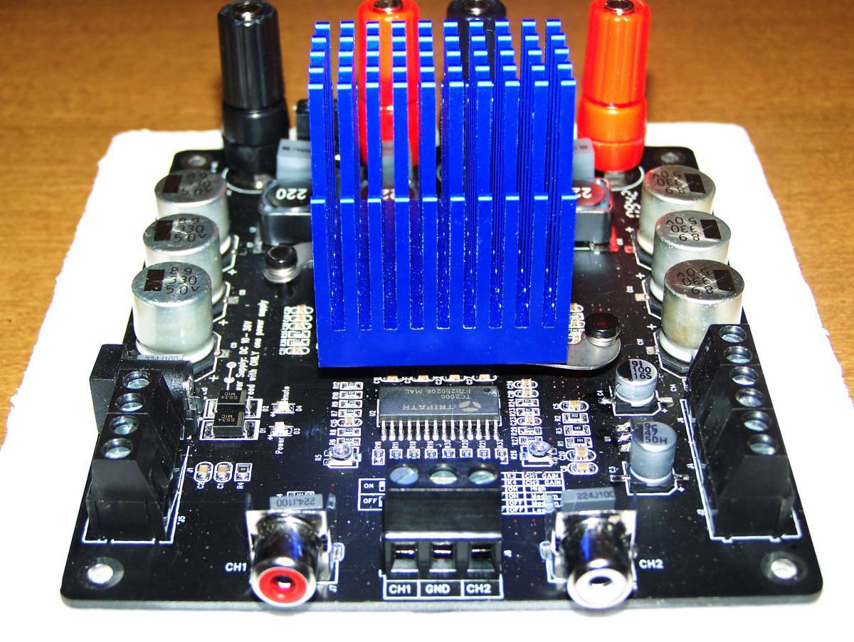

There is really just to connect the input signal, the speakers and the power (DC or AC). DC can be from 20V-36V.
AC will turn into higher DC, so what would be the safe AC input?
Hifimediy said he will start supplying the 3 pin input connector (which I didn't have when I got mine).
Depends how you want to make it. A pair of RCA plugs and 4 speaker connectors to have on the back of the cabinet would be nice. You don't need a vol put, as its already on the board.What exactly would I need to build an integrated amp with these boards?

Hi all.thanks to Nick122147 I received one of these boards on Friday.
Build quality is great and so is the sound.I have been using a sure 4x 100W board for a few months and have experience with other tripath chips 2024,2020 and 3020 guess I'm a tripath fan lol.still early for any comparisons as the amp only has a couple of hours on it but early impressions are very favourable,it does not get hot the dc offsets
were less than 1mV and 5.8mV and I guess the two multiturn trimpots are to adjust this but I haven't had a play yet.Turn on off noises are non existent thanks to the relays on the output however on switch off the mute is not fast enough to suppress the squawk from my dac if everything is powered off together but its load better than the sure board in this respect.
Currently power the amp with a meanwell 24V 350watt smps via the onboard ac in connectors but have made provision to connect direct to the tank capacitor.
Overall very happy, insanely good value Thanks again Nick.

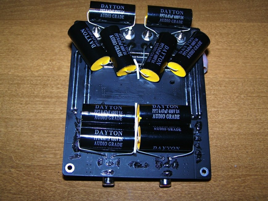

Photos
I am planning to change the layout by scraping two ground points under the board in order to eliminate the leads and to move the zobel underneath but this is what my 2X100 boards look like now. The Wurth coils look just like the stock coils.
