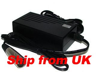

It is likely that the charger would be in a current-limited mode when you first connected it, as the batteries would be trying to take more current than the charger could supply. Normally the charger would change from a current-limited mode to a constant-voltage mode as the batteries charged up. 30V is too high to leave connected to the batteries once they have charged up. More advanced chargers alter the float-charge voltage depending on the battery temperature, but for a normal charger, anything over 28V (for a 24V SLA battery) is too high to leave connected as a float charger.
When I'm charging a 24V battery pack from a bench PSU, I set the PSU to 27.6V and monitor the battery current. Once the current taken from the PSU by the battery pack has dropped below 50mA (for 7A-H or 12 A-H batteries) then it is effectively fully charged and can be disconnected.

The charger has two lights, one of them should become green when charged, and might start acting as a float charger then. So you're saying 30V during charging is ok?

Well, 30v is still higher than I would use! I have a Chinese-made 24V charger myself, intended for charging the 24V battery pack in an electric scooter, so it really is meant to charge batteries of 17 amp-hours or so. If the 30V supply is connected for too long it will cause excess pressure and temperature in the smaller 7 amp-hour batteries. Perhaps you could leave the charger connected until the green light comes on and see what the charger voltage does.
Does the charger buzz all the time, or only when it is current limiting? Is the charger a switch-mode type (looks like a laptop PSU), or is it a traditional mains-transformer type? Either way, a 50Hz or possibly 100Hz buzz isn't surprising. Is there a current rating on the charger? I guess it will only need to be connected for 3 or 4 hours to fully charge the batteries, so the buzz might not be too much of a problem.

The charger is light, but larger than a laptup type, about 8cm high and 15-20cm long, so probably not a transformer type. The buzz is all the time, I havn't gotton to the float charger stage yet. will try to reach the green light and see what voltage it show then.
This is the sort of Chinese 24V charger I have, which seems to work ok with 7 A-H or 12 A-H batteries.
Is yours completely silent, any noise at all?

Mine is a 4A charger made by "Coming Data" and bought on Ebay. It gives a regulated output of 27.8V, with a current limit at about 3.6A. it is almost totally silent.
