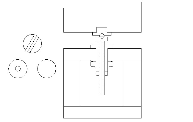

Three balls support
Hi all,
There is a problem in splitted platter design worth closer look: contact pattern between main platter and subplatter. Three small cones mated with the cups cone recess seems to be the obvious choise. Ideally, the cone and the cup should contact on circular line. BUT, they never will, due to: 1) manufacturing inaccuracies, and 2) different temperature expansion factor of aluminium and vinyl/perspex. In other words, the contact become somehow loose, uneven and inconsistent. Everyone is aware of tight contact importance in tonearm bearigs, it also matters ewerywhere in vibration transmission path. The way to solve the problem is rather simple: get rid of superfluous constraint ties. The solid body has to have 6 degrees of freedom constraint to be fixed in space, not more. Practical design solution:
- three bronze adjustable pins with conical recess on top
- bearig balls about 5 mm diameter inserted in pin recess and slightly pressed for good contact
- three SS cups with different contact surfaces: cone recess, straight V-groove and plain surface.
So here we got circular line contact in conical hole, two point contact in the groove, and one point support on the plain surface: 3+2+1 = 6 degrees of freedom constraint. Temperature expansions and production tolerances are to be totally absorbed without additional side forces at the point of contact. Uncompromised vertical stiffnes and perfectly consistent contact is achieved at low cost.
Comments?
Hi all,
Comments?

Thermal expansion keeps coming up and I really think it is almost moot due to environment that a TT will be operating in. I doubt any of us will have the TT in a place that goes below freezing or above 100 degrees(f). In any shop I have ever worked in, the temperature at which all materials are measured is 68 degrees(f), that is the golden rule, which is pretty much right in the middle of my EXTREME temperature range. I have made very close tolerance delrin, aluminum and steel parts in very hot and cold environments, and only once have I seen dimensions vary dramatically and that was with Delrin. The parts drifted about 0.0005(that's 1/2 of one thousand of an inch folks)which in our TT project does'nt amount to much. If we were operating the TT in an environment in temperatures <freezing and > 100 degrees(f), I would really be concerned.
If you press the balls in, you will have to go beyond the centerline of the ball to achieve a press fit so I would simply machine 90 grooves in each cup, making sure each cup is within 0.001 of each other and go deep enough so that the ball is retained a sufficient amount, no press fit, the balls will locate and maintain good contact with both cups.
I guess I don't understand the 6 degree philosophy, don't you think the high mass platters with the inserts/balls would be sufficient? 🙂

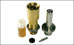

SPINDLE.
Hi Mike,
In the picture you see the spindle and the Delrin washer as delivered with the package.
If you decide to use these parts all you need to do is make a tap in the center of the top platter and you're done.
The screw on clamp hardly execres any downforce on the platter,it uses side forece to flatten the record.
The material for the cones should be of sufficient hardness to carry the weight of the platter,I feel it best to round the tip a little so they won't pierce into bottom platter.
Cheers,😉
Hi Mike,
I had the same concern. So I assume that to use the Teres bearing one would just need to have a longer spindle machined that would go through the upper platter?
Any issues about the clamping pressure dulling the cones or cutting into the mounting points of the upper platter - what if the cones were steel pressing into aluminum? Or hard but brittle ceramic being repeatedly subjected to clamping forces?
Cheers,😉

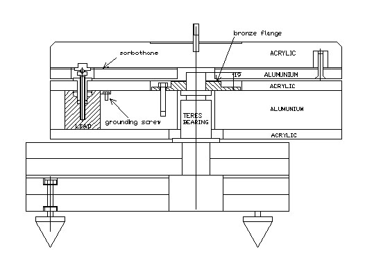

Stylin, all,
The Teres bearing certaily can be used for both splitted and one piece platter desing. Record pin may be threaded in the upper plate alone. Bearing axle has a boss rising approximately 19 mm above the shoulders (dunno exhactly, I’ll ask the Teres forum folks). I intend to fix the platter with additional flange, keeping CofG as low as possible, and also allowing platter concenticity fine tuning, shifting the platter within the larger-than-bolt holes, when the bolts are loosened (do the static balancing AFTER that).
Find attached TT plan last issue. Just note, it's dimentianal CAD drawing, everything in scale, including bearing. Some additional features added recently: support studs are grounded to subplatter and then through the bearing grounding post to the ground bus with a strip of copper foil and screw. I think it will not do any harm, and may be I’ll try carbon composite platter later on. Second, CLD platter with uncompromised vertical stifness: 1” acrylic,1.5 mm sorbothane, 10 mm aluminium, stuck up together with SS bolts and helycoil inserts. Seems to me most promising at the moment.
Subplatter is machined from 1.5" aluminium block, 200 paid for it alone. If you still need my subplatter drawing, drop me a mail, and I can attach it.
As for engineer's expertise: I'm in aircraft engineering field more than 25 years; it's a different zone, but anyway...

Cool drawing but something else to think about
Chris Brady sent this to Teres forum today:
"In case some of you have not heard, we are developing a hardwood platter that sonically is a quantum leap better than the our acrylic platters.
http://www.teresaudio.com/good_wood.jpg
We are having a small number of platters made that should be available some time in March. The platters will be made from a matrix of small pieces of wood, laminated with lots of epoxy. The core of the platter will be made from Jatoba

Torque wrench
You can pick up an inch/lb torque wrench at Sears for about $50 I think. The Craftsman brand is good, I have a foot/pound wrench but that is too heavy duty for your needs. Tighten 1 screw without the torque wrench until just snug, then use the Torque wrench on it and turn it down to its lowest setting and apply it to the 1st screw, adjust it higher until you hear it click. Torque all screw to that setting. I would use coarse(10-24)bolts if you are screwing into PVC. You don't need to tighten the bolts super tight, you will strip the PVC if you go overboard, start a little past snug and see if you're happy with the result.
Also, make sure you use washers under these bolts, the aluminum subplatter could gouge, IOW, make sure you counterbore the subplatter deep enogh so the bolts will be just about flush with the bottom of the subplatter, for aesthetic purposes. Good luck! 🙂
I guess there is no other option but to screw and bolt the two layers together. My machinist says that drilling from under the platter we can bolt from there. That way there is no visiable holes or impedance mismatchs. He stated that the PVC is quite tough and can be threaded to hold the bolts without a problem. If I were to use many bolts with low torque I don't see how this can be a problem. Would I buy a gauged accurate torque wrench to do this with? What psi should I torque these bolts with? Just like bolting on the wheels of a car I would torque the bolts in a cross pattern. So it will be evenly torqued.
Autocad file...
What version autocad is your drawing?
I can work with just about any release, maybe you could zip me your file and I could take a look at it. 🙂
BTW, is the Aluminum resting on the Teres bearing?
May I suggest just the necessary tightening for the materials not to move?
Too much pressure and you're in a different ballpark altogether.
Cheers,😉
