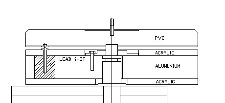

Fdegroove,
Here is your split platter idea combined with dumped subplatter. The upper PVC main platter with thin dumping layer (like sorbotran) glued underneath, which is rested on 3 small brass cones. The cones are glued into acrylic/PVC layer and submerged in lead shot/oil mixture and thus decoupled from subplatter. No bearing/belt-induced vibrations reach the main platter. Stylus-induced vibrations absorbed by PVC and sorbotran layer, which is also greatly reduces lower surface reflection, without compromising platter stiffness.
What don you say?
Michael
What don you say?
Michael
SPLIT PLATTER.
Hi Michael,
If I were a bureaucrat your design would get my endorsed stamp on it.😀
Cheers,😉
Hi Michael,
Cheers,😉

Upper acrylic layer
Made of 10 mm acrylic and glued to the aluminium subplatter. Have 24X10 mm holes above lead cavities to fill 21 of them with lead shot/sand/oil mixture and then to be sealed with plug. Platter spikes are glued into the 3 remaining holes.
Lower acrylic layer
Have 3X10 holes to fill the cavities with spikes from below and to be sealed with plugs. 12X10 holes intended for fine balancing, to access the subplatter for drilling out the aluminium.
Lower layer is also glued to aluminium subplatter.
Comments?
Comments?

Problem with glue is manyfold:
It disperses itself in all directions beyond your control.
It is never really reliable as a joint.
It deteriorates over time.
And so on....
Actually just rest it in a way as Michael does, but rely on the mass of the top layers to keep it firmly seated.
Spike and cup style,for instance.
If you're using cone shaped supports use an odd number,the fewer the better and put one with the point facing upwards,the others point down.
You can use three layers of various materials,just choose these wisely as to not compromise your goal.
Just ask and I'll try to reply the best I can.😉
Cheers,🙂
The dual platter seperated by cones concept is entirely new to the turntable comunity.
Done that ten years ago already and so has my friend Tom Fletcher from Nottingham Analogue.
We did push it further still though.
Results were extraordinary....
fdegrove I wanted to follow up on that topic of "gluing"
My advice: don't glue.
And so on....
Cheers,🙂
