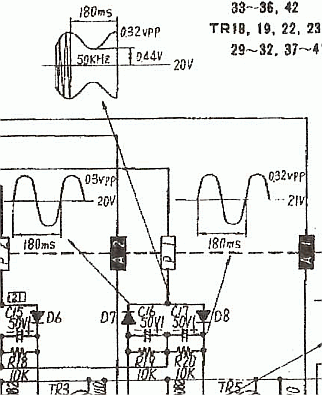

This is only a drawing - not a real oscillograph, but it makes me think I should see sine waves in real life.

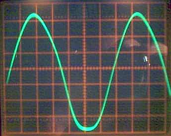

I've decided on a Wein bridge for the phase excitation oscillator, since it requires no inductors, and it gives a low distortion sinus. Don't be confused though - this sine wave is not the one that actually drives the motor, so low distortion maybe is not all that important.
Anyhoo.. it's an easy oscillator to make work, with everyday parts (like an NE5534, as I used here - a good use for the noisier ones that have no place in pre-amps!)
With that done, and an active full-wave peak detector to recover the signal from the phase pickup coils, this is the waveform that I get: oscillograph.
(now that's one of the three 6Hz or so signals that will actually drive the motor)
There is some distortion, which does NOT come from the detector circuit - it's a very linear detector topology. So I went searching for the source....

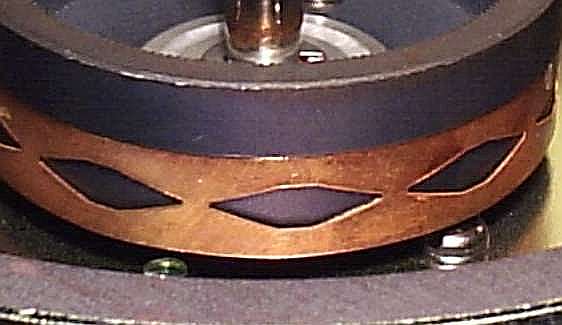

It turns out to be in the construction of the motor itself:
[It seems I can't put two picture in one post, so see next post for this picture]
take a close look at the copper-coloured reluctance ring: the 'top' and 'bottom' of the diamond shaped holes are flattened off, which puts a plateau on the lower limit of the magnetic coupling between the exciter coil and the phase pickup coil.
After AM demodulation, that shows up at a slight flattening off of the lower peak of the sine wave.
I suppose purist might even want to remove this ring and file it to a better shape???

The SP10 motor reluctance ring, referred to in the previous message.
While staring at it I had another thought.... for the masochistic purists (puritans???) it would be possible to laser-print a more sinusoidally accurate black/white image, much like this string of diamonds (or even cut it out of paper, like those party festoons of figures holding hands!), and stick this printout/cutout on the outter periphery of the motor - where the brake band is normally. Then read it with three photo-diodes.
After more amplification & filtering. (3.5v p-p, 5.555Hz)

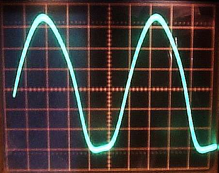

I would just stop the bottom edge clipping, perfection and all that!.
Under near stall, but locked condition, the voltage stays the same but the drive current goes from about 100mA to nearly 1A.
The voltage is actually 28 volts. If I have managed to do this, here is a image of the drive waveform under load. How to put a thumbnail in would be good?
It isn't clipping - well not in the sence that amplifiers clip, due to transistor saturation, or running out of headroom.
You have a way to 'peak' the bottom of the wave?
What I'm getting does look rather cleaner than the 'real' SP10 signal you're measuring.
The broadening of the trace at the peaks is because the waveform fluctuates very slowly, and the pic is a very slow exposure.
28V ? Ok.. we can do that.
