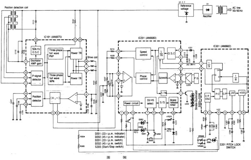

>using the PLL to generate the lead / lag signal.
Oh yes, PLL control as well!
A PLL's lock range is quite limited and it is necessary to use velocity (RPM) detection to bring the PLL into lock range first, THEN do phase locking.
That AN5675 Ic used by the 1210 is pretty much a clone of the discrete circuitry used in the Sp10.
The major difference that I'm proposing is to vary the exciter oscillator signal, rather than try to adjust or vary the 3 phase coil signals. This means only one VCA instead of 3, and no need to control the symmetry / balance of 3 independant amplifiers.
The phase comparator method I have not decided on. Method-1 would be to use a ramp generator and sample-hold (as done in the original SP10).
Method-2 would be a digital method, using a phase-to-PWM converter (quite simple with one RS-latch and a D-flip-flop).
I guess I'll make one of each and see what works.
Theres also going to be a problem measuring the overall performance - the sorts of wow/flutter figures quoted by the best TT manufacturers are very low, and measuring a consistent improvement might be tricky.
I'm still interested to know what peoples problems are with the original SP10 electronics - WHY do you want to replace them?

Happily the circuit schematics are understandable.

Well, this is interesting!
A PIC to generate the 3 phase signal and using an onboard D-A should be OK for some people, but not me!
A comparator or two to read the position coils and an oscillator, this I can do.
Then there is the PLL to get the speed right, something like the phase comparator parts of a 4046, this I can do too.
And the motor driver, possibly using FET's or a bridge audio amp chip, this I can do too.
So guys, do we have a team? Are we up for it?
I wasn't going in that direction - you already get 3 very low distorion, correctly phased sine waves out of the motor itself, so they should be put to good use.
However, your suggestion has an element of attractive simplicity:
If you generate 3 AC waves with a PIC, there is no need for a PLL servo at all - The motor will run synchronously with the PIC crystal clock.
If you use the PICs internal PWM counter/driver (or even a software PWM output on a PWM-less PIC), no need for a DA converter at all - just a power stage & filter.
2 caveats I can see using this technique:
1) it will be harder to add a pitch control - not impossible, just needs some software trickery.
2) since the motor is not under linear control, the drive current will be fixed, which may stress the motor unecessarily.
I've been 'diverted' writing the IR decoding assembler (i'm perverse, I want to use the Nokia protocol, which doesn't seem to have been done with a PIC yet and publicised) - so I haven't had my mind on the actual PLL or drive circuits lately. Things will process at a faster pace soon - I HOPE!
There are two problems using the position sensors as generators, first it would never start and secondly the waveform is awful.
I hadn't thought of driving the motor as if it was a synchronous motor. Interesting!! However synchronous motors do slip and speed accuracy would be a problem.
As the SP-10 is arguably one of the best turntables in the world, it would be nice to improve on it. Feed a 3 phase low distortion sine wave is one way. And yes, I forgot we would need 3 D-A's or 3 external LPF's.
Pitch, would be nice, especially at 78rpm, and this could be generated in the PIC? A DDS would be way over the top!
Whatever, my field of expertises is in the analogue arena, the PLL and drivers I can do.
I need to get my head around PLL and or current control. I suppose the best would be both, with no, or a constant phase error, very little current. So effectively two feedback loops, frequency/phase and current?
I think you misunderstand the function/operation of these coils.
There are 3 of them, set 120 degrees apart, each one is magnetically energized by an exciter coil adjacent to it, but not closely magnetically coupled to it.
Machined into the rotor is a sinusoidally shaped metal coupling ring, that runs adjacent to the exciter coils and the phase coils.
As the motor rotates, the reluctance between the exciter coil and the phase coil follows a sinusoidal pattern - as determined by the physical shape of the coupling ring.
The waveform is determined by the physically cut shape of the coupling ring, and is thus a VERY good sine wave. This wave - amplified by a linear gain stage - is used to drive the motor.
The use of exciter coils and variable reluctance, means that the generated waveforms are of constant amplitude, no matter what the rotational speed. Only the frequency changes.
Because the position of the phase coils slightly leads the phase of the actual motor drive coils, the motor always produces torque, at any speed, and will always start. And it *is* a synchronous motor - the only oddity is that the 3-phase drive is generated within the motor itself. It is both a 3-phase synchronous motor and a 3 phase alternator in one.
Because the phase coils are energised in syncronicity with the motor rotation, the setup *behaves* exactly like a DC motor with a mechanical commutator - there is no inherent speed limit as with a conventional synchronous motor.
This is where the velocity feedback (Mk1) comes in and, later on PLL (mk2), which backs off the drive current, increasing the slip.
I have 3 SP-10MKII's and on all the waveform is not good at all. On one unit, I have gone all the way through it, replacing components as required, it works well, but the waveform is not nice at all.
By deliberately generating a low distortion three phase drive, one would be guaranteed of a better performance, especially if you are able to vary the current to only that required?
But I'm easy any way, do you have the technology do do any of the bits I can't?
That's interesting & odd! As I've said before, I have nothing BUT the motor, that I got in a box of spare parts at a closing down sale.
My tests on it so far show up a good 3 phase waveform; perhaps there are some limitations in the circuit design of the original control circuit.
What you get from the 3 phase coils ought to be a 50kHz carrier wave, whose envelope is amplitude modulated with a sinusoid of around 6Hz. AM demodulation - i.e., boring old envelope detection is done with a Ge diode pair on the SP10 & gives a pair of 6Hz sinusoids of opposite phase.
Maybe non-linearity in the diode detector is creating the distortion?
Is a 'nice' waveform really necessary? Mechanical inertia, and the negative feedback property of the PLL get flutter figures below anything I'd ever be able to measue - and certainly no be able to hear.
The alternative - as you say - is ignoring these signals altogether, and using a PIC to create 3 sines of variable frequency - somewhere around 6 Hz. I was avoiding thinking about it because I hate writing assembler! But in principle, its not dificult - just a sine look-up table and appropriate delay loops in the right places.
Hows your MPASM?
It would still require an analogue control loop I think - because unless you drive the motor at high current all the time, there will be a phase lag that is dependent on load torque.

I think you may be right. The waveform is not nice, but that could be the electronics, and we aim to replace them!
I'm out for perfection and any increase in sinusoidal drive performance will help. I have an current Microchip Technology PICSTART Programmer, but only to blow chips from code people send to me. I'm not a logic or firmware designer, I'm analogue only and good at that!
On the unit as supplied, if you try to slow it down using your hand, you can see the strobe marking move slightly, still in hard lock, but displaying a phase shift. Also the current goes up to nearly 1A from the 32V supply which normally is about 100mA.
