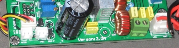

I have only guesses for how to hookup the amp so a little documentation could be very useful.
For example, between a choke and the 12v power VCC/GNDare a set of green screw terminals. I have no idea what they are for. What do I hook those up to?
The two white "over" and "pow" terminals are vague. I imagine that these are for the LEDs. I'm not sure about the orientation, +/-.

Yes, I believe your version is the revision after mine.
On mine, the power LED and Overload protection LED are mounted onboard.
Yours has terminals instead, allowing you to mount the LEDs on the facia - I thought it shipped with the necessary leads and LEDs, but perhaps not.
As LEDs only work in one direction, it shouldn't be hard to ascertain the polarity of the power one. One would then assume the overload would be the same.
As for the green block - I've no idea - there doesn't seem to be anything like that on mine.

LIN is Left In
RTN is probably RIN, Right In
I've only given the board a cursory glance.
From what I can gather, if a multimeter shows connectivity (zero ohms) to the red input caps (edge side), then a pot should hookup directly to the red/black/yellow. I'll check tonight and let you know.

The green terminal block is a complete mystery. If they aren't hooked up correctly will I end up destroying the amp?
The red/yellow/black input wires can go directly to the volume pot. There's no need to mess with the pads on the pcb. This is nice but I might anyway.
The green terminal block is for AC power in. I am going to use an SMPS so there's no reason for me to use it.

I have the same board, is the green terminal block for AC power?, am confused. will the amp work if AC power is connected?

I don't think using an AC supply is a good idea. Over voltage is possible. My wall socket puts out 125vac. A power transformer with 115vac primary will run over published specification.
An switching supply is regulated. I bought a 12volt @ 10A supply through Ebay. It's not here yet.

Not sure if you have the same board I bought, but I connected AC power to CN401, which is the top most power connector and it worked (and put the on/off switch against SW402). Specifically, I chopped up a normal AC cable and connected the two non-ground wires to CN401 and just left the ground alone.
I considered asking for an external power supply as all this board really needs is 12v @ 10A, but it handles the 230v AC power I'm feeding it, which is within the specification in Arjen's documentation, and converts it. So far so good.
