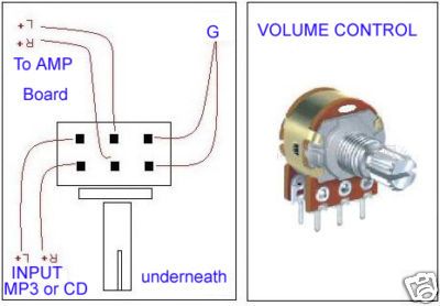

Tony, I will be getting the same MKII Version of TA2020 and will be adding the volume pot.
Any recommendation on how to do it on this board?
gychang
Hi! This was sent me by Arjen:"To connect a volume potmeter you have to do the following:
- every stereo potmeter has 6 pins, in 2 rows of 3. every row of 3 is one channel, so one for left and one for right.
the 2 last pins in each row can be connected to the ground wire from the PCB and from the source
the middle pins can be connected to the TA2020 PCB input
The 2 first pins can be connected to the source.
if you have connected it it looks like this:
[R-source][R-amp][GND]
[R-source][L-amp][GND]
then it should work!
all these connectors should have there function written next to it
See the picture I've included, and orientate your pot in same way - ie turn it upside down with the pins sticking up, and the knurled knob facing you.

1. connect top left pin to right channel from cd output (or whatever source).
2. connect top middle pin to right channel connector R input on pcb board (or whatever source).
3. Top R pin on pot to ground (or earth) on the board.
4. Connect 22k resistor BETWEEN top middle and top R pins on pot.
You place the pot between the output of your source (CD?) and the Input of the Tripath board.

Hi! Forgot to mention that there is no space for the pot on the board, so you will have to mount it on the panel of the container you put Tripath PCB into.
PS If you have a pot with 4 pins at top and 4 below, the pins on left end would most likely have been used for a 'loudness' filter, and can be ignored. (Orientate pot as in pic above).

The output from the preamp connects to the R GND L input on the Tripath - the smaller white female connector socket.
This
"[R-source][R-amp][GND]
[R-source][L-amp][GND]"
in post #29
should, of course be:
[L-source][L-amp][GND]
Kind Regards, Tony Swaine
