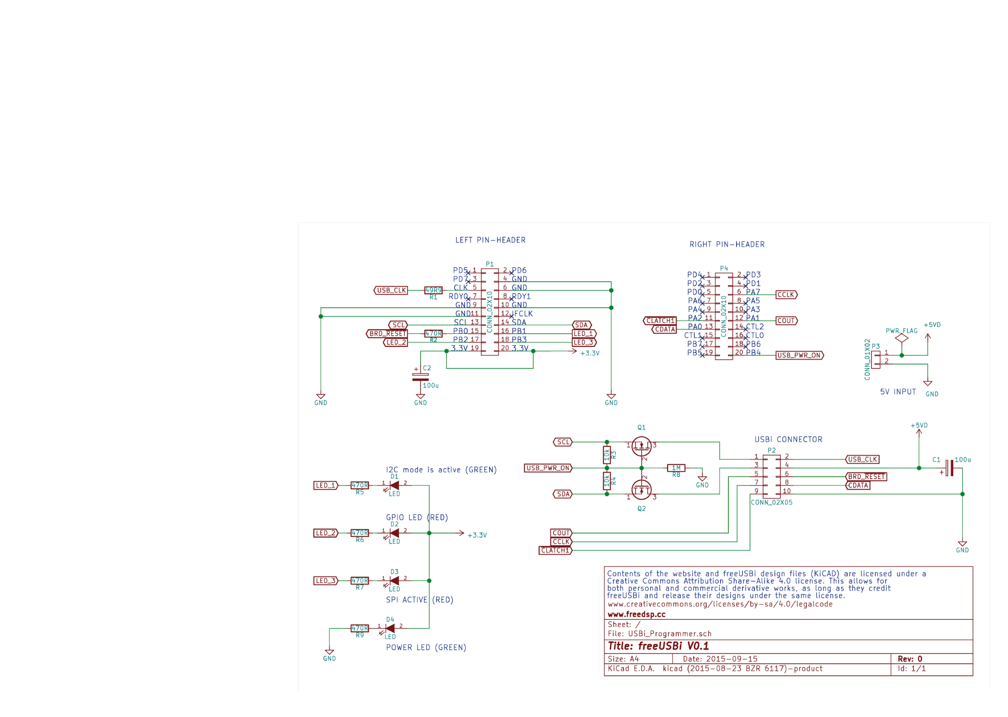

As I mentioned the Freedsp people have done a great job:- I thoroughly recommend their quick start guide for the FreeUSBi (which can be found here https://docs.google.com/document/d/1rKkCl3gyePwX15c3sjEIKP6Bb7CO77hgRAXtbYz5hA0/edit?usp=sharing ).
From that document I have copied their schematic (first enclosure)
The connections (from the cypress chip) that I have replicated are
1) Gnd (from P1.6)
2) Brd_Reset (from P1.15, with the limiting resistor)
3) USB_Pwr_On (from P4.20)
4) SDA (from P1.14)
5) SCL (from P1.13)
(The other connections, LEDs etc are nice, but optional)
Gnd is Gnd, I connected it to J3p4 on the Sure board and the level shifter
Brd_Reset goes to J3p9 via a 470 ohm
That leaves the circuitry around Q1 and Q2 on the FreeUSBi to bodge.
I used this level shifter
1PCS 5V to 3.3V Bi-Directional SPI I2C Logic Level Converter 4way Arduino | eBay
but there are lots out there
The second enclosure gives the schematic for the level shifter.
These are very similar to Q1 and Q2 in the FreeUSBi.
By connecting USB_PWR_ON (from cypressP4.20) to LV on the level shifter (and thence to ground through a 1meg resistor) the original circuit is largely duplicated.
I then feed scl and sda from the cypress into LV1 and LV2 and take them to the Sure board from HV1 and HV2. It seems to work, though I really ought to tie HV to the 3v3 on the Sure board.

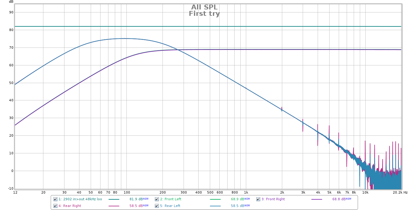

All, the shipped firmware is indeed a 2 way cross over. I have not had time to pot twiddle, the attached graph is as the card came out of the box. Traces are basically loop bypass (flat) and the two outputs (L/R channels pretty much identical). Dig those crazy resonances in the sub-woofer output .... good job that your woofer cannot reproduce HF eh

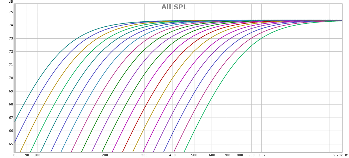

MP3 main channel bass roll off (-12dB octave). 0V -3dB at 800Hz, max V (ie 3.3V) -3dB at 120Hz)

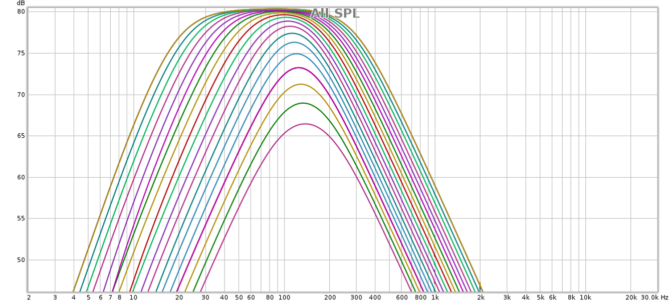

MP8 Sub woofer filter centred at 160Hz, 0V -3dB points are 80/240Hz, 3.3V-3dB points are 20/300Hz
MP9 Sub woofer gain, 0Von pot reduces output by 54dB below 3.3V value (which is around -2dB)

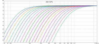

I looked at the main channel lf roll of on MP3. It is quantified, 19(?!) levels, equally (log) spaced -3dB points between 117.6 and 780Hz ...... which would have been 120 and 800Hz if they had used the right crystal!
