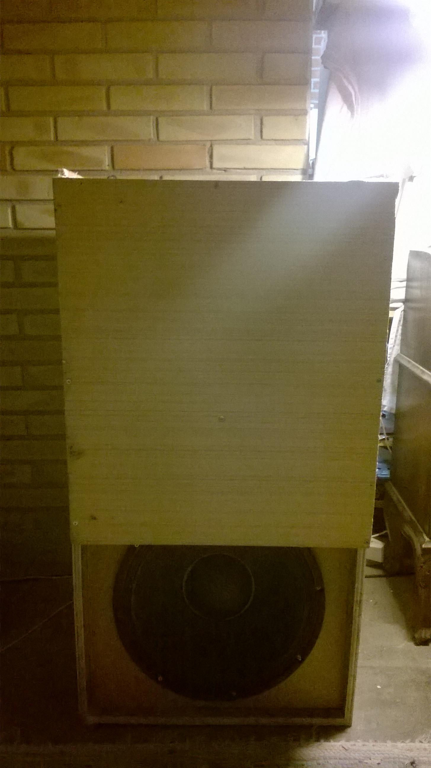

I have finally put the last screw in the first prototype box and gave it a spin on the test bench.
Not been a carpenter the sound is more beautiful than beholding the box 😀
Here internal with stubs ect.

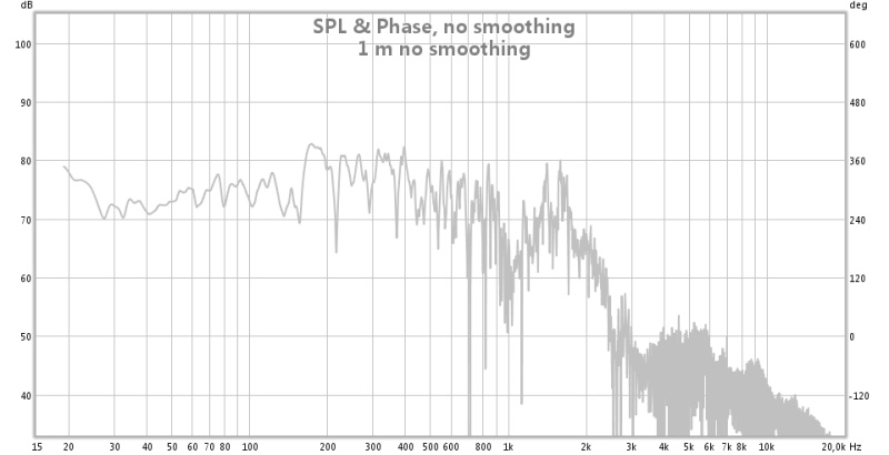

Measurement 1 meter from speaker 40 cm above ground; no smoothing

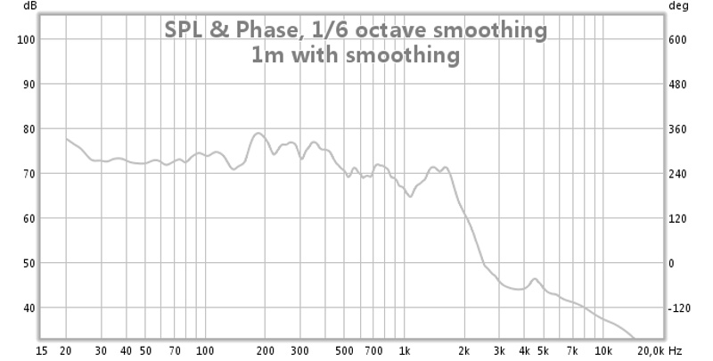

With 1/6 octave smoothing

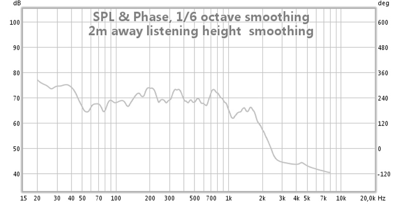

Here from 2m and 1m above ground, with smoothing
There is full output from 30 hz and still usable output at 25 circles, which is good by any standard. As predicted in Akabak response falls of around 900-1000 hz so here it will be crossed over to a horn driver, making it a 2 way system.
I have used it as a sub to 90 hz which was nice, no anomalities so far. Measurement suggests a somewhat uneven response further up. Experimenting with front aperture is first thing and maybe I can remodel the internal a bit for a flatter response.

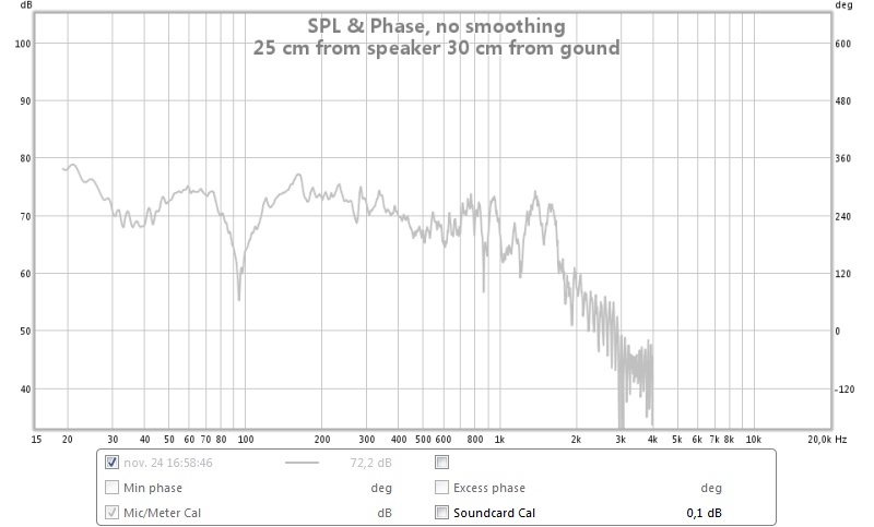

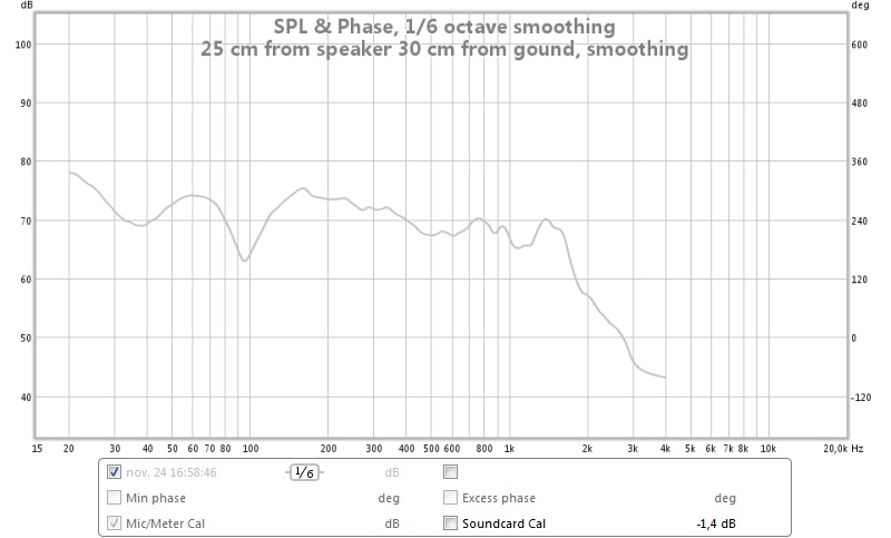

More measurements.
MMJ suggested moving the microphone closer to minimise room effect. So I did some more graphs.
The big dip at 100 hz is a suck out (black hole - so much for taken the room out of the equation😉). If I use a tone generator I don´t hear the dip, actually 100 hz is very strong. Running through the response with a tone generator, there is to my ears, fine output to 1000 hz, very nice. Next I'll play with the front aperture.

Indoor measurements is a persnickety undertaking ..
Sebastian,
Egad! 😱
The room interaction seems to get worse when that close ....
I also get a dip located in roughly the same area when i try to take measurements in my living room, I have 8 foot ceilings in there and the notch in response is bad but not nearly as extreme as the notch you are seeing with your measurements ....... I have better luck getting close measurements in my dining room where the nasty 90hz notch doesn't seem to come into play nearly as much (with the cab placed halfway down a long wall) even though i have the same 8 foot ceilings in there and no acoustic treatment whatsoever, our living room OTOH does have some treatment, just poor geometry...... Of course (in either room) moving the cabinet 5 feet over in any direction can change the bass-range room interaction introducing new sharp notches, dips, lumps and peaks in the low frequency measurements .... Measuring indoors is just precarious as heck ... Tricky ..
Measuring outdoors in an open field is best of course, just not convenient for many of us ...

As long as the problem is bass related, it is ok. More importent is the response above 150 hz. And it seems to change more with distance to the speaker, mening that high frequency is dropping with increased distance.

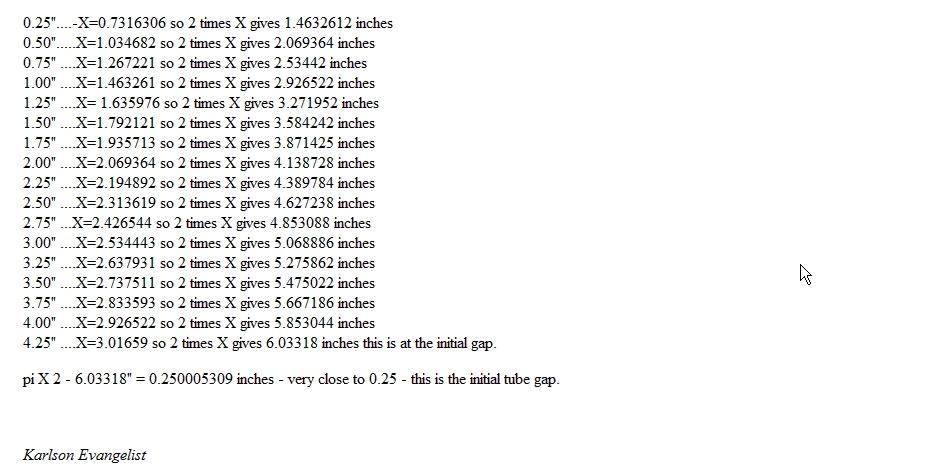

the nine inch tube was an extrapolation by Carl of the 7.25" tubes found in a set of Karlson X15
here's some basic dims for the nine inch tube
Concentric matching/scattering piece
better views of the concentric throat piece
Main tube 1.875" ID x 9.125" long

Observation about those graphs
Sebastian ,
I just noticed something noteworthy about your measurements taken at 30cm height :magnify: ...
They generally show a similarity to the published graph for the 15LB100 in the upper range .... You can see the dip starting just above 400hz to 600hz, followed by an increase closer to 1k, and then a dip just above 1k followed by a bump located right around 1.5k .... Not exact, but there is quite a resemblance .... I had the same impression from my Dayton PA310 in this Karlflex 12, meaning my upper response resembled the published response as if this aperture shape allows the upper frequencies to decouple from the front chamber (while the lower frequencies still continue to benefit from coupling with the front chamber due to the longer wavelengths) .... In other words the amount of front-chamber/front-cone coupling is frequency dependent, or at least that is my theory 😀

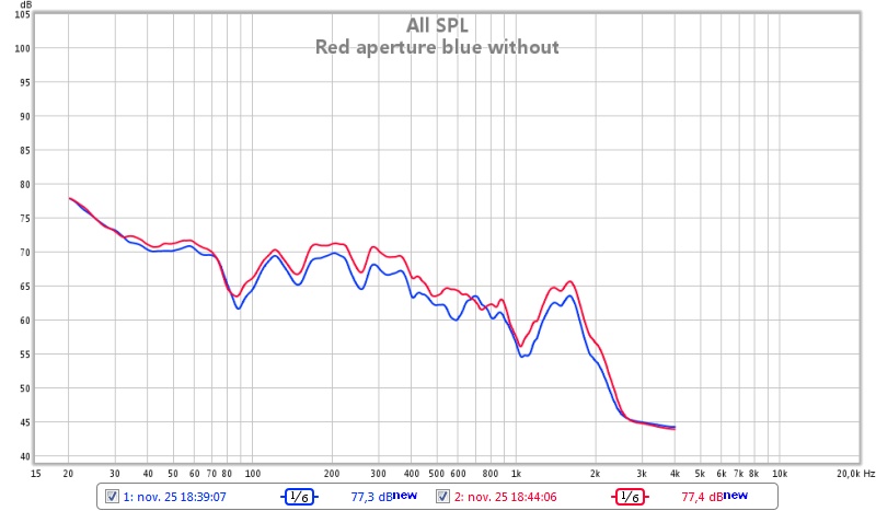

I did a measurement with aperture and thwn without, removing it entirely. Not that much difference 😱
75 x 40 cm from speaker
Aperture(red) gives a little more output and smooth 500-900 hz a bit. Thought the "stub system" would have bigger impact than this?!
