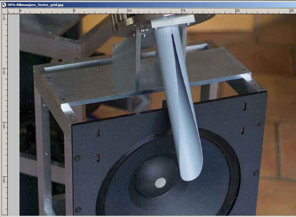

Hi freddi,
You find the wildest things. 🙂
Going by the description on the website, the horn driver has a 2" opening, and that makes the k-tube about 2"O.D. x 14" long.
I tried to scale it in Picture Publisher using a driver opening of about 13.5" as a starting point. There are rulers horizontally and vertically in the screen print, and guide dots on 1" centers. Also, looking closely at the base of the tube, this may be a rolled product?
Hi freddi,

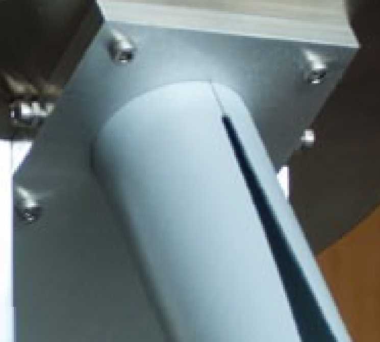

it may well be rolled - interesting machining ability to vary the slots so precisely - - Transylvania Power Company allegedly made a 2" format tube and probably around 11" length - I made that size with 2" pvc but didn't have a 2" driver to properly energize the thing. Seems like it would have narrow dispersion at high frequencies when viewed straight down the tube - there is energy propagated at right angles to the tube's long axis.
imo - K-tube used properly have a very nice sound

Freddi ,
Those audiophile slotted K-tubes from your post #1745 are gorgeous!
I really like the way they are angled downward and long enough to reach down to the level of the driver below it improving coherence, seems like smart design ...
That JBL 2035 looks really good ! More motor strength than an Eminence Kappalite 3015LF-4 , and lower voicecoil inductance per ohm as well !! It is not as strong as your 15" B&C models but still very useful 🙂
I don't believe it uses ferrofluid .... I was considering a swamping resistor across the driver , at least to electrically damp the Selenium near it's resonance to help protect it 🙂 ..
Freddi ,

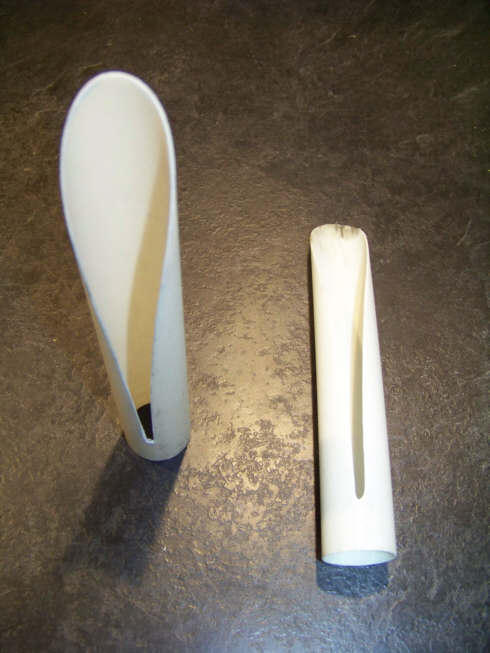

Pictures as promised
I love this driver , but it looks like their decal printer was having a bad day when they made this one😛 (i bought these back in 2010)
and here are a few different horns and a Dayton waveguide or lens along with the cardboard slotted k-tube (which i really like because it sounds great!) .... I tried my best to match the contour of the Transylvania Power Company tubes , but i know it is not quite exactly right , i may try again ...
This tube's cardboard is actually thicker than it looks in the picture, but to stiffen it further i can brush on a glue that will soak into the paper then i would paint them as well ... This was just a fun experiment though and if i really wanted something more permanent i would buy some strong plastic pipe with 1" inner diameter.

great looking K-tube - how did you generate the curve and cut it so precisely? when I made some out of 1" pvc, I kept mucking wih elliipses on a printer to get one which left a 1/8" starting gap and ~5.5" half ellipse length -what glues would make it more rigid/better damped? - I've got a big pair of white EV horns never used - think they want 1.4" driver and are 60x40 - Selenium has made some real good drivers - their slot loaded tweeters were great for the money

Freddi ,
I had a very long piece of this tubing so i cut a few pieces off and went about it trial & error style... I did end up wasting a few 6" lengths before getting the shape of the cut right ... I was just eyeballing it , nothing fancy ...
For glue i was just thinking about thinning out some wood glue and brushing that on a few times til it soaks in ... It would be an experiment ...
I have never tried the Selenium slot loaded tweeters but these compression drivers sure are great ...
I did make some simple 42" tall TL tower cabs loaded with Selenium 8W4P drivers a while back for a friend (after trying those same drivers in a few other cabs yielding unsatisfactory results) i was highly impressed with how well they worked in the TL (QWP) cabinets! 🙂
