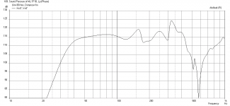

What I am confused by is why hornresp gives me a 2.5 dB peak at 37-38 Hz when akabak just rolls off 🙁.
Don't get me wrong I love that I should be able to get 115 dB flat to 40 and 113 to 35 disregarding corners, just was expecting 117 at 38. On the bright side, it's flatter than expected and has more mid-high bass (60-80) than I thought.

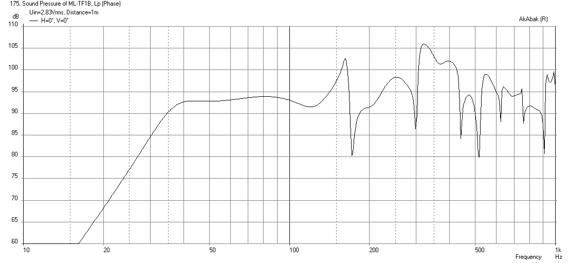

Here is the baseline simulation of the SPL vs freq in 2pi space with no HPF or LPF's applied. Here we can see that location of the 40Hz bass extension and the sharp dips at 180Hz, 210Hz, and 450Hz correspond well to measurement by Sabaspeed:

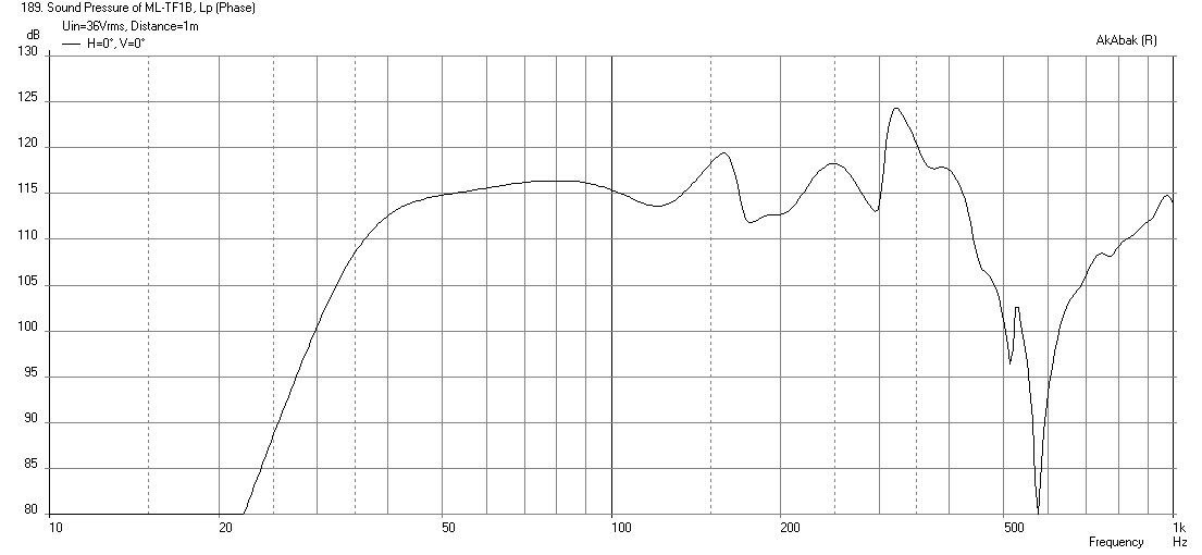

Do you suppose that general hump in response between 320hz and 450hz is the plenum (small bandpass chamber) resonance? I have another version of this ML-TP cab that should shift that resonance down to where it is more beneficial.. Unfortunately Hornresponse doesn't seem to factor-in that additional resonance properly for some reason so it looks like Akabak is the way to go in order to see whether there will be any useful extended midbass response above the of the main pipe's third harmonic ...
Revised script with damping in first half and turn
No, that resonance corresponds to a circa 30 in long 1/4-wave resonance which means it is internal. HR should capture this. I shortened the plenum to 0.5 in and the same 350-450hz bump is still there.

Here is the predicted SPL vs freq at xmax with no low pass filter, only 33Hz HPF:

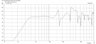

Here is predicted response without damping:
Here is the revised code which fixes typo and adds damping:

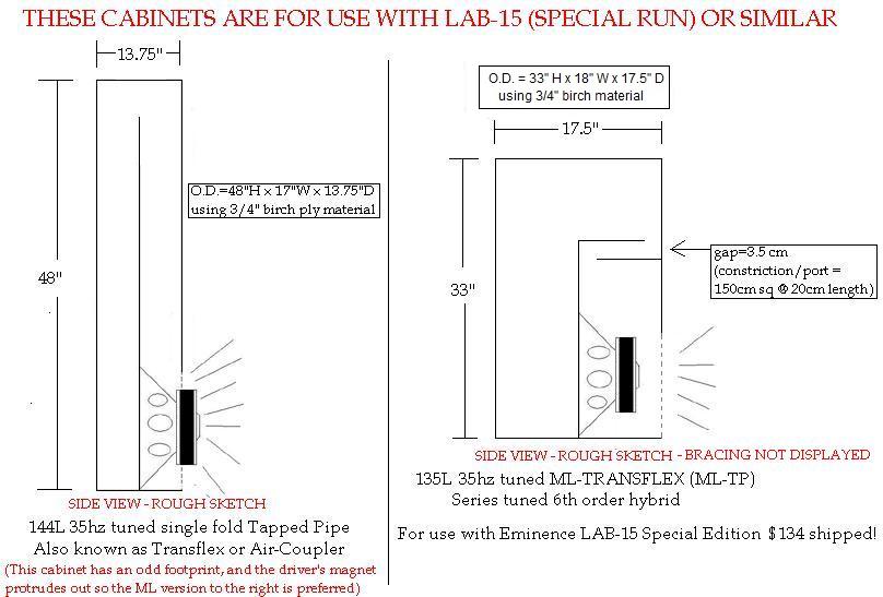

Here is another sketch with some more explanation and details of measurements on the ML-TRANSFLEX for the Eminence 15 (special run) ...
I think i might arrange version 2 of the 50 liter cabinet for the Alpines in this same manner, with the constriction/port placed at the top right of the internal divider/baffle panel ... The cab sims a little better that way, and gives us slightly more path length while only increasing the total cab size by a few liters... This arrangement is also more likely to place any additional bandpass resonance (developed by the small chamber being energized from rear of the cone) closer to where it is needed which will be between the 3rd and 5th harmonic of the box's main pipe resonance...
Some of these numbers seem to contradict each other, is it 33 tall 18 wide (meaning side to side) and 18.75 deep? I believe this would keep the equal volume contour of the pipe intact. Correct me if I'm mistaken, trying to cad it out now.

Is it 33 tall 18 wide (meaning side to side) and 18.75 deep? I believe this would keep the equal volume contour of the pipe intact.
Saba, I see the mistake you are pointing out, good catch.
After some fine tuning of the design i was pleased to see that i could reduce the size to around 135 L (the traditional style TP was 144L), I updated the depth on one set of dimensions in the sketch but neglected to change the other set of dimensions .... I will post a fixed sketch for this Eminence design with the correction ....
The 135 liter dimensions are: 33"H x 18"W x 17.5"D
I really like the way this folding works, efficient and simple 🙂
Ok,
Here is an updated sketch of the 135 liter 35hz ML-Transflex originally in post #103
The dimensions conflict is now fixed 🙂
I plan on posting a more comprehensive collage/sketch complete with more detail such as HR inputs, response graph etc ... Similar to what i posted for the Alpine 40hz ML-Transflex recently... The fold is now arranged the same way on both designs.
Once I have the CAD done to convert this to 3D tell people to PM me if they want the solidworks files, unless you want to restrict rights on the design but this is DIYaudio so I thought I might as well give them away over PM (rather than upload them). I won't be disappearing anytime soon from this forum as I have already learned so much!
It should be well worth the effort! 🙂 and should sound similar to your Alpine box, just bigger and louder!![]()
