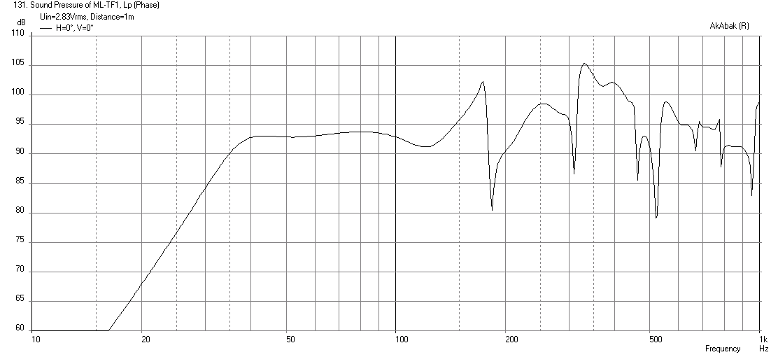

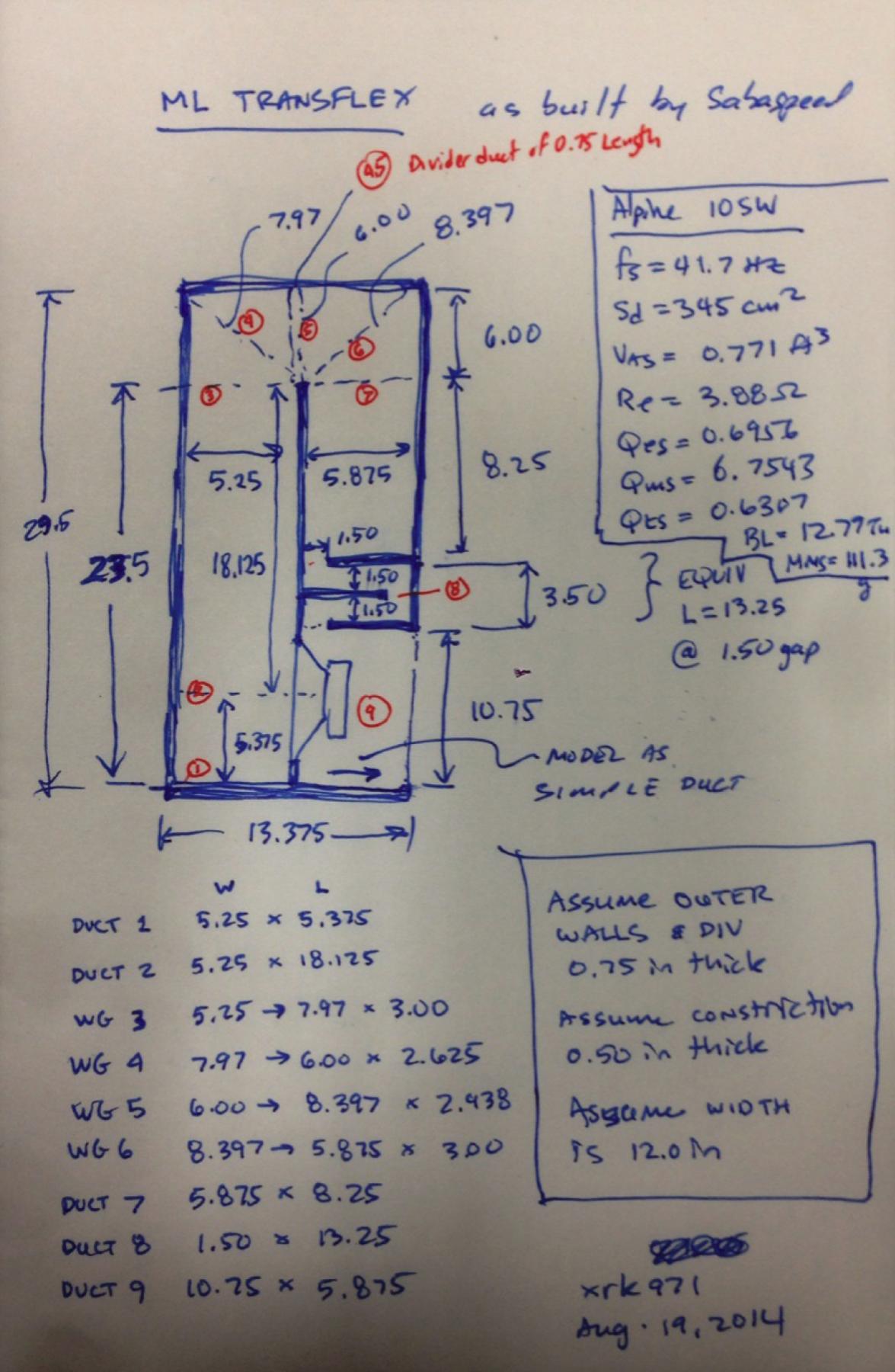

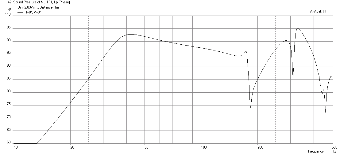

Model of ML-TransFlex in Akabak
Well after some detective math work and using assumptions of 0.75 in thick for exterior walls and divider, and 0.5in thick for constrictor channel walls, I came up with the dimensions shown in the attached flow-paths-plan used for the model.
The ML-TransFlex as built and using the Alpine 10SW-4 appears to have a saddle in the response when looking at it in 2pi space. However once you add some boundaries, for example at 70 in away from a back wall, it flattens the response nicely. If corner loading 20in away from side wall (45 deg aimed out), you get a flattened but tilted response.

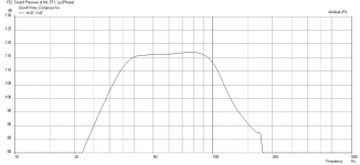

Here is the baseline simulation of the SPL vs freq in 2pi space with no HPF or LPF's applied. Here we can see that location of the 40Hz bass extension and the sharp dips at 180Hz, 210Hz, and 450Hz correspond well to measurement by Sabaspeed:

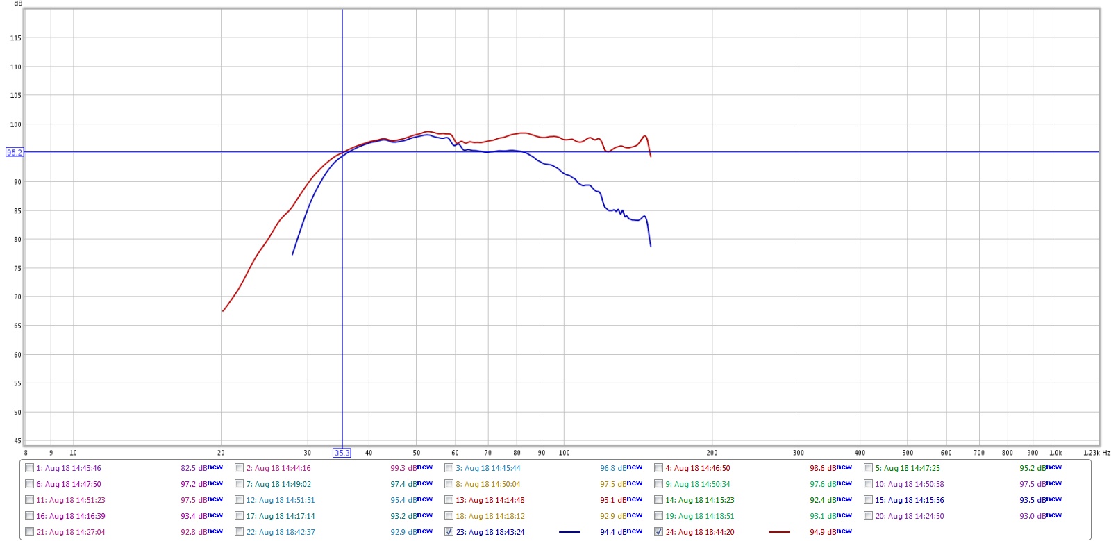

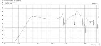

Here is Sabaspeed's measurement (blue is without EQ):

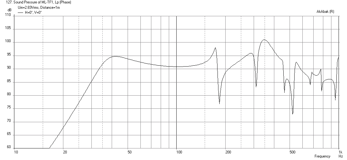

Here is the same but 70 in away from a back wall (sub on wall with mouth centerline 6 in above floor):
Here is response when placed in corner with mouth 20in away from sidewalls aimed 45 deg out:
We can see that this tilt (-10dB from 40Hz to 100Hz) and the little upward peak at the 170Hz point agrees nicely with the data provided by Sabaspeed.

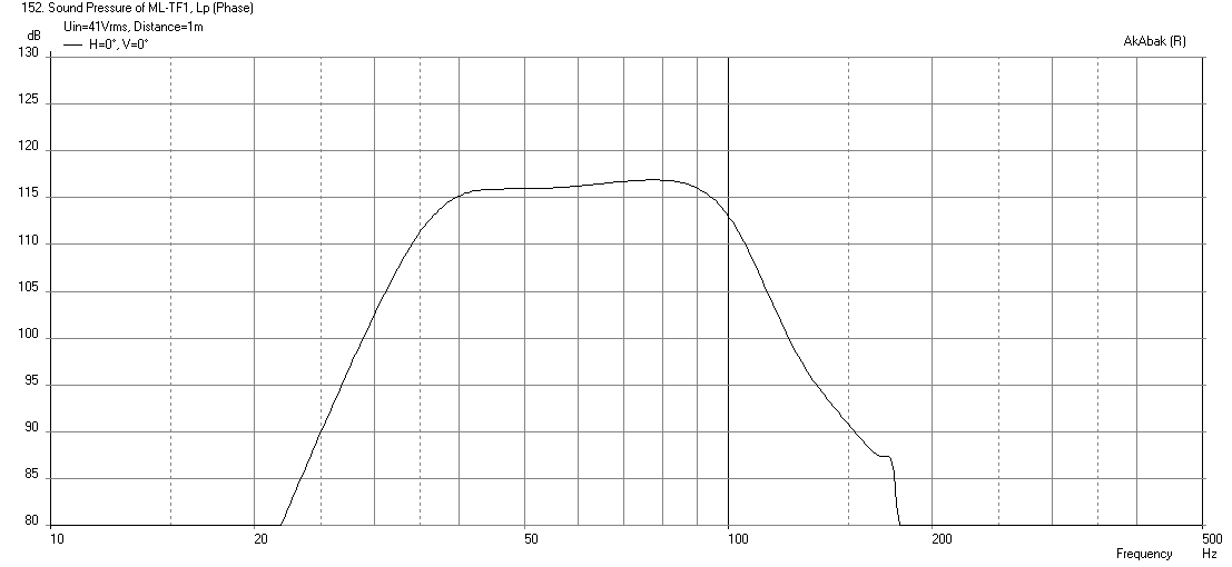

Since the 70in case gives a nice flat and level response, I will use that to see what the max SPL can be. Here is the cone displacement at xmax with a 33Hz -24dB HPF and 100Hz -48dB LPF - it is good for about 117dB at 41volts drive:

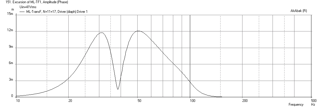

Here is corresponding response at xmax:

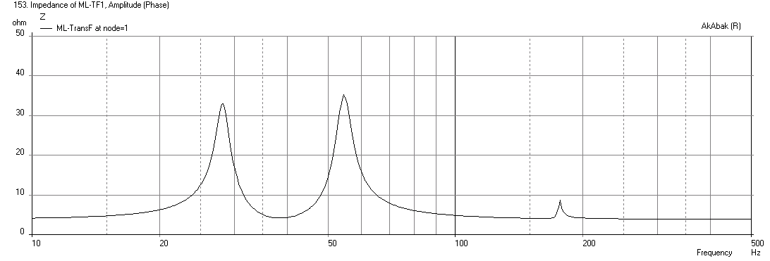

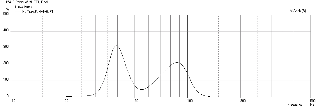

Here is the electrical power required (a little over 300 watts):

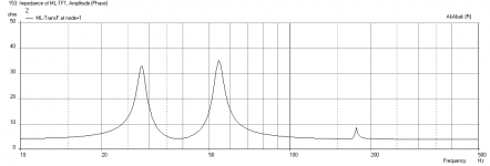

Here is the electrical impedance:
