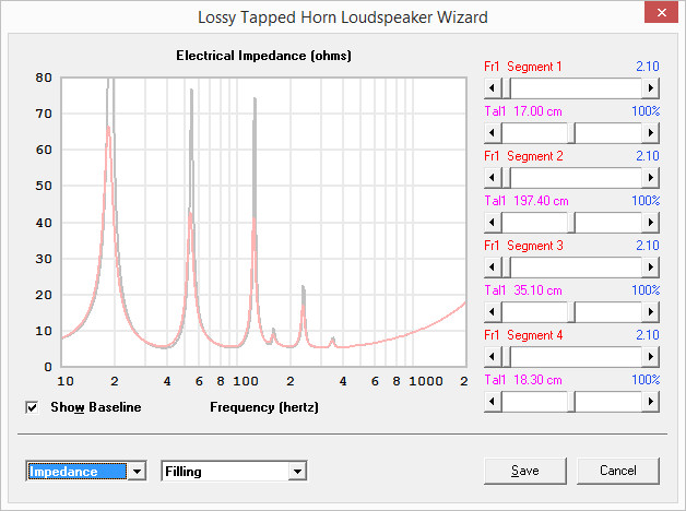

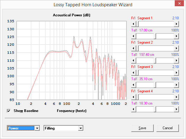

Well, here's the results. I basically fiddled with the filling until I got the best approximation to the measured results for the two of the three major peaks in the impedance response. The corresponding FR curve shows that the passband has been smoothed a little and there's a projected loss of just under 1dB in the middle of the passband.
Perhaps this might be a good enough means of more closely approximating what the real-world results might be like if you build a properly-braced TH following a HornResp model. I emphasize PROPERLY-BRACED. If your build is not properly braced and the panels are resonating like drums within your TH's passband rather than having a more "broadband" effect, then you're on your own, LOL.
Of interest is the first response peak in the impedance curve. Real-world measurements have placed this of course lower in amplitude but interestingly enough higher in frequency than the HornResp model. As this peak is noticeably impacted by even a pinhole leak around the driver, I think this variation is due to both box losses and driver losses, primarily due to the driver's suspension, which is lossy linen cloth for most pro-audio drivers. If this is true, it may be possible to model the impact on the impedance curve and therefore the FR curve by inserting a very lossy port between the throat and rear chambers in the model.
Finally, while examining the measured impedance curve of my POC3, I didn't see any evidence that HornResp's use of Le in its model was incorrect - the measured impedance curve at higher frequencies was a near match for the one predicted by HornResp.

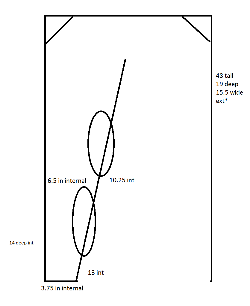

Hey guys for those that are interested. This is my (very) rough sketch of the Dual 12 TH I'm most likely going to build with the sws12. Just going to determine the angle required to get the distances and set the baffle length to set the path length. What negative effects will I get from slightly pinching the air near the top of the cabinet (between the top panel and the baffle pieces) I believe that the model assumes constant expansion but in order to get a little more path length I was thinking that I would just make the gap a little smaller (still leaving it ~4-5 inches tall gap-wise) to get the path length up to 186 cm (L23).
Hmm, what you've drawn doesn't match up with the HR alignment, i.e. you show a straight divider board, but your sim has [3] different flare rates, so to correct it to the drawing requires using the LW to auto correct the S2, S3 expansions by clicking on the [2] 'manual' options, then 'save'.
GM
GM

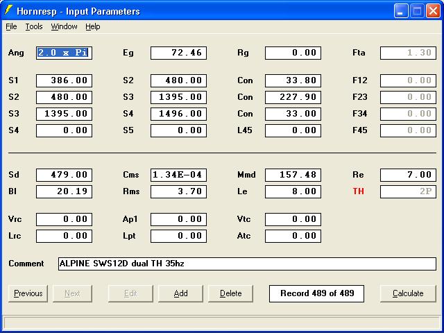

Saba made a good choice in alignments though, 2 of those SWS12D drivers look really nice in a tapped horn with the drivers spanned ...Mutiple expansion rates are not necessary, one rate of expansion works fine ..... I was able to make it work well in about 265 liters ... Peaks at just 1/2 decibel short of 130 @ 41hz and is only a few db down at 35hz ...

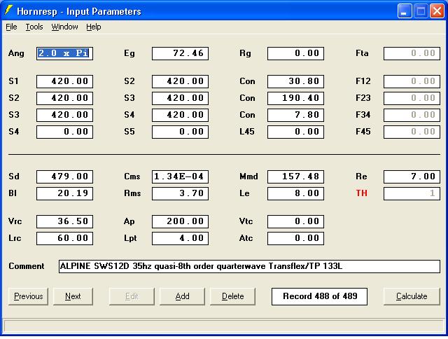

Here is the set of inputs that i ended up with when trying out this alignment to see if it had potential for these Alpines ...
It ends up being very close to this quasi-8th order box i was working on , same size package , one just uses expansion and the other doesn't (it uses and additional chamber + port instead , will post sketch and inputs for that box here in a bit) ...

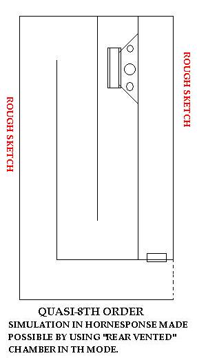

8TH ORDER SIMULATABLE IN HR?!?! FASCINATING!
Ok guys , what do you make of this? More reasonably weird & wacky stuff that HR is capable of simulating for us ..
I know the inputs and sketch could use a lot of refinement, and perhaps there is a better fold for this but i just wanted to post these for the sake of discussion and for the novelty of the concept .... This box has equal output to a tapped horn (of the same size & tuning ) with expansion, but there is no expansion in this pipe whatsoever, the gain (over a standard tapped pipe) is generated from the way the added chamber interacts with the rest of the system ....... Could be a good option for someone who wants Tapped Horn performance out of an easy build that has the simplicity of nothing but a few 90 degree angles! 😀
If i were to use a constriction like a port or a vent of some sort on the main pipe (the one tuned to the fundamental)placed somewhere before the tap it could allow us to shorten the path length a bit and could generate an additional resonance as well ... Configured in this way it could be considered a 10th order box!
