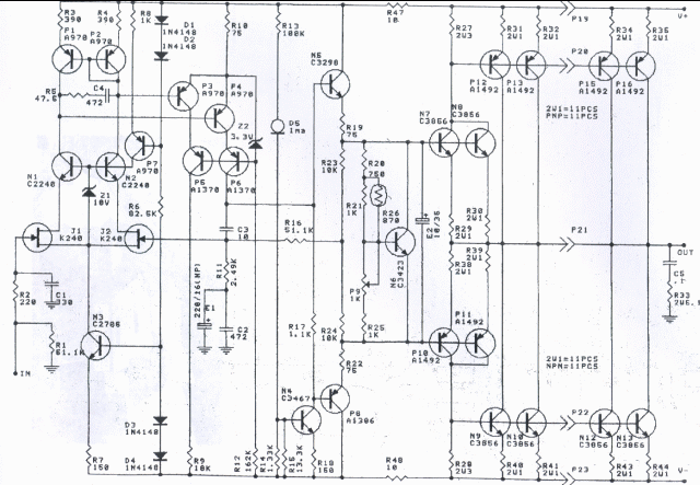

who knows what of differences are there, vs. origin?
attached supposedly R2.5 schematic I collected from somewhere
that's far enough from efficient simplicity of anything Pass drew

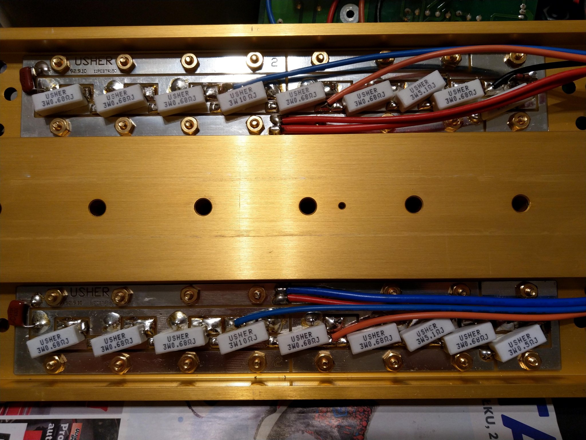

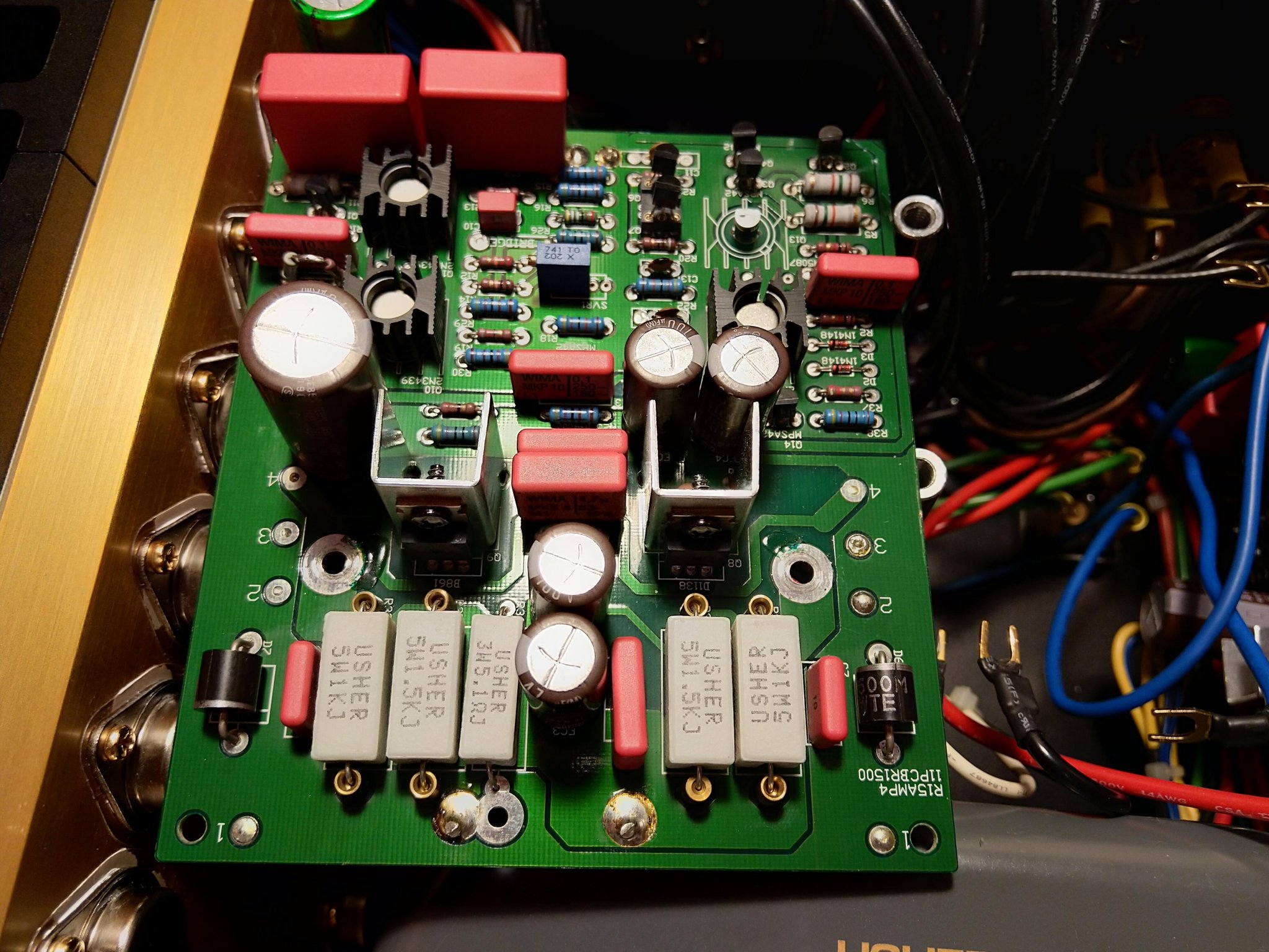

The Usher R-2.5 is a completely different amplifier than the R-1.5, which is practically a 100% replica of the cascode based Threshold Stasis 2 (3). I talked to a guy on the Polish forum who has such a power amplifier and he drew a diagram of the final stage and confirmed that it was Stasis 2 (3) on cascodes and not, as many forum threads say, that it is S300, the values of emitter resistors also prove it. He disassembled it almost into parts and made a lot of modifications to the factory version. I will attach the photos he shared and you can see everything perfectly on them. For him, the layout on the cascades is not as clear as the traditional one, and I'm joining it. I know at the moment that it sounds tragic.
well, what can I say ...... except that I believe Pa did learn trick or two in years after Stasis 2
present FE is certainly cleaner than that one of Yore
anyway, I'm way above my level there, really never played extensively with these exact Front Ends, so can't say that I'm familiar with most critical points
probably sole person able to give you proper comment (regarding old FE vs. new one) is Pa himself

Unfortunately, the schematic for Usher R-1.5 is not available even by calling Usher, as it would not exist. Nobody has been able to obtain it so far. As I wrote earlier, when drawing a schematic from a PCB, it coincides with the one from Stasis 2 (3).
