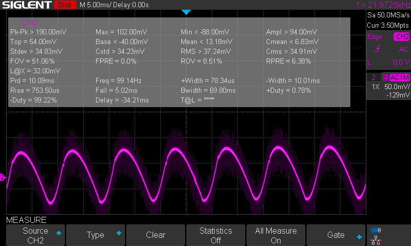

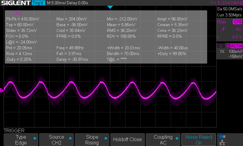

I've had a little bit of time to investigate where this hum is coming from and I noticed something quite strange; it seems to be heat related. I turn the amp on and there is no hum through the speakers, but after about a hour or so it becomes quite noticeable from say 3 meters away.

Looking at the PSU the left and the right rails look like this:
Guess the hum is coming from the PSU.

The plots above are taken from the output of the PSU.
