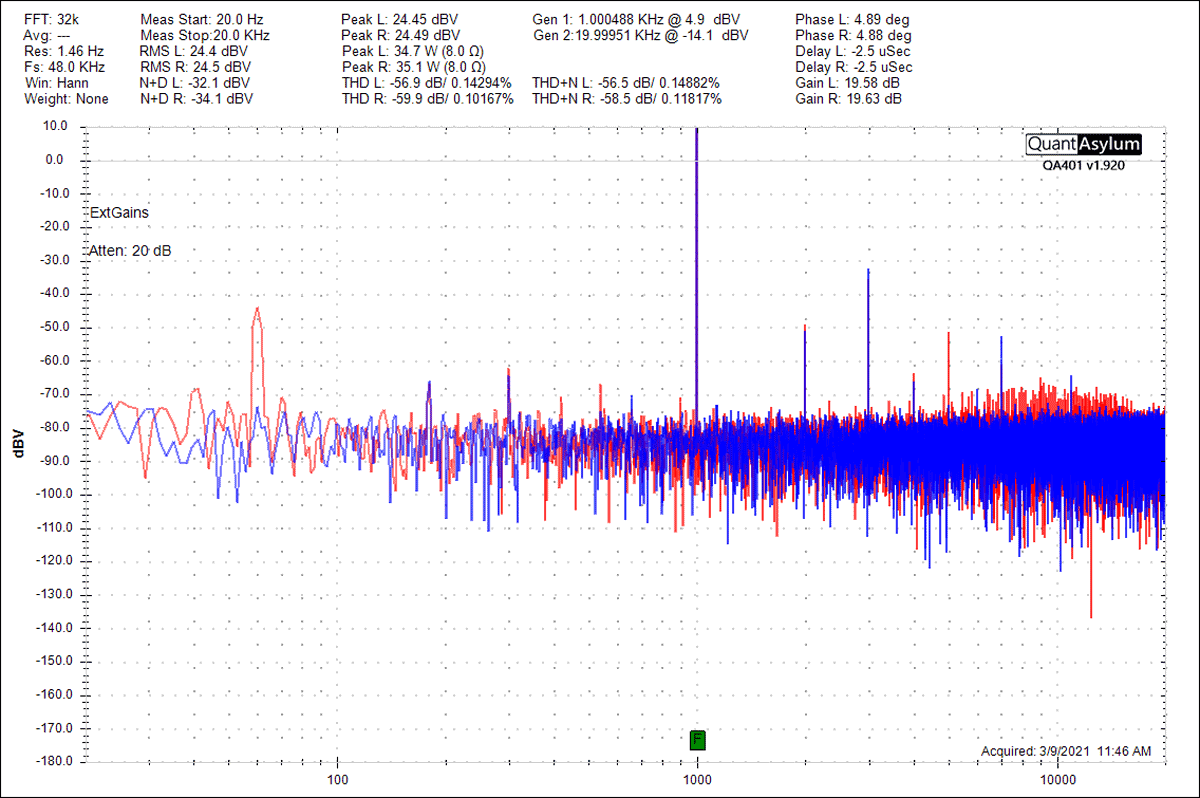

Bias at about 335mA gives about 50C - ambient temp 19C
Attached is QA401 output. Can't go higher using just the QA401 or output clips (401 limitation) and was too lazy to connect preamp.
Am listening to the amp with DAC connected directly and it sounds great. Plus it will heat my basement...
Thanks to Nelson and ZM for making this happen. It was less stressful than the Sony VFET build. Am now waiting for the impending SIT amp and have another set of SITs ordered from Watanabe San.
I believe it measures better than shown on QA screen
probably operator issue
I mean, better it is ......... 🙂
is that 1W@8R , or?
and, it could be clearer if you show just one channel on screen
ediedit- always keep things at -10dbfs ......... you'll see difference

From your measurements, that ends up being around 98 watts heat dissipation per heatsink with your 35VDC rails.
