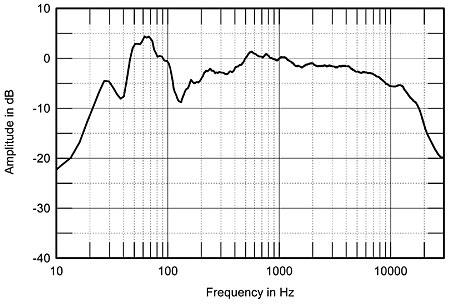

Below is a frequency response plot of a speaker, a good one. Which is not important, they ALL do this kind of thing. The measurement was taken from a review, and was done in an anechoic space, so you see just the speaker not the room.

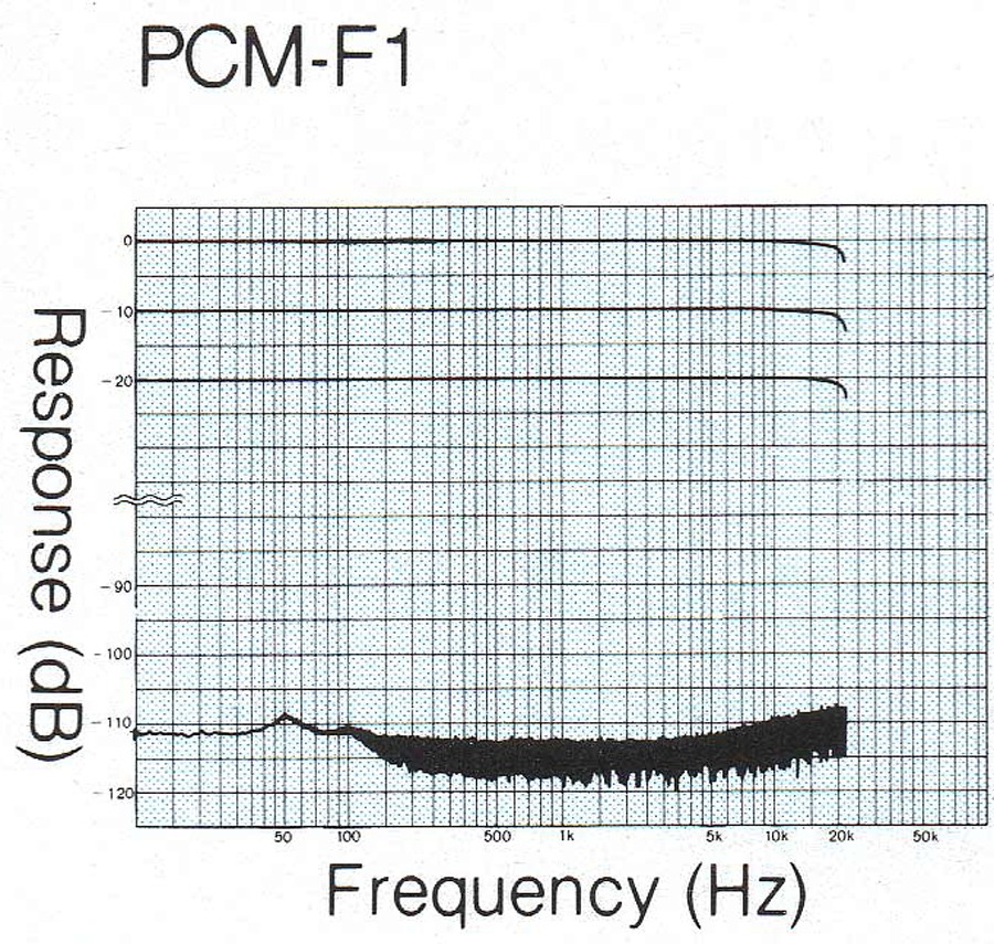

Then next graph is the frequency response of a very old pro-sumer PCM recording device from the early 1980s, the PCM-F1 (that's the noise at the bottom).

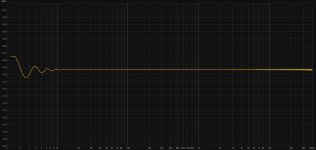

And finally, a FR graph of a mid 2010s vintage ADC/DAC - a Motu 4Pre - connected output to input via analog I/O. Note the very much magnified scale.
Now, granted, this is "only" frequency response, though that is the single most audible parameter. Everybody can hear it. But I can easily show any other paramter you like, and the speaker will be the worst offender...right up until we look at the speaker in a room.
Now...do we really need to elevate preamps (which BTW, have about as little modification as a DAC) and DAC to the "magic" device that fixes everything?
If anyone has evidence to the contrary, please post it here.
