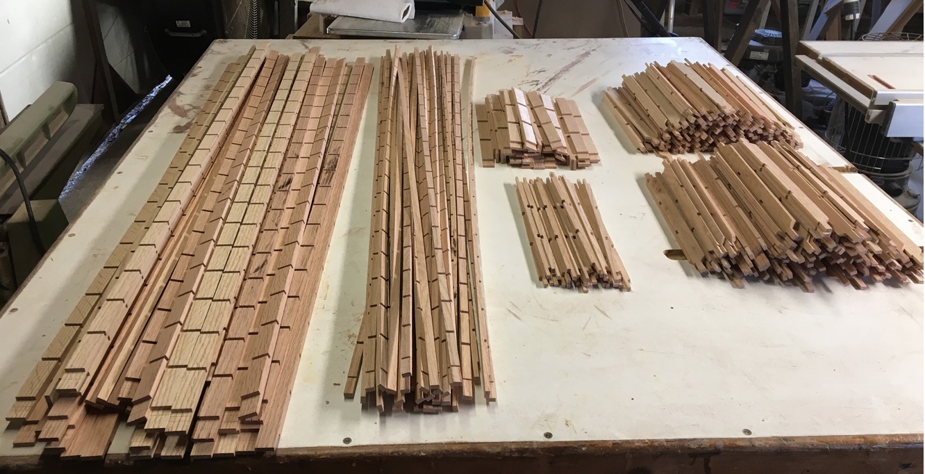

Hello again Jesper,
I chose red oak for the speaker frame and stator details because it's readily available and it matches the AA oak plywood used for the center portion of the baffle (where the woofer cutout is). AA plywood is generally available in either birch or red oak, so I opted for red oak.
A synthetic material cut on a CNC mill would give the best accuracy but plastic isn't as aesthetically appealing as wood. And I believe my stator design gives very accurate results by optimizing tolerances.
Generally; even a cheap table saw will give repeatable cuts within 1/64" and my Delta cabinet saw does substantially better.
When designing a wood stator; it's important to make it rigid and flat in the horizontal direction, flexible in the vertical direction, and make the tolerances go the right way.
The attached photo shows the stator details for eight speakers.
On the left; the slotted vertical side rails and center supports are purposely flexible so that when the stators are mated together; adhesion to the urethane foam tape spacers is sufficient to restrain them in parallel along their entire 48"
On the left; the horizontal wire supports are quite rigid across their 12" width and perfectly flat on edge, where they contact the wires. I verified flatness using a my table saw bed for reference-- I couldn't slide a 0.001" feeler gauge between them and the saw table. Had any not been perfectly flat on edge; I would have placed a sheet of sandpaper on the saw table and block-sand them flat.
The joints where the horizontal wire support slats insert into slots in the vertical rails are priority toleranced @ +.000 / -.015" rather than an equilateral tolerance. This insures the slat bottoms out to the wires first-- as opposed to possibly bottoming out to the side rail and bridging over the wires. Any error creates a slightly thicker glue-line but that's all.
Prior to gluing up the stators; I pre-fit he details on the saw table and used a feeler gauge of same thickness as the wire diameter to verify a snug or interference fit to the gauges ( i.e...a "no go gauge").
After assembly; the panel is still somewhat flexible in the vertical direction but once it's mounted in the speaker frame, the frame holds is straight in the vertical direction. The panel is nested in the speaker between layers of 1/8" foam rubber gasket tape front and rear. Wood moves normal to the fiber direction with humidity changes; so here there is practically no effect in the dimensions that matter.

Wow Charlie ... thanks for the elaborate detailing of how you achieve good tolerances. I have read it a couple of times and I reckon I can visualize most of the approaches you use to get things straight and good tolerance where it matters. I am thinking that it's a fine bit of design considerations you have done here ;-)
I also appreciate your "final word about using wood": I will let it simmer in my thoughts as I likely will also be using wood for some of my designs (sustainability, "feel") and getting it right in terms of straightness is a key parameter. I am also thinking that if I want to facilitate straightness then one way of doing this could be to cut as you suggest (cut small pieces, eye balling, suitably re-orient) and in between these cuts subject the wood to relevant temperature and humidity changes so as to "provoke" the inner tensions to show up ... Does this make sense to you?
