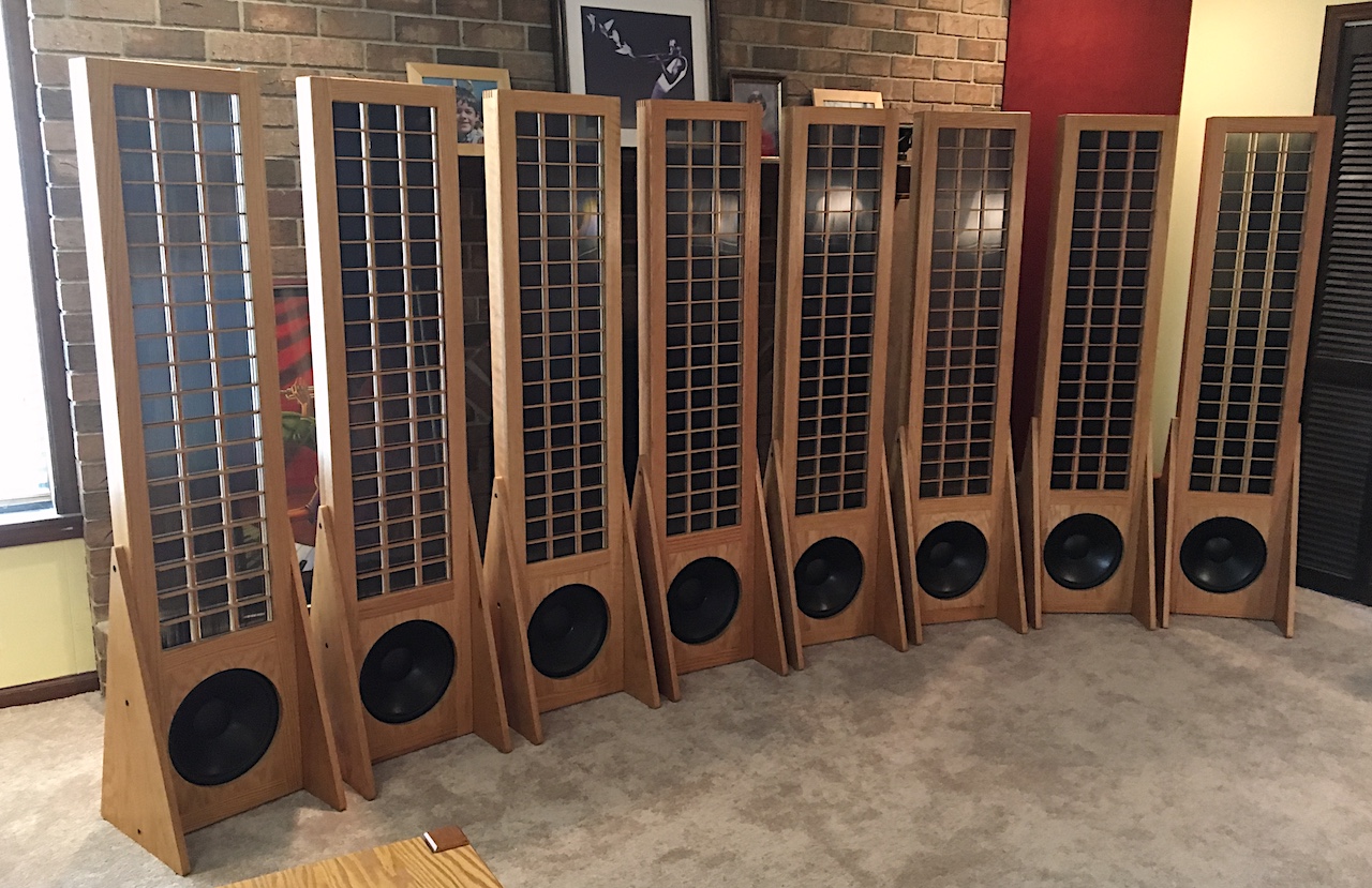

So, when I see the picture of your 8 speakers, and watch the video with an eye for details, I am impressed. Looks like very fine craftsmanship and a lot of work ;-)

Thanks so much for the compliments on my speakers. This project was so much work; it just may be my swan song!

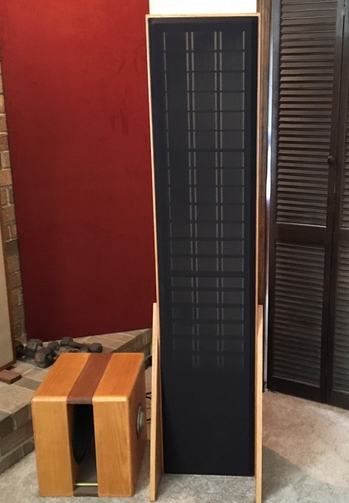

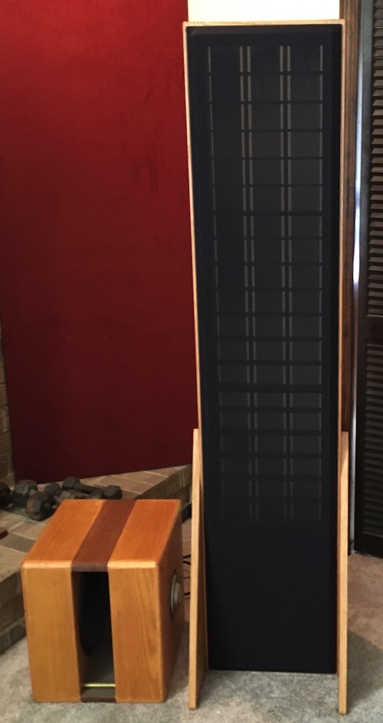

Update 3/23/20:
All four pairs of speakers are fully completed except for the magnetically attached grills, which I started building today.
I spent the weekend sound testing every pair... all play to ridiculous volume with no apparent issues. For a $77 woofer; I'm pretty impressed with the Peerless SLS-- I was concerned it wouldn't be up to the task so I only ordered one pair initially. I should point out that so far I've only sound tested them chopped off at 60Hz and crossing into a pair of Ripol subs with a 24db filter slope. Thus unloaded on the bottom end; they rock pretty good without bottoming out at X-max.
Parts Express and most of the free world doesn't have any burgundy colored grill cloth so I was happy to finally locate some 66" x 36" sections on Ebay. That order arrived today and it's only 54" x 36" so-- another delay.
In the meantime-- here's some more porn for you planar pervs:

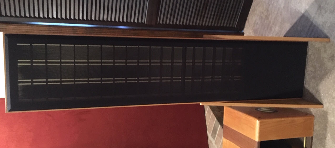

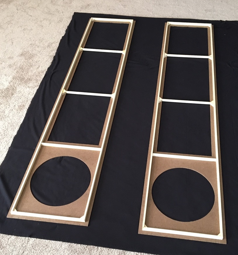

Update 3/26/20:
Having a lot of problems with the grill frames. They looked great the day I built them but they bowed after a couple of days and I'm having to redo them. The first time I used white pine stiffeners on the hardboard frames, the second time I used poplar. Both bowed but the poplar bowed a bit less. So I'm cutting the stiffeners off and bonding new stiffeners on with the frames purposely bowed in the opposite direction, hoping they will bow back to near straight condition. I may end up giving them a week or so to stabilize, then cross cutting slots in the vertical stiffeners to relived the bow, and then gluing on some strips to re-stabilize. They will look nice if I can resolve the bowing issue:

How goes the efforts to control the warping problems? I experience similar issues in the past trying to mount long thin grill frames to ESLs. I tried various schemes to keep them flat but was never completely successful. In the end I wound up removing all the stiffeners, and attached the floppy hardboard with small dots of Velcro evenly spaced along each edge. It sounds a bit….low-tech, but it worked rather well. Later versions I used small neo magnets embedded in the grills to match up with other magnets in the stator frames.
With weather fronts moving through and changing the humidity; what’s flat today might be bowed tomorrow. But I’m hoping the changes I made on the fourth attempt will be the charm.
A cool front moved in yesterday morning (dropping the humidity) and I glued up a set yesterday afternoon using 1/4" x 5/8” poplar stiffeners with straight grain, no knots and cut from a very straight board (was using white pine, which always has some knots). I cut the poplar strips two days earlier and the moisture level in the thin strips should equilibrate quickly-- hopefully to the same level as the mating hardboard. After the glue set; I moved the frames from my work shed into the house and temporarily taped them onto the speakers. I checked them this morning before leaving for work and they were still straight.
I have six magnets in the speaker and six in the grill frame, but the magnets are insufficient to restrain the grills from bowing. I may end up omitting the stiffeners as you suggested if this doesn’t work.

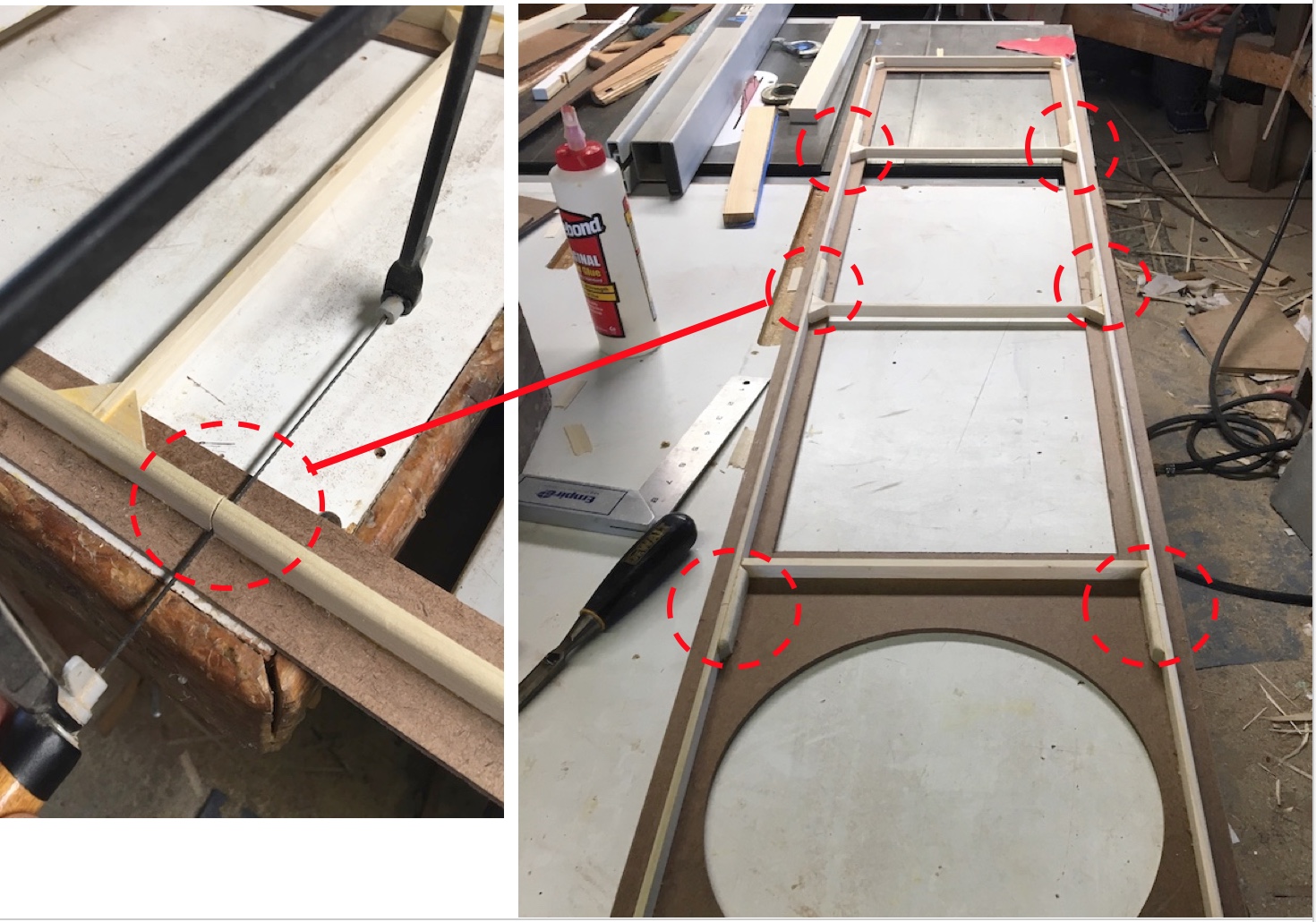

I'm building grills for four pairs of speakers and I've finally figured out a way to not scrap everything I've built and start over with different materials. I had already cut all the hardboard frames and poplar stiffeners.
I've cut off and replaced the stiffeners multiple times trying to find a combination that doesn't bow. Some bow concave and some convex and one even remained relatively flat-- but each time I've replaced the stiffeners it's been a crap shoot on which way and how much they bow-- absolutely maddening.
The fix was relatively simple though... see photos below. I had been replacing the stiffeners and hoping it didn't bow again, but now I now just cut thru the vertical rails at two or three strategic locations to allow the frame to relax and lay flat on my work table, and then I glue patch rail sections over the cuts. Once the frame is painted black and covered with the black grill cloth, you can't even see where I cut & patched the frame rails:

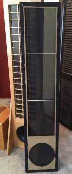

For several years I have made grill frames with aluminum screen door framing from Home Depot, Lowes, others. The Al framing is typically 5/16" thick and 0.75" wide. I use the plastic corner pieces sold next to the framing material. The Al material is straight cut to proper lengths to form the frame.
I glue 0.5" Neo magnets inside the plastic corners and on the front baffle of the speaker I flush mount another set of magnets which are polarized to attract to the magnets in the frame. Now you could veneer or use laminate material to conceal the magnets on the baffle or use the small magnet tape dots sold by Leigh Valley for concealment if you have finished your baffles.
Grill cloth is wrapped around the frames and rubber spline is rolled into the rear channel of the Al framing material. The spline roller sold with the framing material aids in working the spline into the channel. Typically, I use cloth cut 3-4 inches longer/wider than the frame size and trim the excess on the rear of the frame once done.

My previous post about resolving the bow issue on my speaker grills was premature and totally wrong. A recent weather/humidity change bowed the frames yet again.
I used full-face hardboard frames with poplar stiffeners to cover and hide the light-colored speaker baffle, so it doesn’t show thru the grill cloth. And I painted the grill frames black to match the grill cloth.
The bowing occurred because the poplar stiffeners and hardwood frame expand/contract differently with changes in humidity. The poplar (or any other natural wood) moves very little in the fiber direction but quite a lot in the cross-fiber direction. Whereas; the manufactured hardboard with randomly oriented short fibers probably moves about the same in all directions.
So; I cut off the poplar stiffeners and replaced them with stiffeners cut from the same hardboard material as the frame. The frame width is small enough that the short horizontal poplar stiffeners aren’t a problem, so I left those on.
It would seem that; mating details cut from the same material would have exactly matching expansion/contraction and NO bowing would occur. However; a smaller amount of bowing still occurs with humidity changes. Perhaps moisture is absorbed faster thru the cut edges than the faces-- in which case; the narrow stiffeners, having a higher percentage of edge area, would absorb moisture faster than the wider frame, and initial bowing would occur until both pieces fully equilibrate.
Even with some bowing still occurring; the grill frame is now more flexible with the hardboard stiffeners, and the (6) magnets easily pull it flat to the speaker face.
Finally; problem solved 😊
