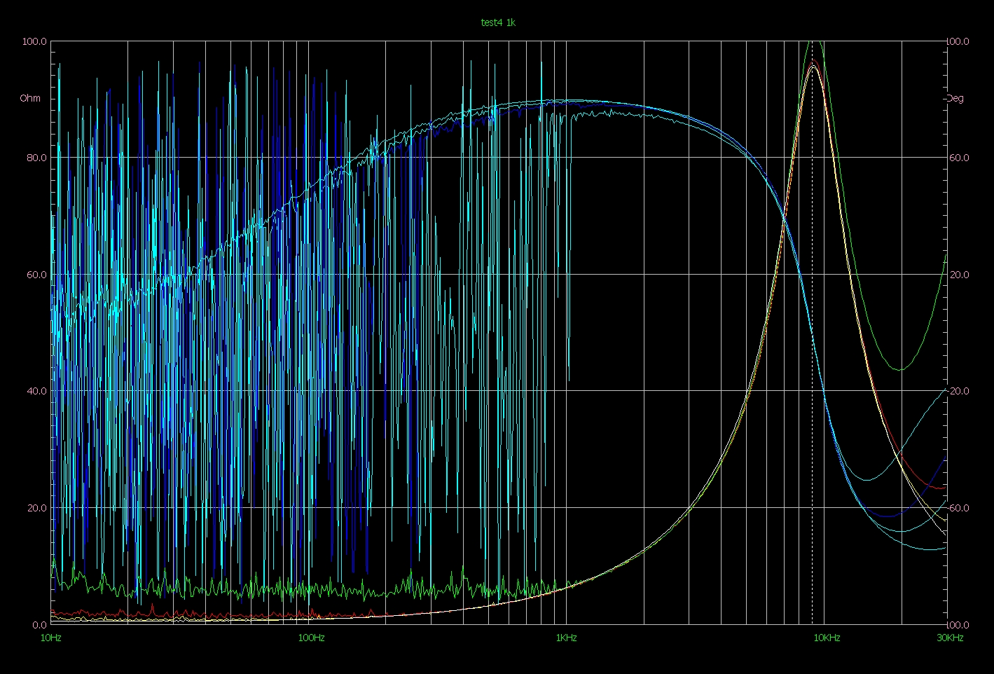

Meanwhile here is one more screenshot of a run of four tests using the original porgram.
I used a 1k,4.7k, 10k and 39k reference resistors in these tests.
With the 1K it did very well.
The 4.7k was alright but you can see noise starting to be introduced into the data at the lower frequency's.
This is from the higher resistance causing too low of a signal to be sampled as it was very near my noise floor of about -100db to -108db at -89db and the impedance of my test part is below 1ohm in this range.
As you can see this just got worse as I tried the 10k (red) and 39k resistors(green).
The peaks stayed generally about the same within 1ohm to .5 ohm of each other except for the 39k resistor test.
But the main part of the slope was the nearly same for all of the tests.
