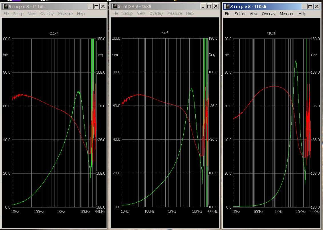

The biggest issue I am having right now is inconsistencies using different resister values.
I been trying different sound cards as well in different modes aswell and I will have to re do all of those test in now that I think that I have found the source of the errors.
The question is why!!!?
I can use different values of reference resistors using VA and RLCMeter they both come up with basically the same values.
If not right on exactly, between the two programs.
Here is a screen shot of the curves from three tests using 100,220 and 1000 ohm values.
They are of the very same components on the very same machine using a Creative X-FI Ellite Pro sound card.
AT the end of the curve the errors are of the the sample rate must not have been set properly at 96Khz and the sweep was to be to 44Khz.
Monitoring the signal on my scope it ended at 23Khz.
The reason I did a screenshot instead of overlaying the curves is some how the program got corrupted and would not allow me to do so and lock up the machine.
This test was using a 2.2Ghz P4 dell and I didn't have these problems using a 933Mhz P3 on the earlier tests.
Just a few inconsistencies.
I switched machines because VA was to sluggish using the slower machine although it did work.
It is still sluggish on this one but workable.
I would be doing all of this on my new FX-6300 at 4.8Ghz but it is currently loaded with Win7 and none of my sound cards are compatible with Win7.
So, I am currently doing a clean re-install of everything on a different smaller drive so that it doesn't take so long to do when I switch to a different sound card and have to reload the OS again (since Creative can be a real PIA some times).
More on this later!!!!

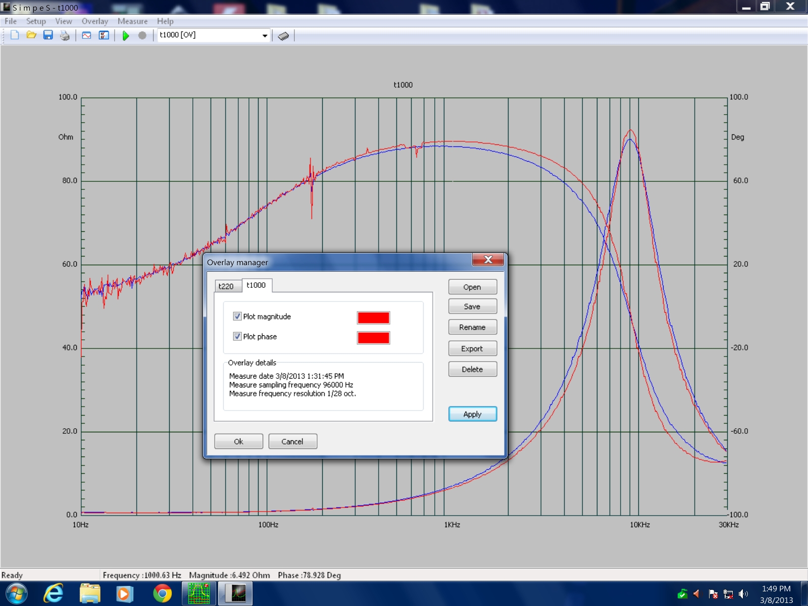

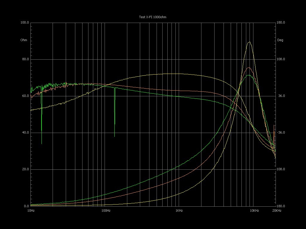

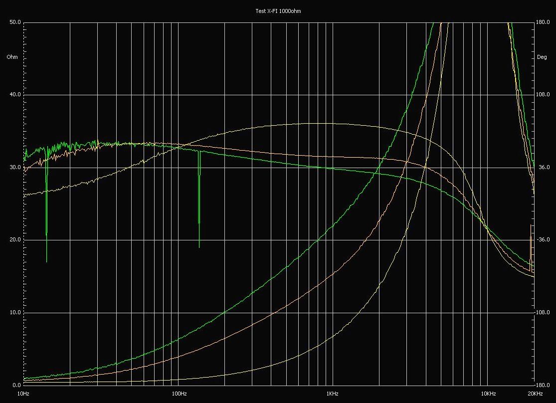

I just did the retest of the above and the results are the same.
Also I had learned how to use the overlay system (sorta).
Here are a couple of overlayed screenshots and the data of my three test's for anyone who may be interested in taking a closer look at the data using the program.
The test are with100,220 and 1000 ohm reference resistors using a 26 turn winding (equivalent to a 6V winding) on a Antek AS-1206 transformer core with the magnetic and electrostatic shields removed.
Off hand it seems that the 1000 ohm resistor gives the closest results to VA and the RLCMeter programs that I have been using.
Although, I have yet to verify this as I just did this test.
It is the one with the highest peak as well, and, The rest follow suit with a lower peak for a lower reference resistor.
I will also try all of my other sound cards as well and see how much of a difference I find if any as I don't have to change anything but the resistors and plug them in and go, all else is Plug-N-Play.
I will report back on my results later.
enjoy!!
jer 🙂

I used the older original version of SimpleS with a 220ohm and 1000ohm reference resistors and the results between the two are very close!!!
Much closer than yesterdays tests!!!!!
Go figure?!!!!!
Anyhow the impedance measurements with the 1Kohm were much closer to the predicted inductance made by LMSBridge and the 220ohm values were not very far off as well as displayed in the graph.
And for some reason LMSBridge and VA agree with each other on this machine when VA is cooperating.
Go figure?!!!!!

For instance the on board sound chip of the Compaq 933Mhz P3 is a AD1885 and it produced the same results as my higher quality PSC706 Phlilips sound card.
And then when I popped the X-FI card into the very same machine the results were very different and was when I discovered the huge difference using assorted reference resistors.
Thinking it was a driver conflict I started doing fresh installs of the OS as well.
Here is the Overlay plot of when I discovered this the two smaller Yellow curves is the AD1885 (jagged one) and the PSC706 card (smooth yellow one) and the X-Fi card as the red trace and one orange trace.
Every thing else was the same except for swapping the cards and maybe a higher sample rate on the X-FI card at 96Khz.
I don't remember now exactly what sample rates I used on each of them but I think it was 48Khz expcept for the X-FI.
I should have wrote down the details of this graph as there are four tests on it.
I think two of them were with the X-FI card with two different reference resistors.
At this time I was stunned at the results and then still learning how the overlay system in the program works.
