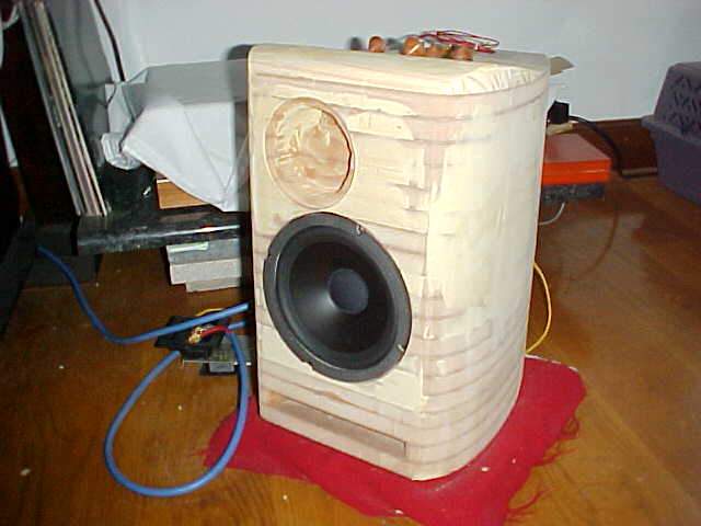

I'm right now in the process of building one reflex 15 lts box with a similar slicing method, but with horizontal scheme. I built a template and then spent hours with my router as a saw. The slices are not perfect but good enough to use some wood filling and sanding and reach a smooth finish. After that a veneer will come.
Yes, it takes a loooooooot of time.

I built/ am building a pair of cabinets from 27 layers of 1/2 inch finnish birch. I went ahead and made a jig to router out each individual piece... it was brutal! These cabinets are taking forever to complete so I'm going to offer some advice. Unless you have a lot of time on your hands take your wood to someone who has a CNC router and be done with the most time consuming part Have them drill holes for dowels while they're at it. Aligning all the pieces without some form of registration is really difficult and the dowels will solve that problem.

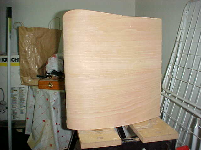

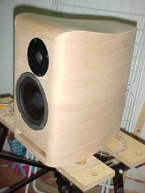

I know you are not talking about mine, but that's exactly what I did, actually I used four different layers with bracing based on the very same layer. In the picture it can't be seen, but there are curves sides, and curved top.
The drivers are the peerless 811815 as tweeter, and the beyma 6b30/P. I have tried with a 1st order and sound good, but the final xover has to be defined (active)
Finish is varnish (poriuretano) and I promise I'll even more send pictures when finished.

Very Very Cool
Raka,
That is a very cool shape you've come up with.. Obviously, you have done your homework on internal standing waves and cabinet reflection. So, what kind of veneer did you use, it looks similar to like maple.
I though you had used multiple laminations on the sidewalls to get this shape. However I see that you have built the cabinet in wood layers, you must have given you router a real work out. So are these layer Hardwood, Plywood or MDF.
The finish is on I have not heard of, I guess the do not sell in the US. One of my favorite finishes is at http://www.waterlox.com/productsList.cfm it's a Tung oil and varnish, it very nice.
