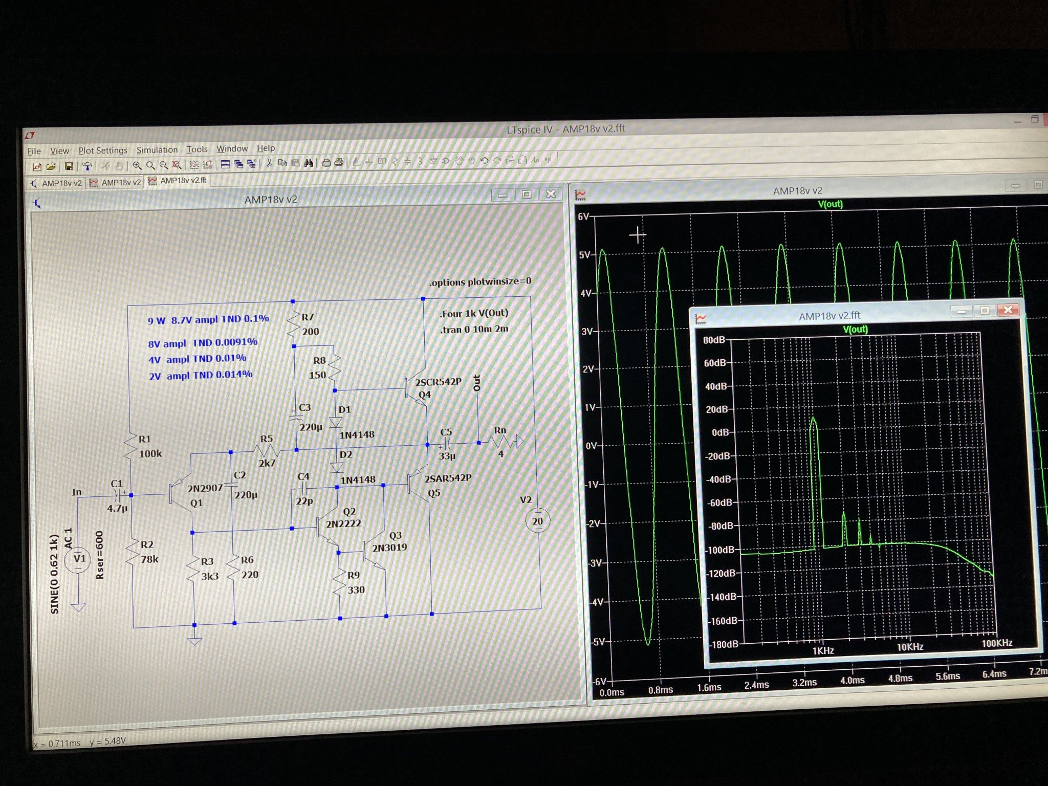

New simple amplifier
It is from a RCA application note.
It is a rather regular quasi amplifier, except for the unusual overload protection based on the 4.7V zener, and the singleton-based input, despite the symetrical supplies
I did a similar power supply during the layout, I did not return to the unipolar circuit, as it was more elegant. Modern 15-25 Amp transistors can be protected with a conventional fuse and at the same time get rid of speaker protection circuits. In the 70s, the analysis and measurement tools available now were not often used, and Google was just a good library with manual search, hence the RCA reference.

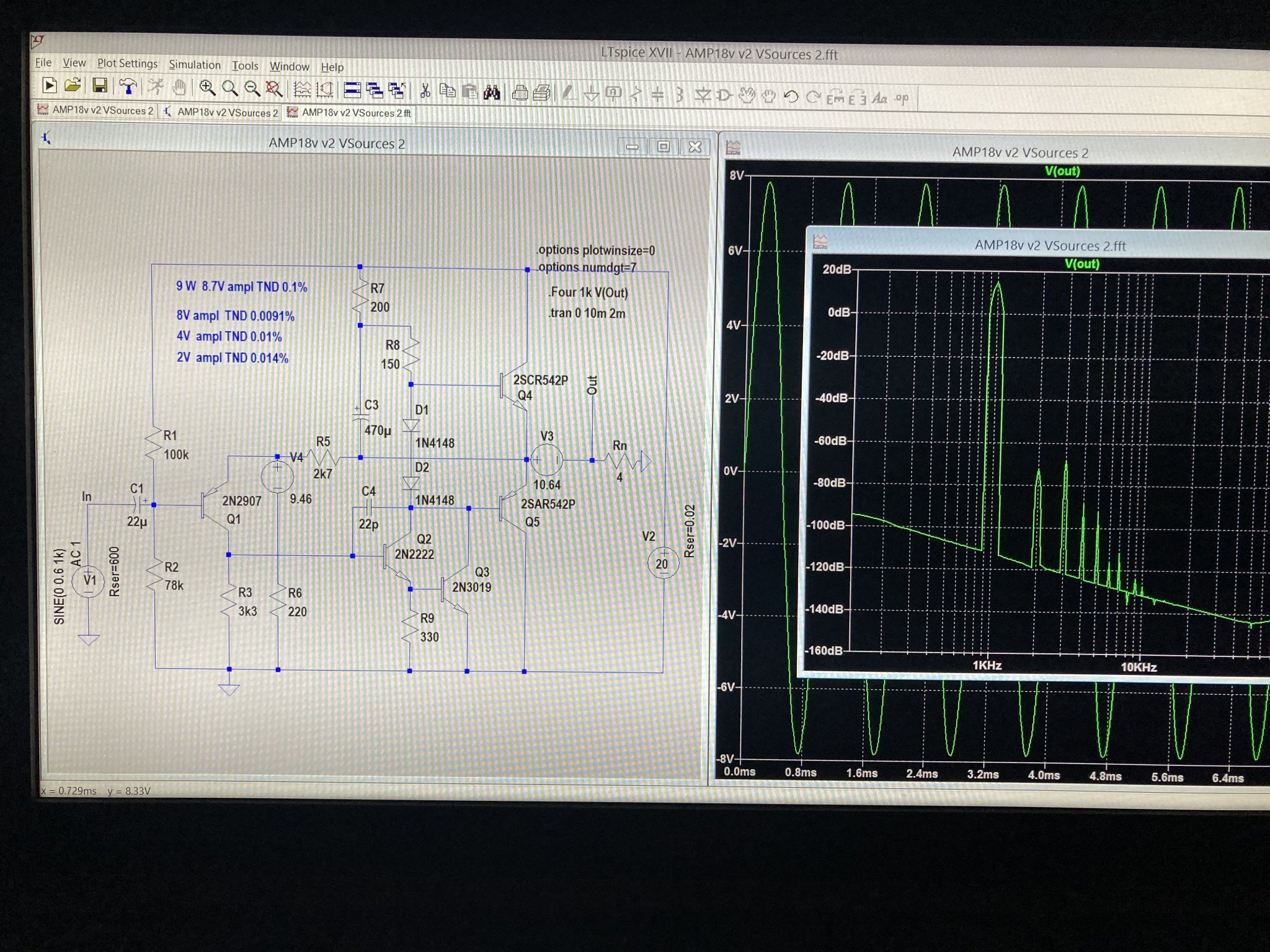

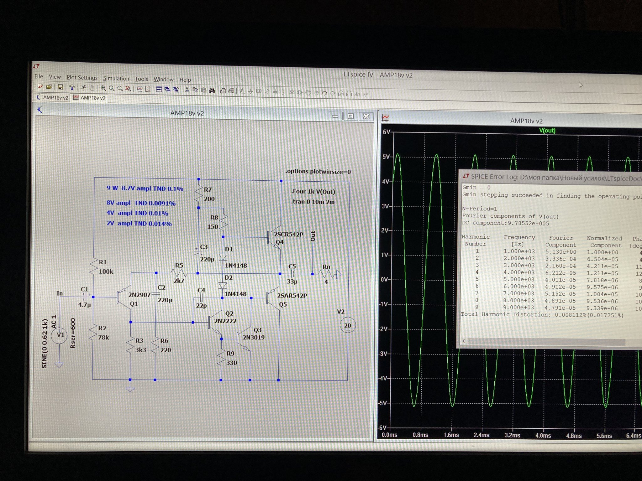

It turned out faster 🙂 Yes, thank you, I understand your idea. At high levels, it seems that you need to additionally edit these sources. Now it is easier to consider the forest of harmonics. 🙂. And edit. Although in general for a 5-transistor amplifier, this is very, very good, TND 0.0082% at 8V amplitude. Moreover, at 8 ohms it will be twice as good as 0.0037%. I'm thinking of collecting for myself. Everything for this is already ready , except the amplifier itself . I don't know your name. Very grateful. That was a problem.
Please don't take this the wrong way but you ltspice directive for your distortion analysis looks off. pm me and I'll send you an example to improve the results.
Your rising noise floor is also an issue. You need to short out long time constant caps for the simulation or only start the simulation after the caps are charged. In other words drop cycles until they are charged. You can also use the initial value directive to set components to there charged state.

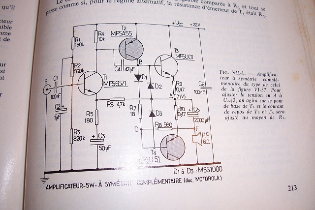

Schemes from France,
Japan, Russia, Brazil.
