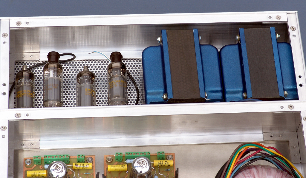

can the divider can be removed for drilling on the split chassis boxes (split x & split y)?
Absolutely. All the pieces connected with our corner brackets so none are permanently tied/welded together. The boxes are completely disassembled and shipped flat. You can even remove the brackets and slide the divider in and out once the rest of the box is assembled - with the top and bottom removed of course.

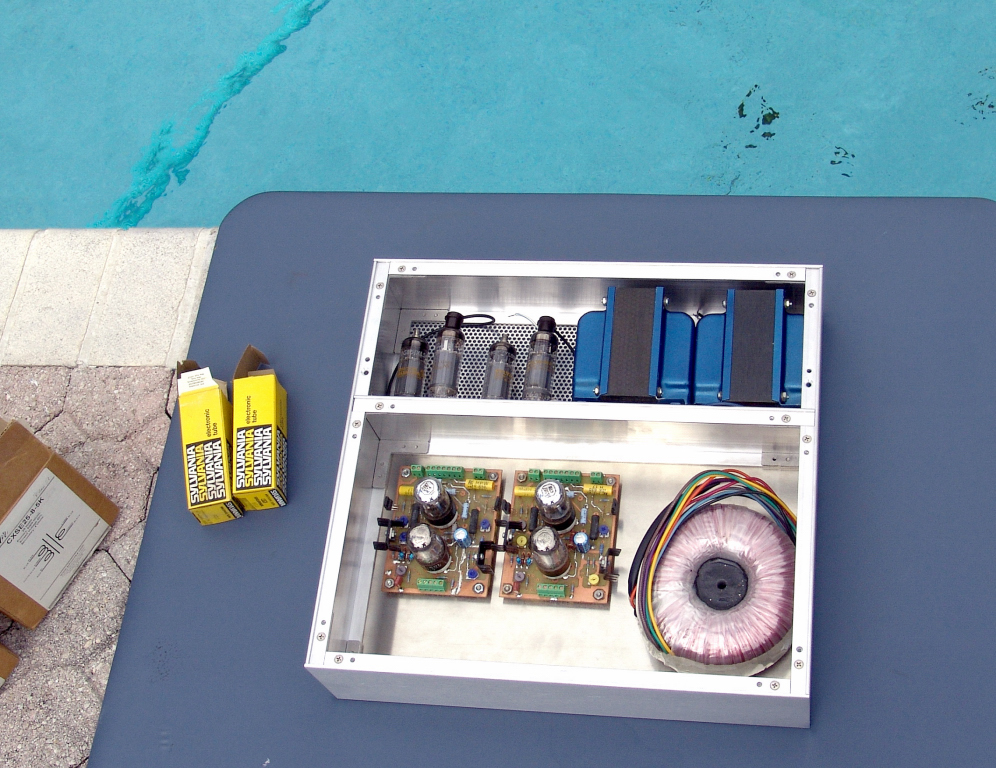

I have been building audio devices, solid state, tube, and chip amps, HiFi and MI (musical instrument) for 45+ years. I have built a lot of amps. After you make dozens of amps you run out of places to put them all. You can't stack them on top of each other. Why????? Because the tubes and transformers are "OUTSIDE OF THE BOX." So, I believe it is time to THINK INSIDE OF THE BOX.
I would like to make some amps that are rack mountable, or installable inside a wooden box to look like a 1950's Fisher receiver. After a few emails with Dave at Landfall, I have a box. I don't have the time to build it yet, and the Edcors are still weeks away, but I had to set some "stuff" inside the box and take a few pictures.
The compleded P-P amp will resemble this mock-up and make about 100 to 125 WPC. Once all the "right stuff" is here and assembly starts, I will create a new thread here in the "tubes" forum and it will be done on video and placed on Youtube.

The high level thinking started several weeks ago, followed by several exchanges of cad drawings between me and Dave at Landfall. There will be more "inside the box" designs to come including the SSE and TSE, and there just might be a "Split X/Y" box with two internal dividers.
I think there is a limit on just how big an amp you can put inside the box before the whole thing just melts down. So, I decided to start with a big one. In reality, the box size was determined by the use of the biggest Edcor OPT's they make. I will start at 100 WPC and dial it up or down based on temperature measurements.

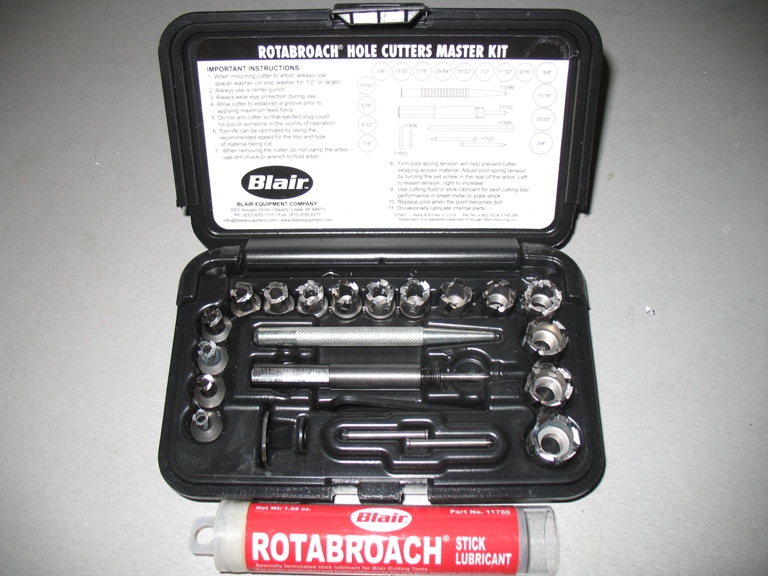

For tube hole I have had stellar results with the Blair Rotabroach's. I use these for my automotive projects but when doing larger hole for Tube sockets and such. These things cut clean, but you have to watch out when first starting them, the trick is to drill a 1/8" hole for the pilot. They also have individual bits in many sizes too.

I found the Rotabroach's by accident when looking for a specific size hole saw for a car project. These cut clean, and are not too much more then a hole saw kit.
Sandy
Those Rotabroaches look like a nice step above hole saws while not costing near as much as a chassis punch. Thanks for pointing them out!

I've found the set of Rotabroach cutters shown below to be real handy. Keep an eye out for deals. I got these on Amazon for 1/2 the retail price. It's a set of 16 ranging in size from 1/4" to 3/4". The lube stick is worth getting too.

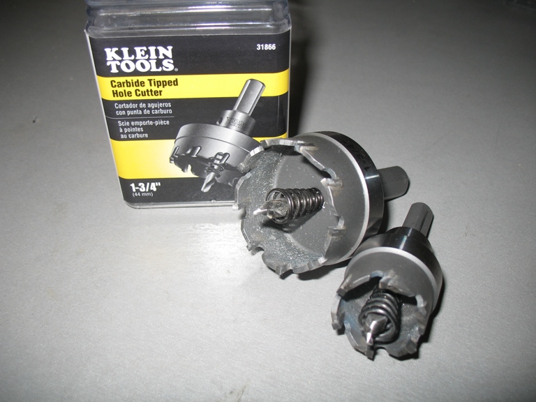

Carbide cutters are another great option. Blair makes these as do Klein, Ideal and several others. They generally range in price from about $15 to about $40 depending on size.
We've found cutters like these to work very well in the thick aluminum.

The Blair bits in the picture are more like augmented hole saws that really cut rather than tear and maim. Rotabroach has a line of this sort of cutter as well, no doubt cheaper than the actual Rotabroach bits. Ebay has the Blair cutters, though there may be cheaper places to find them.

The Carbide Hole saws are similar to a few manufacturers. I have never used them, but will be adding them to the tool box. The Rotabroach's are very good. I think they Rotabroach's also have many more individual sizes then the hole saw style.
I have a small and a larger Rotabroach kit that I picked up from Amazon too (Way cheeper then the Blair Site), they didn't have the masterkit at the time I purchased them, but it looks like is a good way to go to get a lot of bits.
