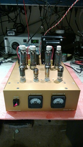

Hey Dave, I'm going to need an enclosure for my Midlife Crisis Monos:
http://www.diyaudio.com/forums/tubes-valves/232484-midlife-crisis-my-833c-amp-build.html
Once I get all the parts and lay them out to get an idea of dimensions we can talk. This thing will be BIG and HEAVY, I hope your chassis is stout!
Do you offer the option of going with a thicker than standard top plate?

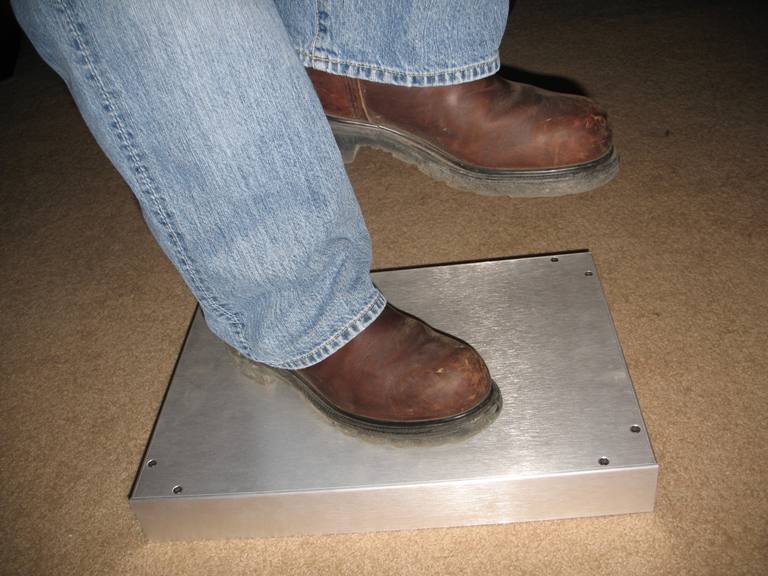

Bob,
You won't need it, but we can supply just about anything you want for the top plate. The down side to a thicker plate is that it will stick up above the sides. Though we could probably mill a recess if you MUST have it.
We've updated the picture of the 17 x 12 on our site. It now has Saer standing on it. He's the heavy one at 170 😱. We have a 6 x 10 that we call "the brick." We plan to park his truck on it and see what happens. Just haven't got around to that yet.

To further answer your question, and since I opened my big mouth, we performed a bit of an experiment. This is a little 6 x 10 enclosure and Saer's Raptor. Video and images...
Lanfall Systems, Simple Single weight test, Part 2 - YouTube
The last 2 pictures are the 2 sides of the box after the experiment.
Yup, looks stout to me!
