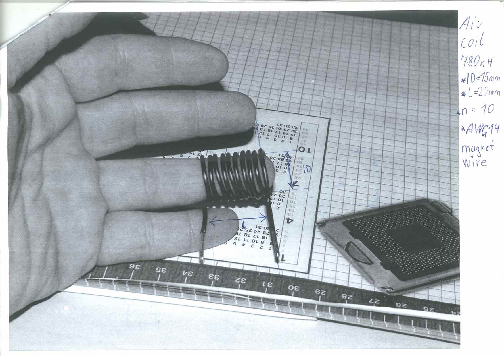

@darkfenriz: my circuit does have frequency drop! Heavy feedback and hi loop gain (=very small ripple voltage at comparator input) can linearize the output even if your conditions are not perfectly met. The only thing to "admit" in my circuit is that the output gets slightly distorted just below but very close to clipping level.
variations with series LC traps seem to generally not work according to my investigations - thats why I invented the above circuit..
I have only just had a look at this idea in detail. It would seem to work well into resistive loads, but I think that the self-oscillation frequency will drop quickly if the load has much shunt capacitance. (Because of the excess phase shift caused by the load capacitance and your second output inductor). Have you checked how well it works with (say) 100nF across the output load resistor?
I did exactly this kind of investigations: Try to find a good solution for most / all load impedance / phase shift variation. Result: Capacitive load will decrease switching frequency, true, but only if the load has significant capacitive phase shift in the 6 digit frequency area. Can you think of any reasonable speaker / passive X-over combination that has significant capacitive load characteristic at these frequencies? Even a bunch of ultra-cheap piezo tweeters (not really recommended ;-) wouldn' t reach that kind of capacity. My assumption is, that reasonable loads are either inductive or high - ohmic / inductive / resistive above 250 kHz. Remember: phase shift / capacitive impedance at audio frequencies does not matter at all.......
So to answer the question from Ouboros in detail after checking:
with a resistive 4 Ohm base load, adding a 100nF cap as a shunt capacitance will reduce the frequency from ~415kHz to ~364kHz,
with a resistive 8 Ohm base load, adding a 100nF cap as a shunt capacitance will reduce the frequency from ~400kHz to ~360kHz
