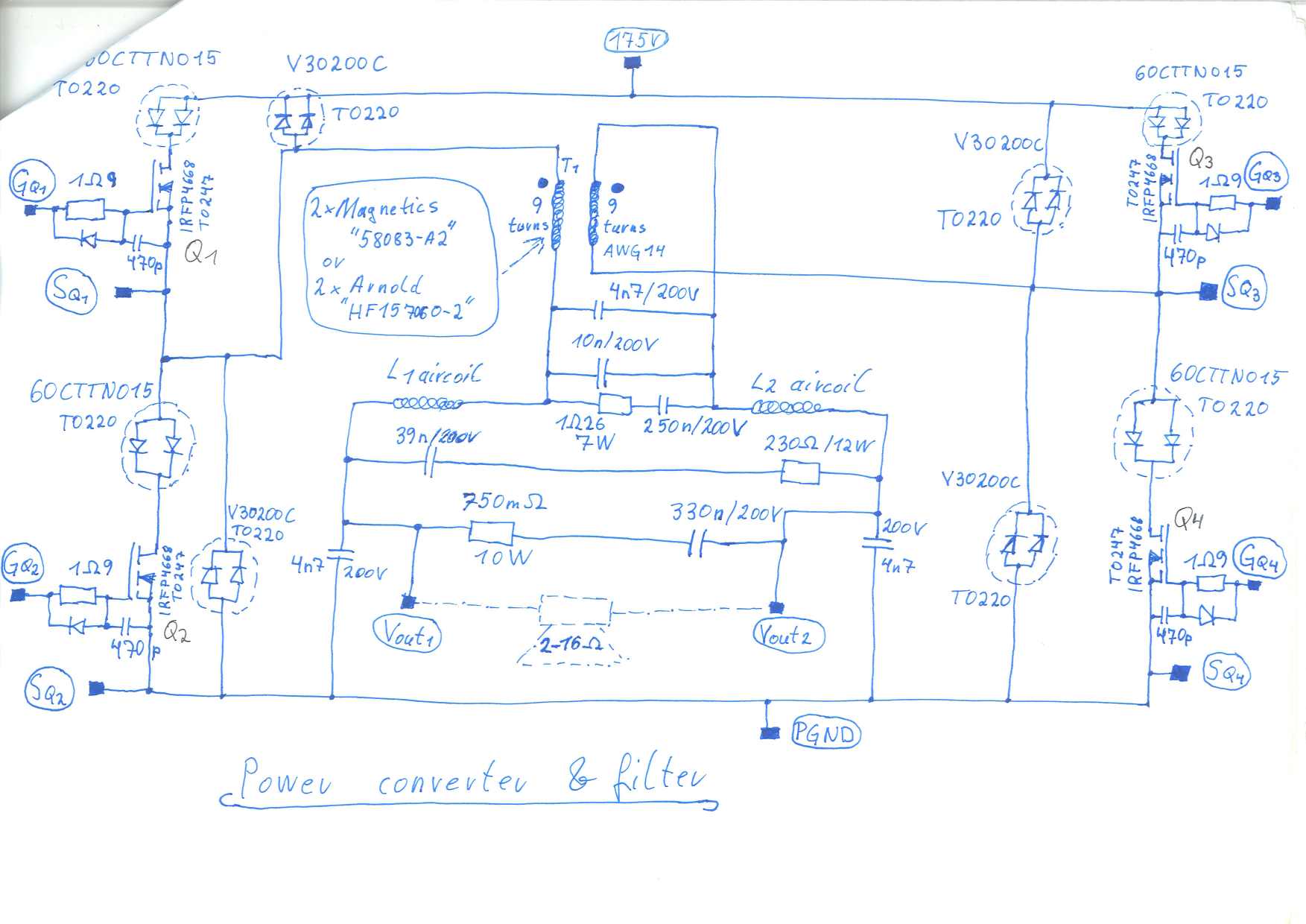

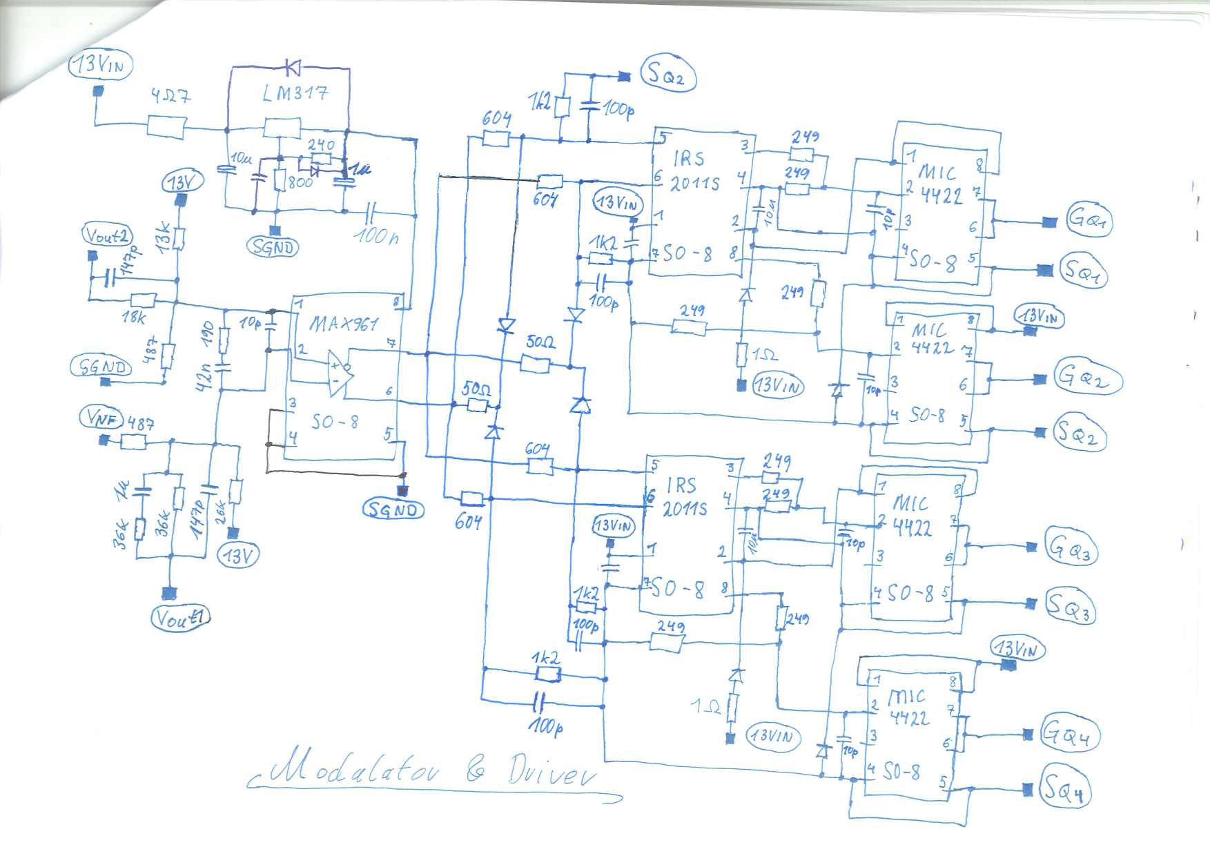

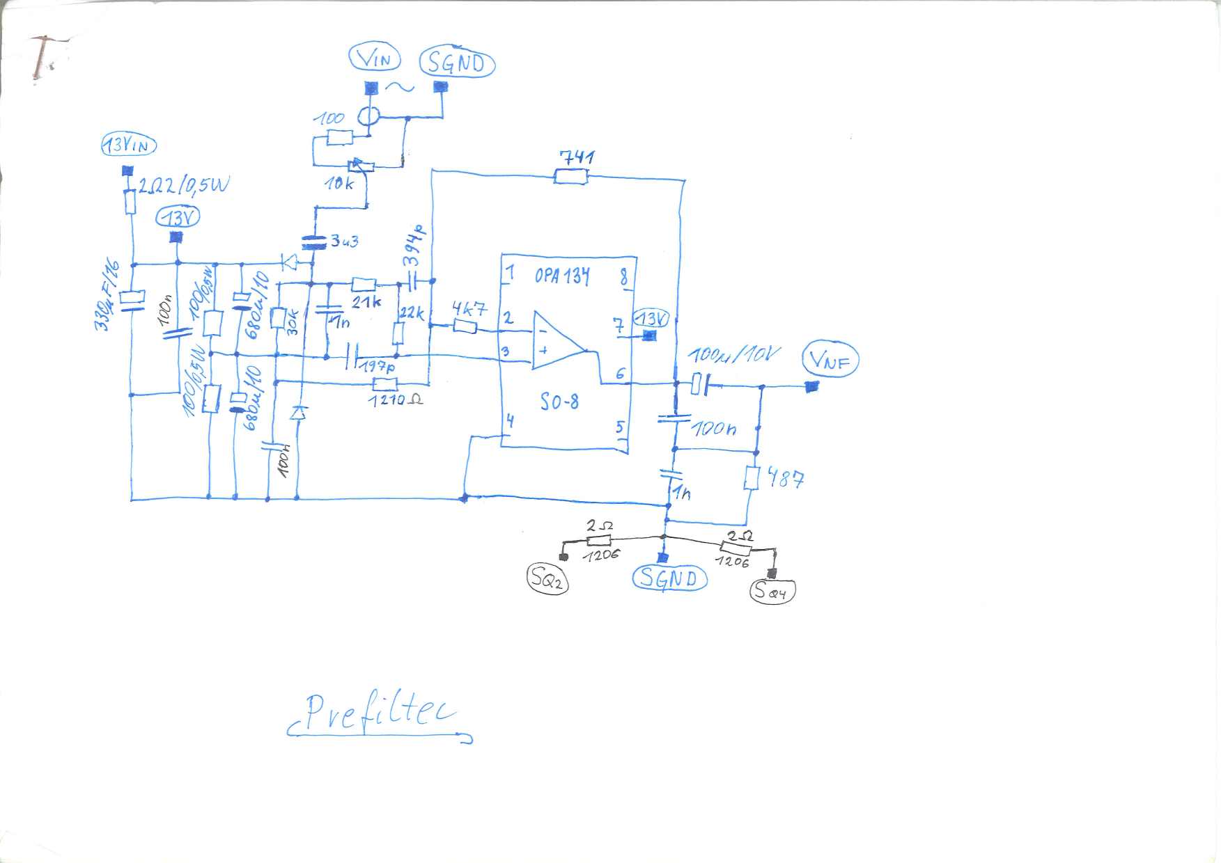

So hello again, some months have passed and I am now putting together the final schematic with layout planned for autumn. Main Comparator will be MAX 961 (need 2 opposite outputs with perfect delay matching for full bridge, need ultra-high speed even at low overdrive), Input prefilter will be 2nd order bandpass 10 Hz - 25khz (OPA134).
As a main choke I want to use Magnetics "58083-A2" or Arnold "HF1570060-2", 2 cores stacked for one full bridge channel, total 18 turns. This gives 52uH (or 2 x 13uH) My goal is to meet or beat LAB fP6400 under all power conditions, so I need to provide 3.2 kW burst sine waves, 8ms, 1kHz at 2 Ohms load (EIAJ burst power test at 2 Ohms is definitely the worst case for the magnetic calculation). This condition needs rms output current of 40A (-> e.g. coil peak current ~60A). So on ~140 oersteads, H-Flux 60 u core will still have ~50% permeability left. And thats by far the worst case design point. Any better idea / opinion?
Which mosfets do you plan to use? Driver? 🙄
IRFP4668, series schottky 20V 60A and antiparallel V30200C
Level-shifter: IRS2011, actual driver: MIC4421 (high side driver floating), very low-ohmic gating circuitry required to ***-kick IRFP4668 - this one is quite sluggish...

If the above analysis is OK, then how about the extra delay through comparator, possible level shifter, driver and switching tage itself?
The realistic 200ns propagation delay at this power already provides around 8 deg.@100kHz phase shift. What is the filter phase shift at 100kHz for this modulator (no load condition)?
Am I right that the output filter keeps close to 180 degrees between 30kHz to 250kHz?
Also, have you estimated the dissipation around the 1.26resistor at 20kHz full power? this can be hot.
Best Regards,
Adam
hello darkfenriz!
1. right 2 cascade + slight damping
2. total phase shift will be 180° at the intended switching frequency that is ~400kHz
3. wrong, the feedback will provide phase boost 90° through the capacitor
yeah output filter keeps close to 180 between 30 and 250k, but total phase margin is provided by phase boosting feedback cap. (remember: there is no RC in the feedback like UCD, but only C)
1.26 Ohm resistor is a 7W+ type in my intended design, getting negligible average power under typical signals <20kHz. Sharp steep transients can result in high peak power up to >40W, but I will put a 15kHz low pass in front of the amp, such signals are not typical and the average power (thermal power) will still be ok....
Hi Tom
I appreciate the design, however could you please help me understand some details about the modulator working:
1. The output filter is basically a 2 cascade LC filters, the first is resonating around 30kHz and slightly snubbered, so that it creates just-below 180degrees phase shift.
2. the second LC section provides another steep phase shift at much higher frequencies, so that the phase crosses 180 degrees at the intended switching frequency (250kHz or so).
3. The feedback network does not provide any phase shift, just stay far enough from UCD patent.
Best Regards,
Adam
