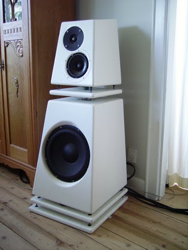

Yes I have... 😀
I have listen many hours to the old revelators:
D2905_9900
15W_8530k00
(See attachment for my current box with these drivers)
