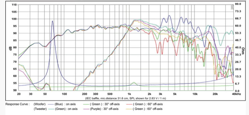

This does indeed look fun. Crossover looks like it might be tricky with a lot of dips and peaks in the breakup region to deal with.

The Lavoce includes a XO? The graph only shows the woofer/tweeter combination, not the individual curves.

That looks like a handful for a crossover design. Setting aside the peak and dip, the tweeter's Fs is right around where you'd expect to cross the woofer.
I actually tried out the combination of the SB26STCN, which is the closest to that tweeter in size with the MW19 woofer and it was not a pleasant experience. I wouldn't do that again.

You'd want to cross this at about 2kHz and steep. Hopefully the loading the woofer cone adds to the tweeter will allow it to work that low or maybe a tad lower.
The tweeter isn't sensitive at all, which leads me to believe it's been optimised so that it can actually work better lower down, which it needs to do.
Woofer at first seems more sensitive but if you were to build a two way, with ample BSC the tweeter and woofer match fairly well.
The woofer is likely to have excellent midrange distortion as per it's satori brothers. We'll have to see how the tweeter does.
Crossing low at say 1kHz will shape that 1.5k overshoot peak nicely. I think that peak is the result of the “waveguide loading” on the tweeter. But a dome tweeter crossed at 1k sounds terrible. It’s being made to move way too much.
