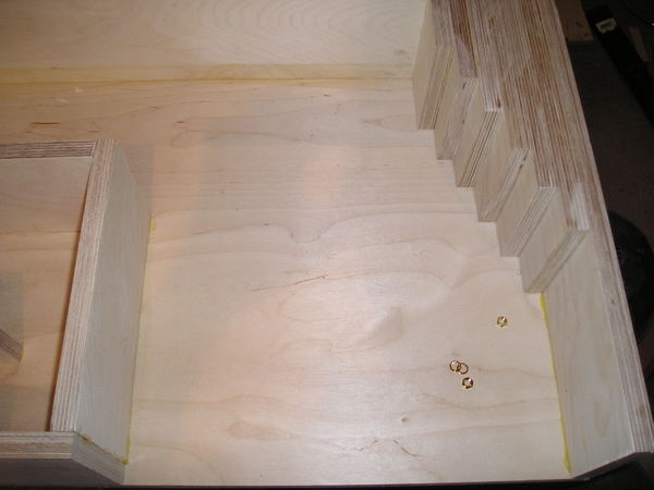

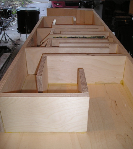

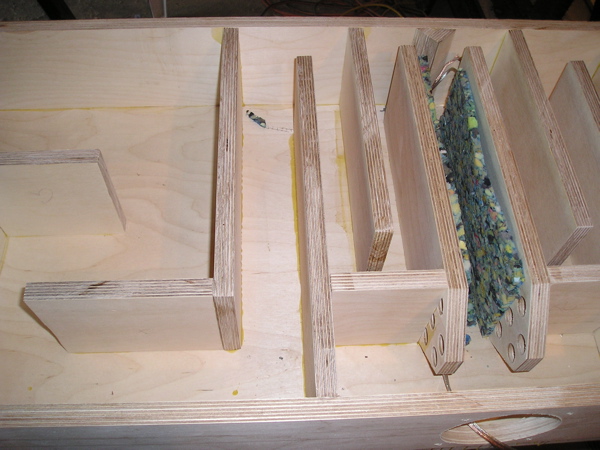

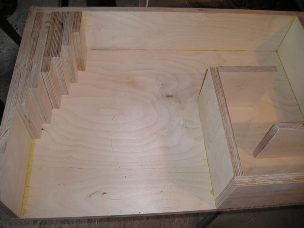

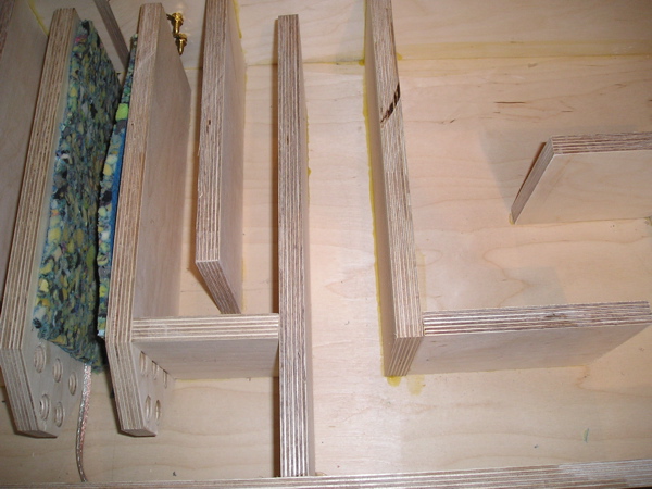

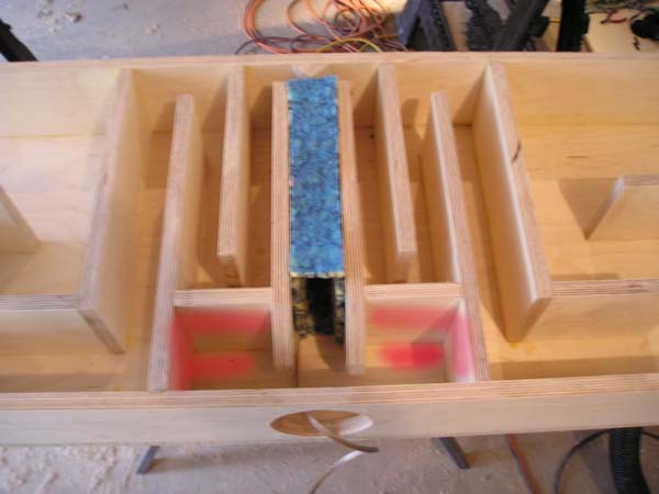

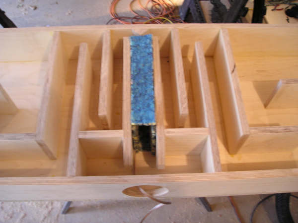

Alright fellows, Here are some pictures like I been promising.
I have to say, could there be a more satisfying woodworking micro skill as using a decent quality plane with adequate technique?
Less than 45 minutes with a plane, and everything is flat. Some of the internal bits are a bit short, but we're talking less than 1 mm.
Sides'll go on tomorrow, boys.
Well, one tomorrow after work, one Saturday morning.
Sanding and varathane on Sunday.
I'm excited!
Dave of Bass, you out there m8? You know what I'm feelin'!

Don and others will make their own suggestions, but my own choice for top coat would generally be a sprayed nitrocellulose lacquer (to each his own - I'm just not a fan of the look of , or maintenance required for oil & wax finish). Of course I have access to a small commercial spray booth and the right equipment.
While there are several OTC lacquers available in spray bomb form (my own personal favorite is the Mohawk M102-0412 Satin Pre-Cat clear), that work very well on small projects, the time & cost to finish a pair of Saburos with those would be silly. ( you could probably get finished by a commercial shop for less)
No doubt you'll get lots of other advice as well, but the only thing I would suggest you avoid would be any of the "one step" stain and varnish products, particularly on a project of this size.
If this was a piece of furniture likely to get a lot of traffic / wear ( dining /coffee / side table or dresser, etc) a more rugged finish like conversion varnish, etc., might make sense - but the most abuse a 72" tall speaker box should see is during the install/set up, which is generally when you'll treat with kid gloves 🙂 (n'est-ca pas?)
