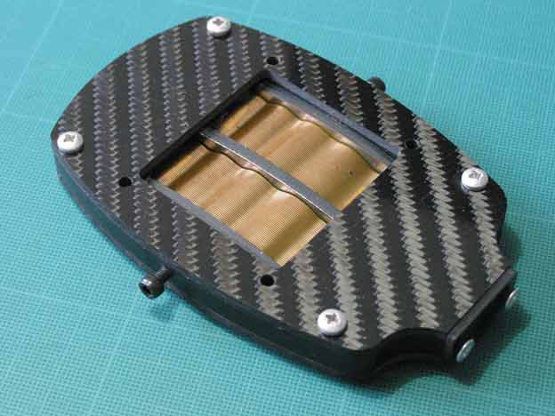

My own limited ribbon transducer experience is designing a transducer for headphone use.
As for theirs being the first ribbon headphones ,I believe someone designed a pair in the 1930s and I had my first pair up and running in 2001.

Patent looks like Series Xover for Ribbons
The patent by TransmissionAudio that SY referenced appears to be an attempt to patent a series crossover for ribbons that is in common use for dynamic speakers.
Ribbons have a very low impedance, often < 1 ohm, and a step-up transformer is typically used to create a higher impedance between 4-8 ohms that most amplifiers can drive. This transformer inserts phase, step response, and frequency limitations. A good transformer is expensive.
By putting the midrange and tweeter ribbons in series, along with series passive components for crossover and equalization, one can create a higher impedance, more amplifier friendly load. This removes the cost and performance limitations of transformers, and allows one amplifier to drive multiple ribbons with greater fidelity and lower cost.
For long, wide bandwidth ribbons, I have found that a low impedance direct drive amplifier is required to mechanically control the ribbon's movement in the magnetic field. I have built Class-A amplifiers that sound very good driving a 0.5 - 1 ohm resistive load, which thanks to low 7V output power supplies, are modest in cost, heat and size.
Nelson Pass as part of his First Watt efforts has published a few articles on current source amplifiers and series crossovers that cover the same ideas as in this patent. Nelson has also discussed using a current source amp to drive (tweeter?) ribbons.
