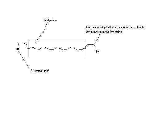

Was just wondering...
They comment on time consuming nature of that linear drive thingy... how about this... Notice big loops at end, that does not (almost) sit in Magnetic field... they might move only on command of middle section of ribbon... you would have to tweak severely to get thickness and flexibility of end bits to make sure you get no sag, no reflection... and still excursion...
Has anybody tried this... Don't know if you can temper anneal or in anyway heat treat aluminium though... 😕
Would conventiallish vc be able to move as fast as ribbon?
Dunno

It would seem to be quite a task to get a ribbon to move in an
entirely 'pistonic' fashion.
The moment one tethers the ends it will bow too and fro to some degree.
I suppose if the ribbon behaved as if it was effectively stiffer in the middle one could counteract the effect.
I guess how much this actually matters depends on how much excursion one requires.

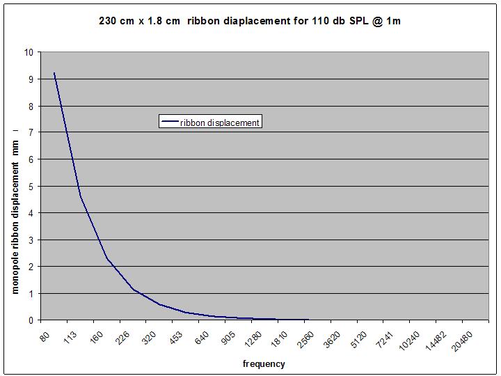

How much ribbon displacement do we need for home audio?
Prolonged exposure to > 85 db SPL can cause hearing loss. 94 db at 1m = 85 db at 8m, which is a good size room. A 110 db @ 1m design would seem to have enough margin. For a long ribbon, a displacement of +/- 0.1" should be capable of 200 - 20,000 Hz at 110 db
What about Doppler type modulation distortion at 1" excursion for a wide bandwidth ribbon?
