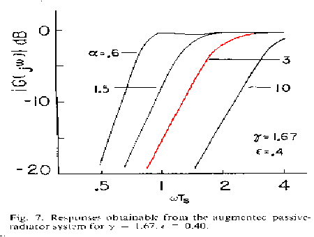

Here is the enclosure I was talking about. It is designed to, among other things, enable a speaker to experience considerable augmentation from the enclosure-thereby cutting down on cone excursion by 3/4 at the cutoff frequency-but also to roll off around 12 dB/octave, just like a sealed design.
I saw it in a 2 part article in the Journal of The Audio Engineering Society, by Thomas L. Clarke.
It is the Augmented Passive Radiator, and I haven't built one yet, but think maybe you might want to try. There are many different alignments.
First here is an illustration. It seems to me the 2-part passive radiator that is at the heart of this could just be two flat syrofoam pieces with two homemade surrounds. Saves money and enclosure space. But if you cusomarily collect speakers from vintage radio, you probably have cones on hand that you can use.
Anyway, the picture:
Before I explain the importance of the size relation of the two PR's that are attached to each other, I just thought I would post one of the curves suitable for your project. Remember, Greek "a" = (Vas/Vb (total enclosure). This would involve "a" = 3, that is, the volume of the entire box would be equal to one third of the speaker's Vas.
From what I can see, the response appears to be 2 dB down at 2 Fb, and 15 dB down at Fb. This is just going by sight. I think that is 13 dB/octave rolloff, though it might be considered 18. Don't know-but it sure is less than the traditional 24 dB/octave rolloff of the normal reflex.
Anyway, I highlighted the appropriate curve in red.
Articles I have read have said that transient response, overhang, etc., are all related to rollof rate. From this, I can gather that speakers with similar rolloff rates will have similar results in the other characteristics. So therefore, this enclosure type should yield the benefits of very muc lessened cone excursion with advantages of a gradual cutoff slope.

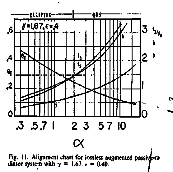

Anyway, here is a chart for this type of Augmented Passive Radiator alignment. It seems for your purposes, it seems to require a speaker with a Qts of .21, (I think we can settle for anything in the low .20s), and an Fs of 40 or so. this will give an F3 of 70 Hz or so.
Happily, there are at least three drivers that I quickly found that meet the requirements. I have not checked the response curve for the full range use-just throwing them out there for now. They are all 5 inchers-not too much bigger than the 4 inchers you were looking for.
VersaTronics EOB 130R FGC18, and EOB 130R WCC. Both are available at Speaker City, which ships internationally.
www.speakercity.com
http://www.speakercity.com/specs/versatron_ts.shtml
Also the Focal 5N412DBL, available many places.
I am sure there are others.
By the way, Greek "y" means the relationship of the outer passive radiator area-always the larger one-to the inner passive radiator area. So if a 12 inch cone of 86 sq in, facing out into the room, is connected to an 8 inch of 32 sp in connected to the interior chamber, you have "y" = 2.7.
Greek "e" means the relationship of the chamber in which the speaker is located to the entire enclosure. So if the speaker chamber takes up 3/4 of the entire enclosure volume, "e" would equal .75.
I wouldn't worry about the tuning ratio of the passive radiator. I would think you would just add wieght until you get the right response.
I have both parts of the article EXCEPT two pages inexplicably lost. I am thinking of sending away for that first article from the Journal Of The Audio Engineering Society. Will send what pages I have, if you are interested.
