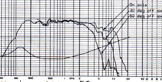

Did you say that you planned to cross over at 6K? This is a discontinued Vifa model, available at Parts Express for $25. I am not sure if this is the one that Tomcat mentioned earlier. Flat to 4K, natural rolloff right at the 6K area. You might want to let this roll off naturally in the crossover area, setting your crossover components for farther up the scale, thereby ameliorating the phase distortion that occurs with crossovers.
Parts Express number 299-243
Vifa P11 WG-008
http://www.partsexpress.com/pe/showdetl.cfm?st=0&st2=0&st3=0&DID=7&Product_ID=67940&DS_ID=3
Listed sensitivity is 86 dB@1W/1M. 8 ohm. Hook them up in parallel, and the sensitivity goes up 3 dB or 6 dB, depending on whether you are measuring 1 genuine watt or 2.83 volts.
Parts Express has them on a buyout, but some places in Australia might still have them in stock. Of course, if there is an Audax that is currently being made that offers similar performance, it is to your advantage to go in that direction, for replacement purposes.
Anyway, here is the response chart, complete with 30 deg and 60 deg off-axis response. The off-axis response probably applies as much to any 4 inch driver as it does to the Vifa.
The Vifa, while having adequate HF response characteristics would not seem to be able to meet surf's outlined LF requirements for a mid driver.
In a sealed box, a maximum output of well under 100db/1m, at 95 Hz...with very rapid overexcurcion occuring as soon as 90 Hz at 96db, even 2 of these per cabinet would provide inadequate output levels IMO.
Maybe if LF demands were not so stringet, this would work adequately crossed at around 120-130 Hz, or if surf wished to compromise this critical range by using a ported alignment, it could be crossed 100-110 Hz.
-Chris
