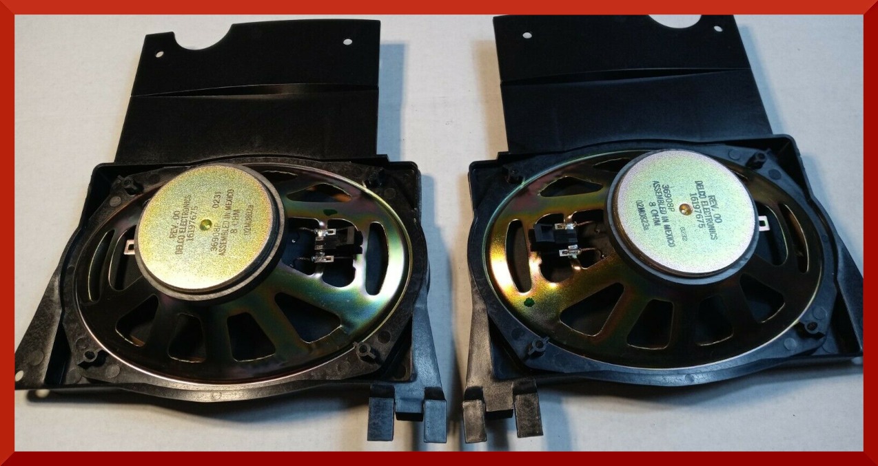

hey Dave
picked up a pair of ferrite Delco 6x9 for `$25 shipped
maybe for trying Karlson's AP9C
gotta deal with kidney cancer and bigly blood sugar first
