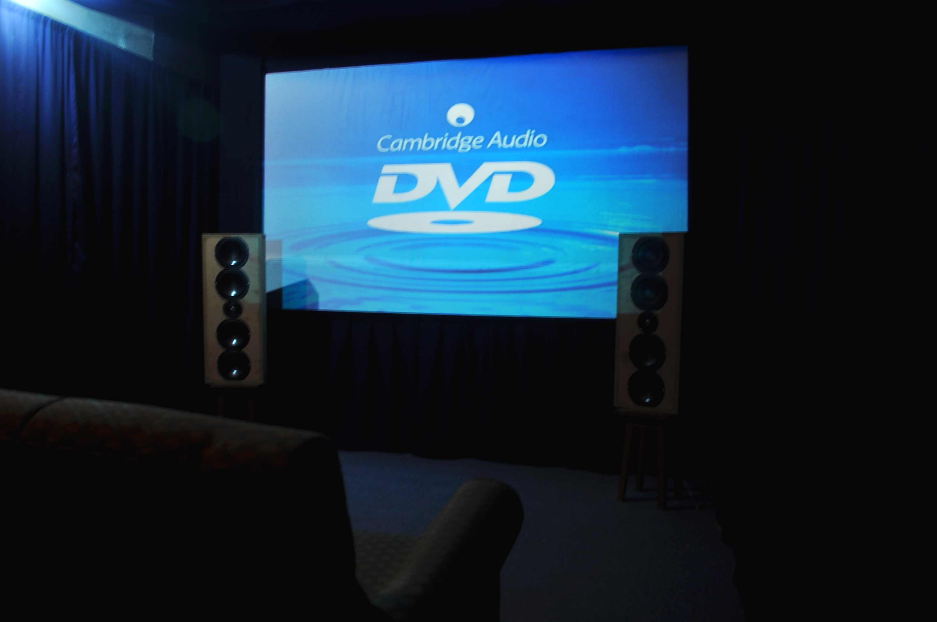

What do you mean by received ?
It has been received ,assembled and successfully running since couple pf months, I hope you missed my thread .
Cheers
wow jaydev......u r using cambridge floorstanders....I am jeolous of u man.hehe
