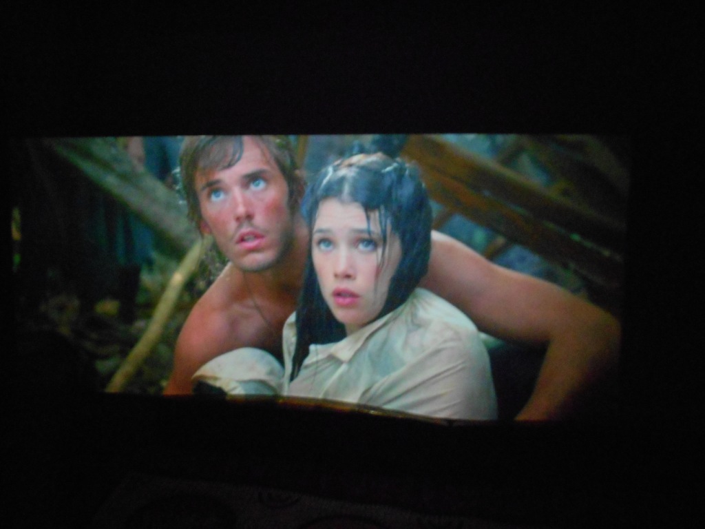

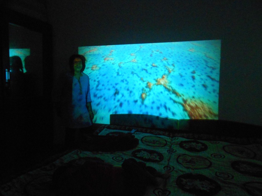

It was a long 3 month journey to produce this image in DIY projector.
Its 100% worth for our money.
image projected on a wall and is 6.5' wide and the wall is 10% violet 90% white colour.dont know to adjust camera ,but really best when seen in the wall.
In second image ,u can see my son standing on bed.

i projected image to a patty wall with 10% violet colour. camera may be the reason ,But in real it is clear and sharp (no need to remove anti glare and risk ur monitor.The images lacks sharpness. Is it due to the camera or you have to adjust / focus the lens properly ?

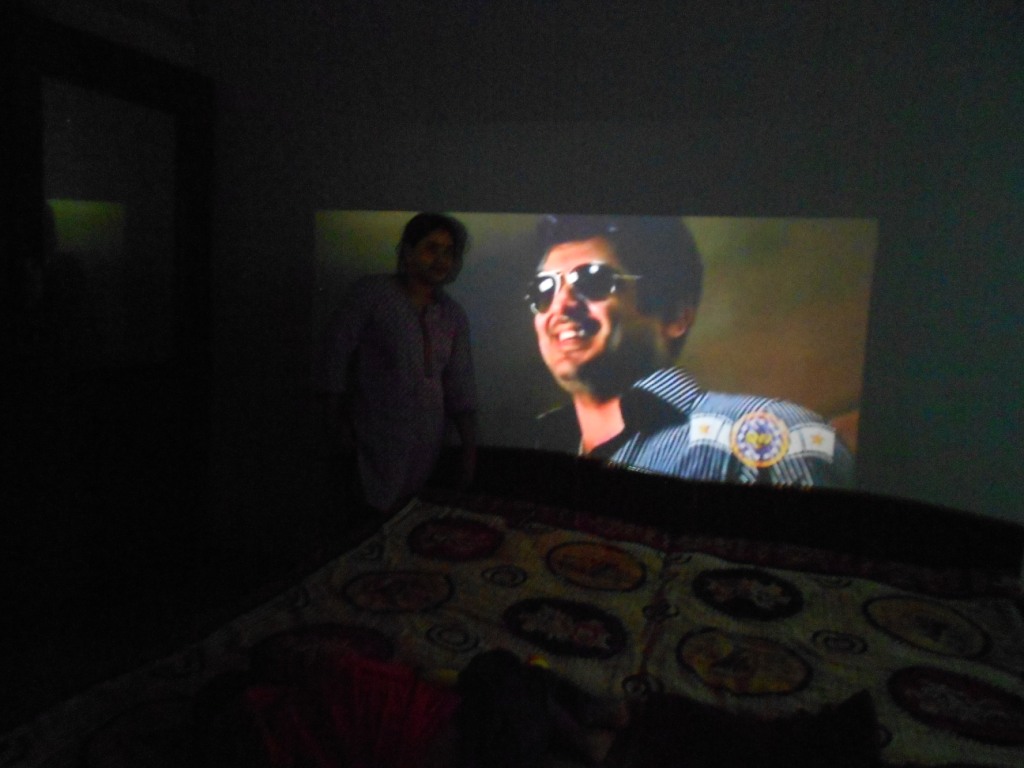

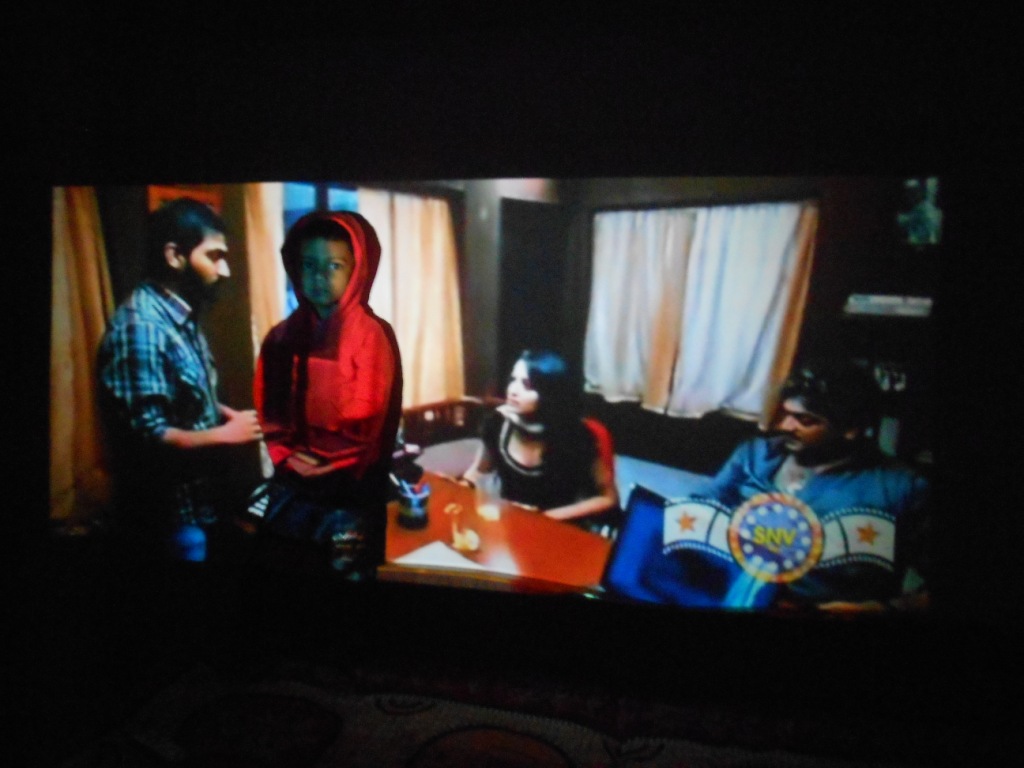

following pics 6 1/2' wide ,projected from 8'
following is 10' wide ,projected from 12'
In this last picture u can see blue wall towards left of the persons shoulder.
all pic's were projected on sky blue colour wall,only center 6' x 6' banner vinyl sheet with lots of fold marks.
persons using 15" monitor ,best to go for long throw triplet (pro lens 550mm fl ).u can get a bright,corner to corner clarity and projector will be backside of our seating.
