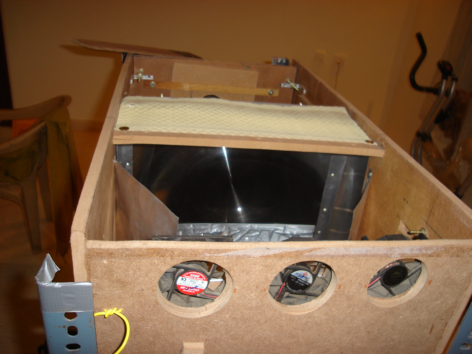

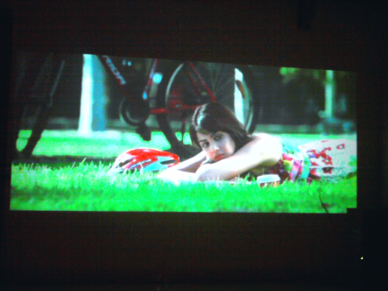

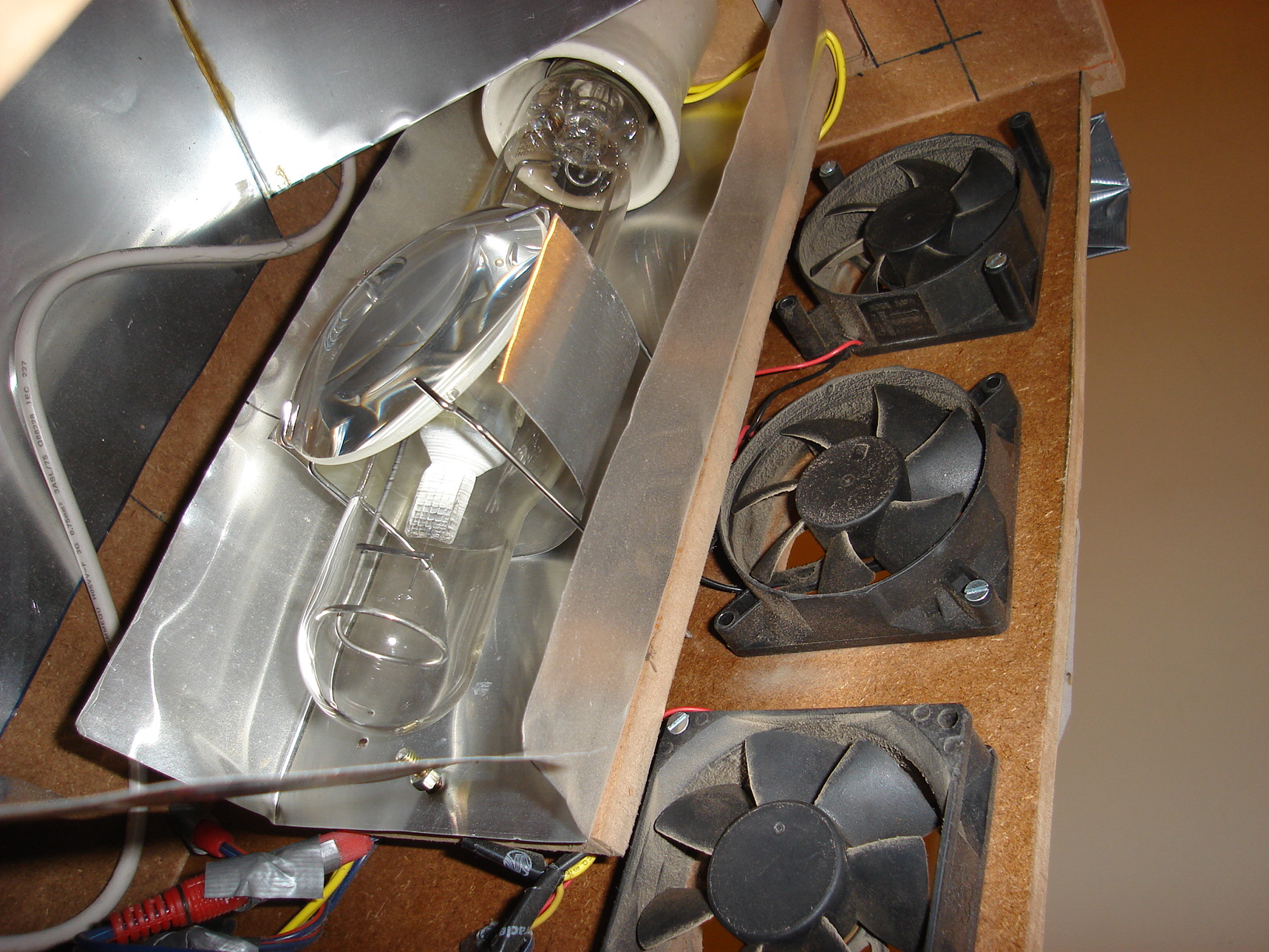

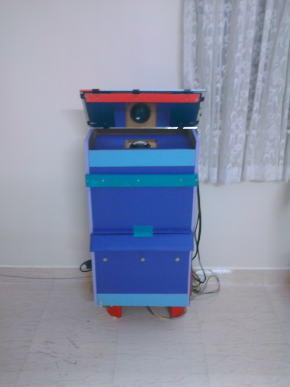

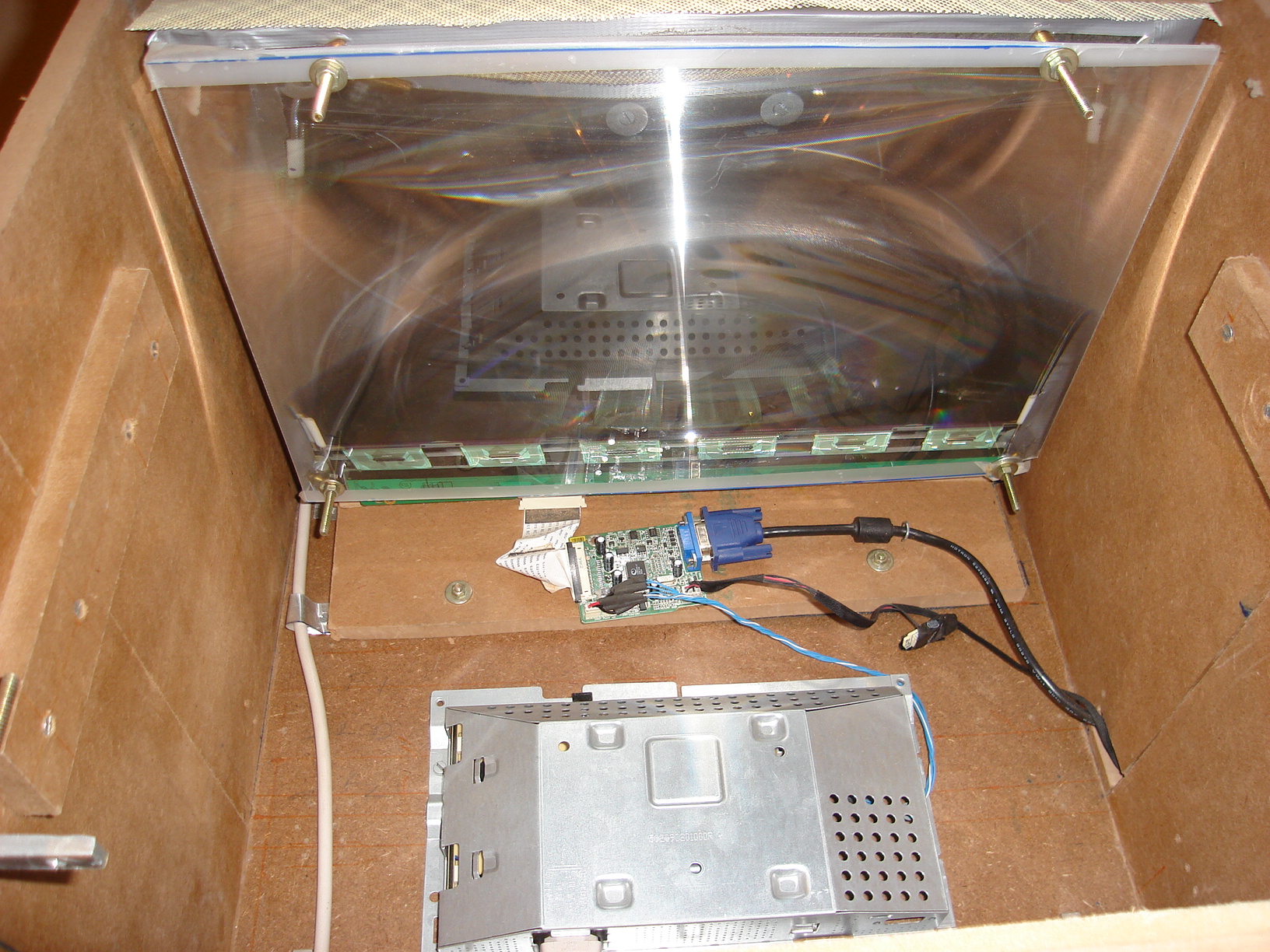

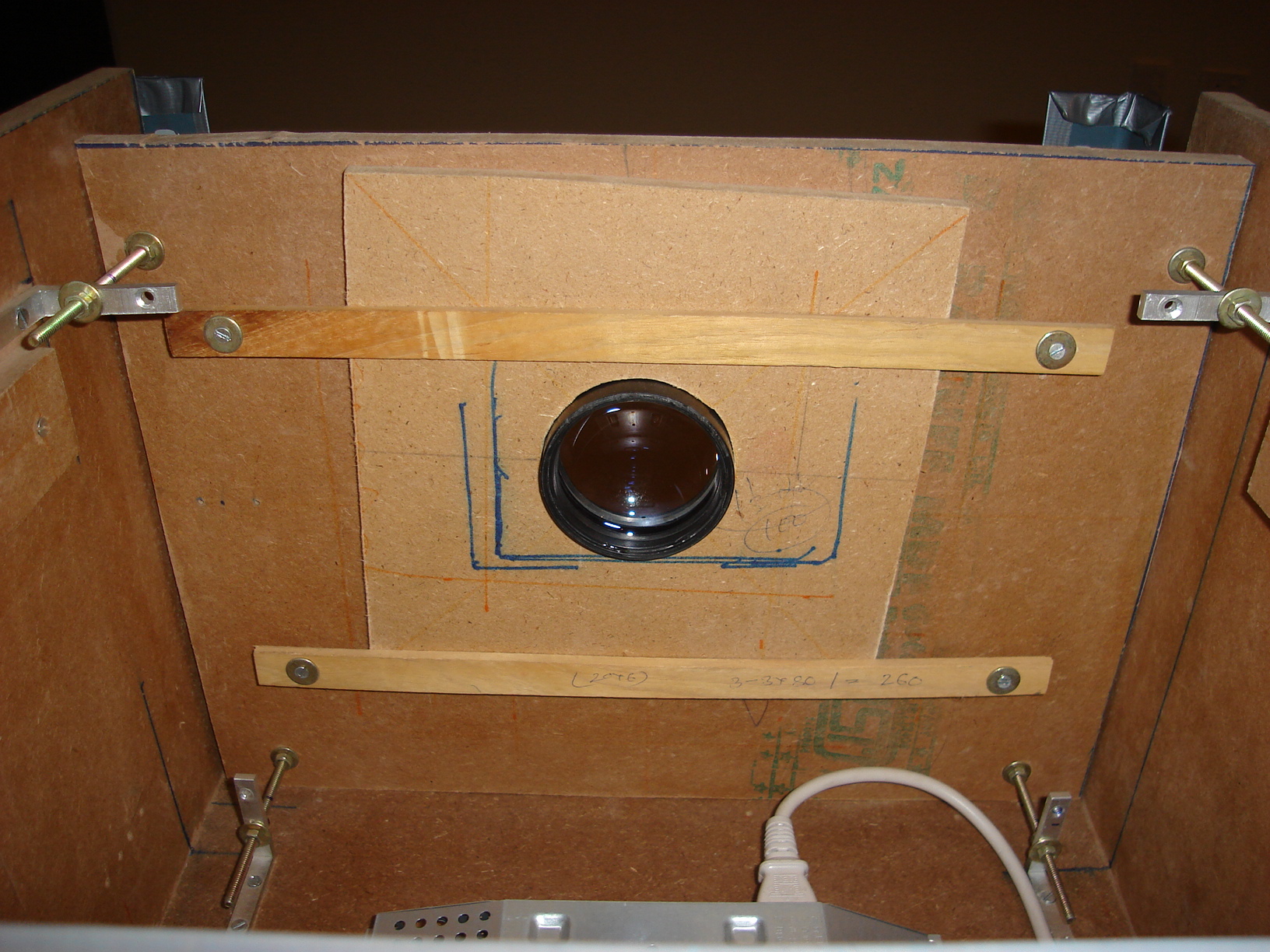

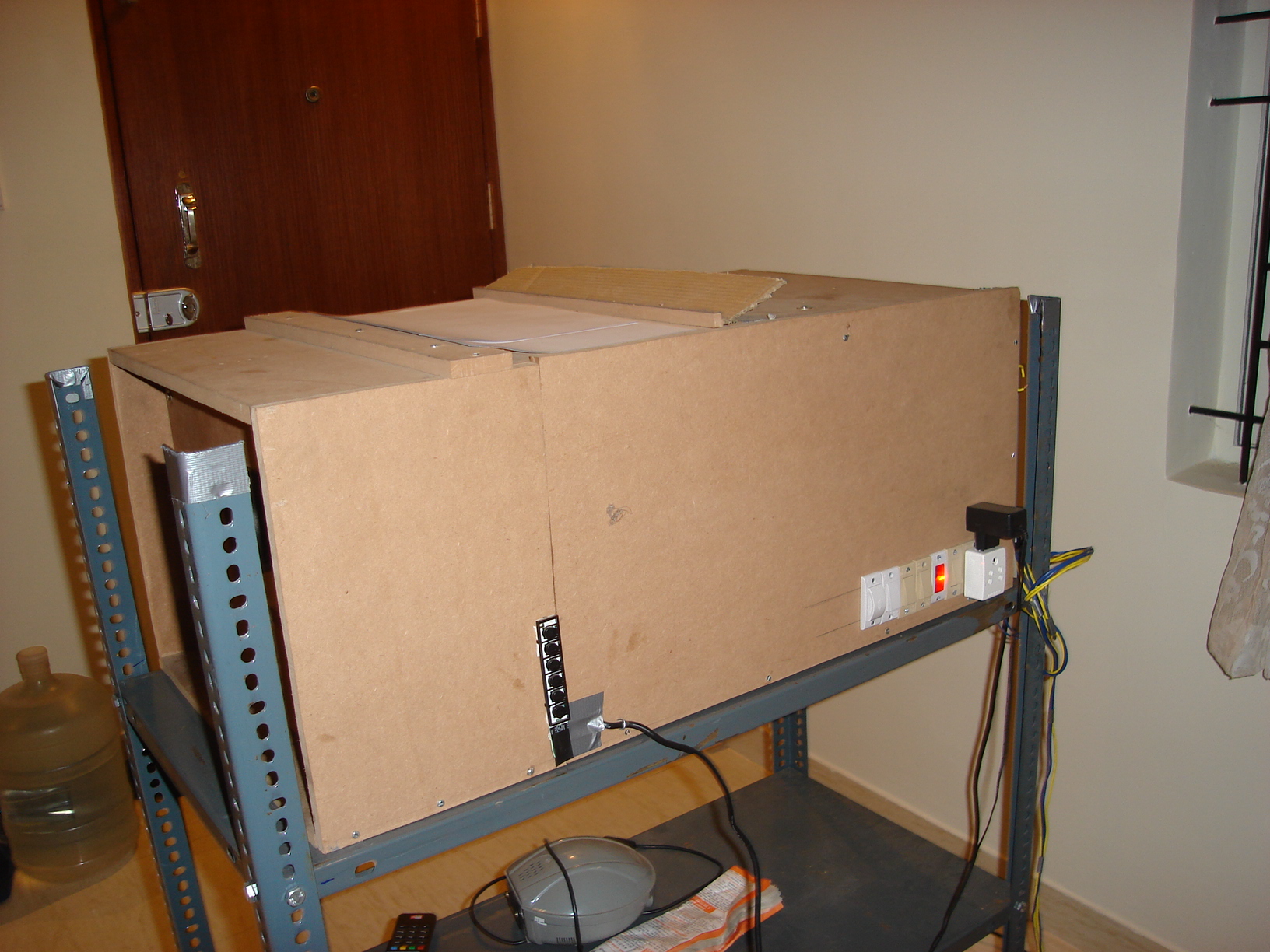

Hi Guys,
Its been a very long time i had visited this forum and now i see a lot of activity going on. Keep up the spirits of DIYers.
I had built the projector last year in Sept 2010 and since then i am regularly watching movies,HD movie songs (720p downloaded from you tube), Dish TV. I am very very happy with my projector and the crystal crisp clarity.
I used the following components:
1) Samsung 15 inch monitor NW633 ( Spoiled one during the built)
2) Fresnel lenses from 3dlens.com
3) Triplet & condensor lens from Welcome to the Optics Allied Engineering Pvt. Ltd.
4) MDF wood for box
5) 400 watts MH lamp OSRAM
6) 3 CPU fans for cooling
7) Aluminium Sheet as reflector
Hope, you will enjoy the pictures attached. The last 5 pictures are taken from mobile phone, the clarity is a bit hazy.

your photos looks like you have placed the condenser lens quite too close to the Bulb. Is it ok, and do we have some measurement for this, or it also has a Focal length. whats your spec of condenser lens. Also for reflector I used a commercial reflector (its like a sheet of mirror polished sheet, and cost is Rs.35) and the results are not good. Any new ideas on this ?
