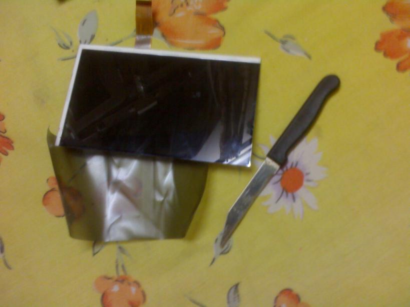

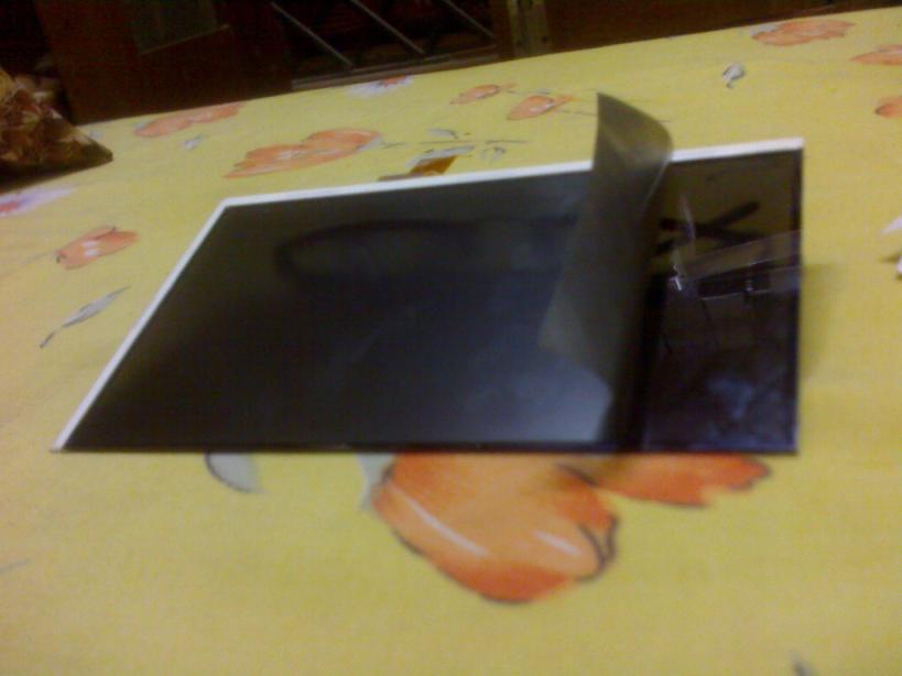

Screwed LCD
HI,
This weekend did not bring any luck to me, rather I screwed my LCD panel.
To enhance the brightness I tried to remove the anti-glare coating, and I think I removed something else. B'coz after removing that coating the LCD is completely transparent, and there is no image seen on it.
It was a sheet type of coating which I removed with a lot of care, with no results.
One good thing is that if I put that sheet back, I can see the image on it, but I am not able to glue it that well as it was before.
I am attaching the pics here. If anyone can help me, it will be really great.

Oh No!!!!!!!!!!!
OH NO!!!!
Dude I am afraid you pulled out the polariser film. With out it image from LCD will not be visible.
A WARNING FOR ALL
Some lcd's do not have an anti glare film to remove. The Anti Glare surface is kind of a MATT finish liquid which is sprayed on to the Polariser film.
I am afraid it may not be possible to restore your LCD back to the original form it will not stick back again properly.Try cello taping the edges. If you use any glue between the film and the LCD it will be visible in the projected image also.
Polariser film itself is availablefrom certain sources you may buy that and stick it on your LCD also.But could be a costly affair.
polarizer film available here
In my humble opinion it is not worth removing the Anti glare considering the risk involved and the gains are only marginal. I also feel if the Anti glare is present screen door effect is less visible.
Thanks,
Gitesh

badepapa said:HI,
Amit
You got it absolutely right buddy 🙂
I pulled off the polarizer film.
Can you suggest what glue can i apply to put it back.
I have nothing to lose on it now, so will give it a try and then I may go for a new one 🙁
Amit
Amit
Try the transparent fevifix but once cured difficult/ impossible to remove.You can try feviGum also but bond wont be that strong but if you screw up u can remove the adhesive easily.Make sure there are no air bubbles in the adhesive layer. Diluting fevi gum with water may help in reducing air bubbles.After applying adhesive and sticking film stick the edges with cello tape.
Wish you good luck..
Keep posted on the developments.
PIDILITE adhesive products
