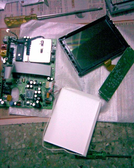

anyway, has anyone thought about the 3" LCD displays on many digital cameras ? they are quite cheap, are quite small.
2 problems.
resolution is little less.
i don't know how to attach video input cable ( female RCA) to this screen.
But you can get resolution uotp 640x 480 which i think is fair to watch movies at least. i am not a game loving person.

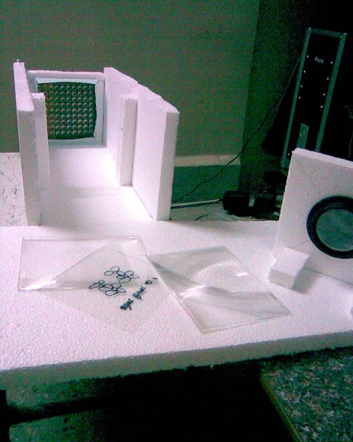

first projection

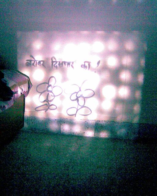

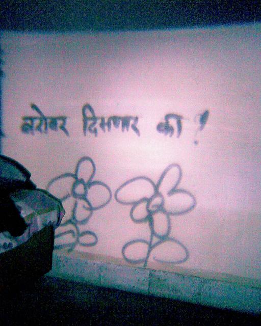

got my first projections today with an OHP slide. got 15x magnification at 7 feet screen distance.( the flower is originally 4 cm and the image is 60 cm)
had some problems with LEDs as it was showing a grid on wall. but could solve it with some adjustment of lense. still getting a hot spot in centre. the screen is yellowish ( my wall) and the pics are taken with my mibile camera (1.3 megapixel).

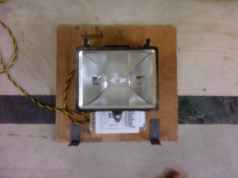

I don't know the focal length of the lens, so I tried to figure out approx focal length by the method you have suggested in one of your posts(projecting the TV image). Another issue could be my light source reflector as I can see the illuminated part of bulb getting projected in the center and the image of LCD is very dull and hazy. I am attaching the picture of my light source, can you suggest me any improvements to it.

The light source should be at a distance equal to the focal length of the rear fresnel.If you are using LED light don't use Fresnel.
Th distance between the triplet and the front Fresnel should be roughly equal to the focal length of that Fresnel.
Reflector for the bulb is only to increase the brightness,Projector should work with out it.

another odd thing. just see the distances i have to use to get best image( 20x at 10 feet)
LED panel to Fres 1 (343mm FL): 28 cm
fres1 to LCD: kept in touch with each other
fres1 to fres 2 (216mm FL): 12 cm
fres2 to triplet: have to keep in touch with each other to get best image :bigeyes:
you might think that i am doing something wrong. but i think you will accept it if you see the images. another thing is that i am using LEDs. i don't know whether that is making the difference.

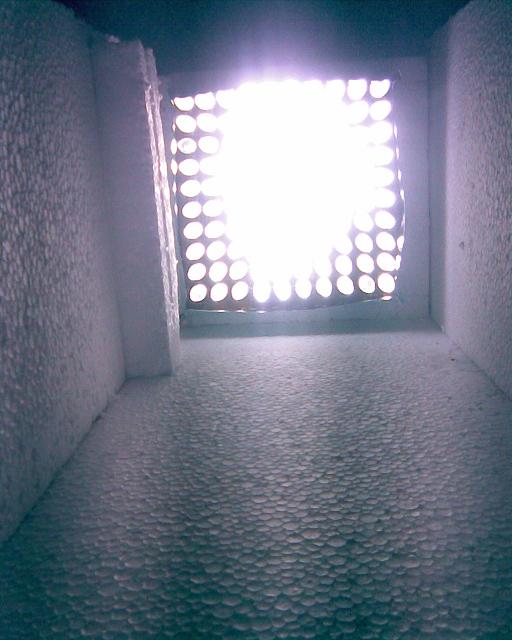

hot spot
getting a hot spot in the centre. i hope that problem is solved after adding some reflector paper in the box.
this hot spot is not giving a problem while actual viewing , in fact didn't even notice it. but it is clear in the snaps.
here is my stripped LCD. will try to project it soon.
