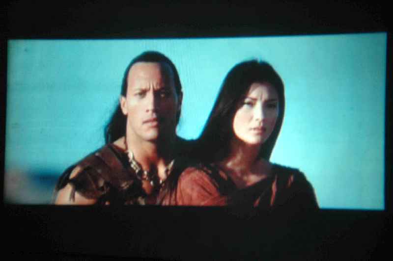

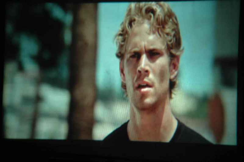

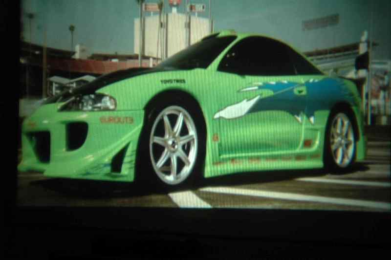

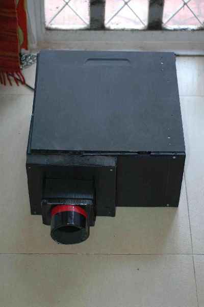

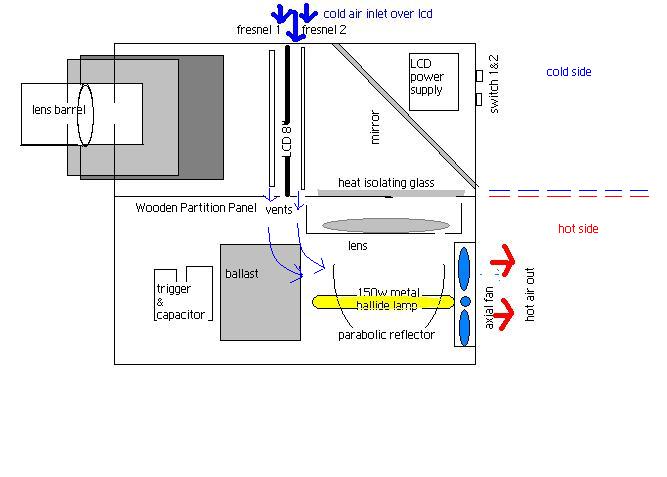

Hi every body I have finally managed to finish the projector and fine tune it to a decent image.
The specs are 8" lcd from Car Roof mount screen
150W metal hallide Lamp
parabolic reflector
glass sheet to stop heat.
condenser lens
2 Fresnel Lenses polycarbonate
rear one is a page magnifier!
Front one is 3mm thick fineline type.
270 mm lens from OHP(singlet).
FFc Cable 6" extentio from lumenlab(they actually shipped it in4 days to India! wow!!
case from a dead PC

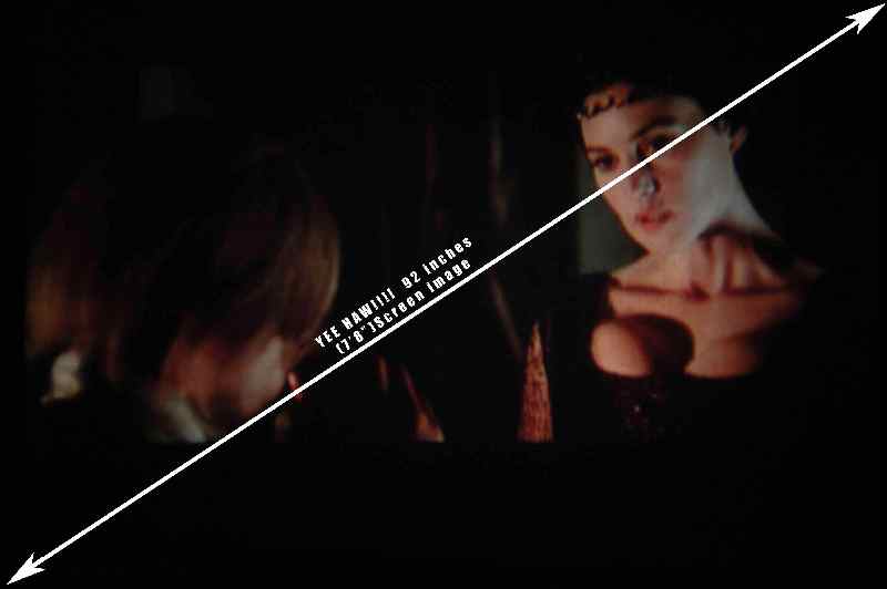

I get a nice image of 92"diagonal on my homemade screen(streched white nylon overwooden frame)with a black cloth backing to prevent backspill from the wall.

Hi Makarand,
Thanks buddy for all your appreciation.
now i just keep waiting for it to get dark so that I can fire up this beast!
I will give it to you step by step.
8" Car LCD roofmount (chinese Import) Rs 3,500/-
Metal Hallide lamp and fitting,ballast etc Rs 2,000/-
4" 220V axial fan Rs 400/-
Simple OHP lens (single Lens) Rs 150/-
2 fresnel sheets (out of my junk!) approx Rs 300/-
FFC cable imported from Lumenlab Rs 650/-
Glass,mirror, switches matt black paint etc Rs 500/-
Computer cabinet donated by my friend Rs Free!
Total Rs 7,500/-
Instead of looking around for second hand LCD panels and parts, do a little bit of searching you can get New screens the kinds that are used in Headrests of cars and Roofmount models at Car Accessory shops.
Hunt Buddy hunt!!! It saves you Money in the end!
I joined this forum about a year back(Really Thank every one on this board for every little bit of information shared selflessly) and finally got everything together

I know what you mean... I went from shop to shop carrying the caracass of my Lcd screen to almost all shops in Nehru place for the FFC cable most refused outright others gave false hopes and finally said No.even RS product catalog/molex enterprise the guys who market these internationally are ready to ship large quantity only Lumenlab is the best bet.
The obvious cable to extend is with the lesser terminals more connectors more problems and more chances of getting dead pixels.
Come on man! Metal Hallide Lams are everywhere ,all cloth showrooms jewellery showrooms use them in ceilings and as spotlights in display windows any where they want colorcorrected light(5000K-6000K) they use metal hallides, the most common ones are GE and Osram Just go to the big light wholesale shops and ask for it over the counter.!!!
The Metal Hallide produces the least heat for the light it gives compared to halogens.You have to provide cooling, I fixed an axial fan in the case, just next to the bulb so all air is immediately drawn out. The inlet for cool air is near the Lcd so it pulls in cool air from the room.
I watched all the Matrix movies , Back to back , on this!
and its summer here in Delhi, read 30' C,and no problems with cooling.!!!
