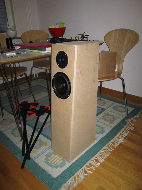

Testbox almost ready.
Here is a picture of the testbox I will use to hopefully find a good way to realize this speaker. I will next mount screws on the baffle to hold it with a rubber seal.

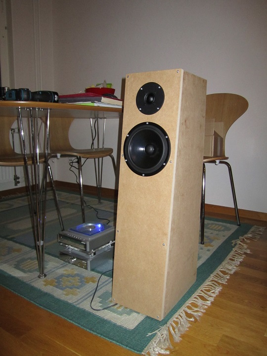

Front fixed with screws and box stuffed. It plays rather ok even without the tweeter and rather sensitive (90dB) but bass is out of proportions (too much mid range) as it should be without a crossover. I think it looks nice 🙂.
